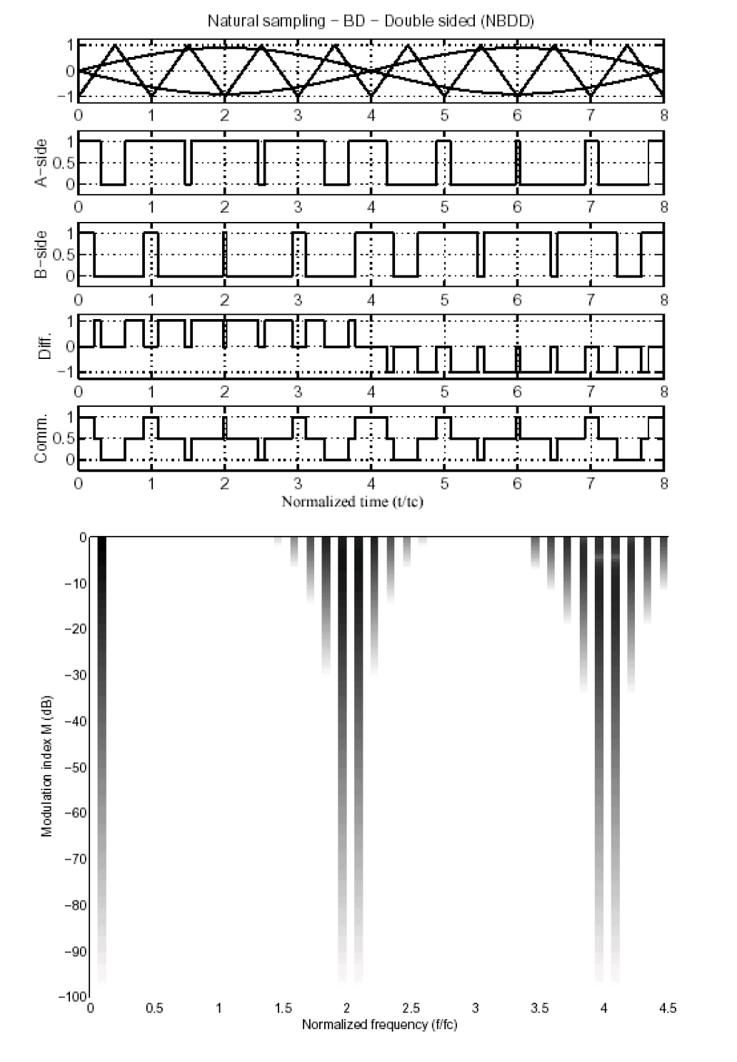

Can I ask what is [3-level PWM] ?

This module is full range one not LF, thankz to 3-level PWM . Try www.cwsbytemark.com for cores
This is 3-level PWM BD mode

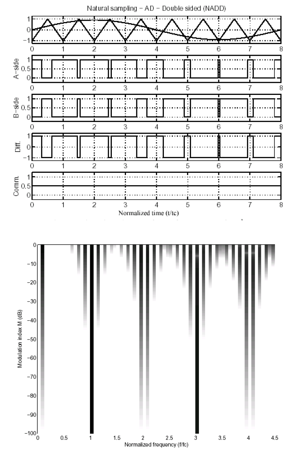

This is normal 2 level PWM AD mode

Workhorse, are those diagrams from an old AES paper?
Whether, I'm finding the spectral graphs difficult to interpret.
Yes, its from Karsten Nielsen AES paper on active pulse modulated transducer. You need to learn about histograms
