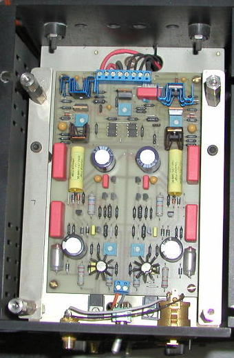

I have not run a Class A Amp on them yet, but my 300 Watt AB Amp runs quite coll on two of them. See Picture below.
Active surplus only has one more, I bought everything he had including his warehouse stock. I purchased the bare aluminum ones as the black ones are 20% smaller and are predrilled not blank.
There is definitely sufficient area in my design for a Class A 75 Watt Amp. I will post a follow up when it is running.

How about $100 CAD for 2 boards assembled and tested?
Is that 2 boards as in the power supply and front end board, like the Old Colony designs straight from the original articles?
Or is it some other configuration?
Anthony
I have two kinds of boards. One is double sided, only front end and Fets mount on chassis as here http://www.diyaudio.com/forums/showthread.php?s=&threadid=3353 . I'm asking $100 CAD for those.
Then I have another set of boards with regulated power supplies included (copied from Mark Levinson 23.5) and layout based on original article. One sided, heatsinks on Fets and Holco resistors. You would need about 2x50V AC for PS. I would be asking a bit more for those boards.
Those boards are tested and guaranteed to work OK.
