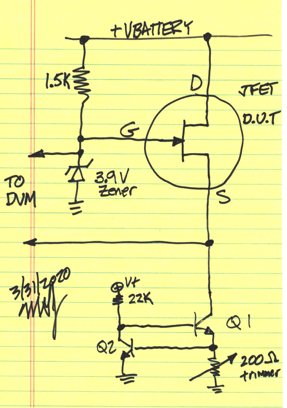

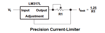

> how to build a constant current source to match the 2SK209s
A LM317L and a fixed resistor.
> if I need a heatsink for the FETs themselves
Yes, as large as possible at 22°C (or even better at constant 50°C)

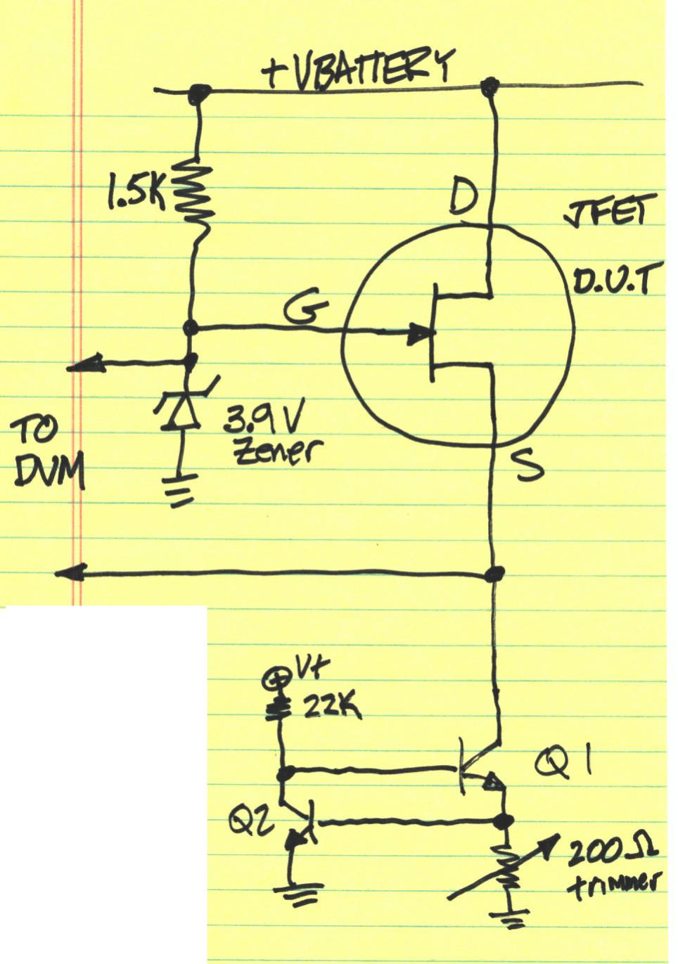

J113 Matching
Originally (when I organized the GB) - I thought it was just looking for parts with an Idss over 8.5. I thought I'd just use the "9V Battery" method. I was mistaken.
Apparently I need a CCS for 6mA. Here is the CCS schematic that a kind someone put together for me. I have the parts ordered. Q1 and Q2 are ZTX450 (or "any NPN").
I have not physically done this yet... so, I'll post more details. Again, if this is incorrect (or ill-advised), I'd love to know before I give it a go.
