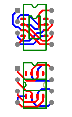

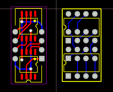

interest checking,smt to pdip adapter boards
3 patterns top view.

I have some so28(narrow) to dip adp and single to dual adp available.
I have not work on tqfp32 to dip design.if there are enough requirement,I am glad to project it🙂

Looks good but did you implement any decoupling caps? If not, do it because it's rather likely that they are missing or too poor where you want to use this adapter. Remember also that faster opamps need better decoupling. Bear in mind also to make the pcb as small as possible because it may be parts in the way at the motherboard.
