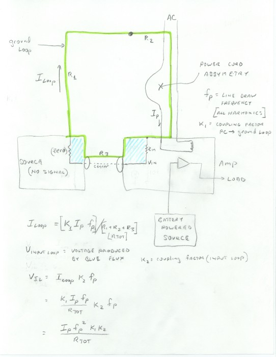

analog_sa said:What if ground loops don't exist either because the mains ground is not used or the connection is balanced?
Using the mains ground is not a requirement. The ground loop doesn't have to be hard, course some reactance would help, now wouldn't it? Don't neglect to remember that the loop sensitivity is proportional to the intercepted magnetic slew rate, ie proportional to both frequency and current. Supply haversines and coupled audio can be rather daunting to eliminate from pickup. The main issue with detection is masking of any effect by the musical content. A really bad loop gives itself away by virtue of either hum, or noise pickup. One which is not so bad, will not be so kind.
Balanced certainly helps a whole lot. But is the amp balanced in regard to grounding current? If you toss current into the grounding pin of the xlr, from 20 hz to 20 khz, through to the power cord ground (or capacitively, to the hot/neutral pair), does the amp completely reject it? Not the same test as a common mode voltage test.
I proposed over on AR coupla years ago, testing an amp for ground loop sensitivity. procedure, parts..setup..to no avail..maybe here?
Cheers, John
analog_sa said:John
This sounds very interesting pls tell us more.
Your killin me..
I'm just about to embark on a b'day vaca, no time to really get into it..
here's the jpeg I posted back in march of 2004.
Please forgive the rudimentary quality of my chicken scratches..
It shows the power cord loop, the ground loop (either hard or soft), how the power cord haversines will couple to the ground loop (or, any mag field in the area for that matter), and one of the ways the chassis current from the gorund loop can get into the input wiring. Since we are talking about currents and magnetic fields, I invoke faraday's law of induction to develop the relationship. To keep it simple, I just used constants of proportionality rather than attempting to calculate the actual numbers. The effort was to determine the frequency dependence of the effect.
Note that the overall coupling from the powercord current to the input current is proportional to frequency squared.. If you are hearing, while coupling to external stray fields is simply proportional to frequency, leaving out the middle man, so to speak.
So even if you don't hear the 60 hz fundamental of the amp's power draw, the sensitivity to the first power harmonic of a haversine, which is 180 hz, is 9 times that of 60 hz, and the second power harmonic of 300 hz (haversines are odd order harmonics) is 25 times more sensitive.
Here at work, the building PA input ground loop is so bad, that the hum that we hear is directly proportional to the power level of the anouncement, it sounds like somebody built a circuit that reads the audio power level, and amplitude modulates the hum and injects it into the audiostream..(actually, that's exactly what it is..
Oh, almost forgot..note that the effect includes the total loop resistance in the denominator.. That predicts that the level is dependent on the shield size, the outlet contact resistance, the line cord ground guage..
This diagram is a predictor, and should be tested for overall level of effect.. Oh, it also provides allowance for pushing the amp without the source of the push getting involved with the ground loop we are trying to look for. It also allows measurement of audio signals getting into the line cord. Kind of a generic test. In a hurry, otherwise I'd try to find the other scans.
