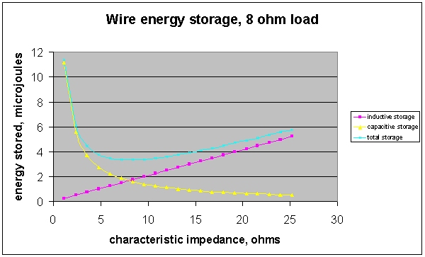

He is incorrect. As are you. Please allow me to explain.
The characteristic impedance of any media whatsoever, free air, waveguides, transmission lines, for the propogation of electromagnetic energy, be it TE, TM, or TEM waves, in any polarization, is defined by the storage within the media of both magnetic and electric forms of energy. The characteristic impedance is the impedance at which the energy stored is EQUAL..in other words, the equations E = 1/2 L I2 and E = 1/2 C V2 are equal to each other.
I've attached a graph showing how the capacitive and inductive storage of energy pertains to an 8 ohm load, vs the characteristic impedance of the cable. As is clearly evident, the minima occurs when the Z of the cable matches the load Z.
jn[/i] [B] When the Z of the cable matches the load said:
z is freq. dependent.
As I stated, when the load Z matches the cable characteristic impedance, which is sqr (L/C), the storage of energy within the cable is a minima.
Your statement that z is freq dependent is correct, but as a rebuttal to mine, it does not have any bearing.
The Z of a line has two components of dependence. First, the dielectric will have a freq dependence, I will not elaborate on the inner workings of that.
The L of a line has two simple components of frequency dependence. The first of which is skin effect. The more a conductor skins, the lower the internal inductance...in the hf limit, there will be zero internal inductance. External inductance, however, is invariant to the skinning of the conductor of interest. It can, however, be lowered by the proximity of another conductive surface due to eddy currents within the conductor (this of course, is exactly what causes the exclusion of current density we refer to as skin effect).
If you wish more in the way of explanation, I will be happy to oblige.
Cheers, John
ps...I lament having posted this graph three times here. Eventually, perhaps I'll have one of the forums host a page for me.
