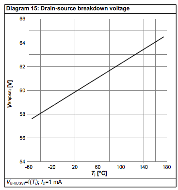

Interesting - so how to know what the breakdown voltage is when its not shown in the DS? Also what's the temperature coefficient of the breakdown voltage?
I just find one DS for IPD025N06N MOS-FET (60V device) and there is one diagram showing temperature dependency on device's breakdown voltage.
attachment.php
Thanks for sharing that. However its a result which, on the surface doesn't harmonize very well with earlier statements about breakdown voltage. Pafi said its 1.1 to 1.3X the breakdown so are we to assume the dynamic resistance is rather high?
As you said, on the surface. Then let's dig into the datasheet!
60 V is stated as minimum value in Table4 (at Tj=25 C as stated on the top of page 2). Since Diagram 15 shows the same value, it must also be minimum value.
I didn't measure minimum value, only 3-4 samples of a type, this is obviously somewhat higher. (And not for every one of the manufactured types of the whole world, only some of my preferred or interesting types. There can be exclusions.)
I generally measured it with 1...30 mA, but in this domain I experienced insignificant voltage change (insignificant for the normal application - I don't use them as high performance voltage stabiliser).
High dynamic resistance? I don't know what could be the logic behind this conclusion, and also what can be considered high for you. It is generally low enough to limit Vds voltage to under about 1.5*Vdsmax at Idmax.
