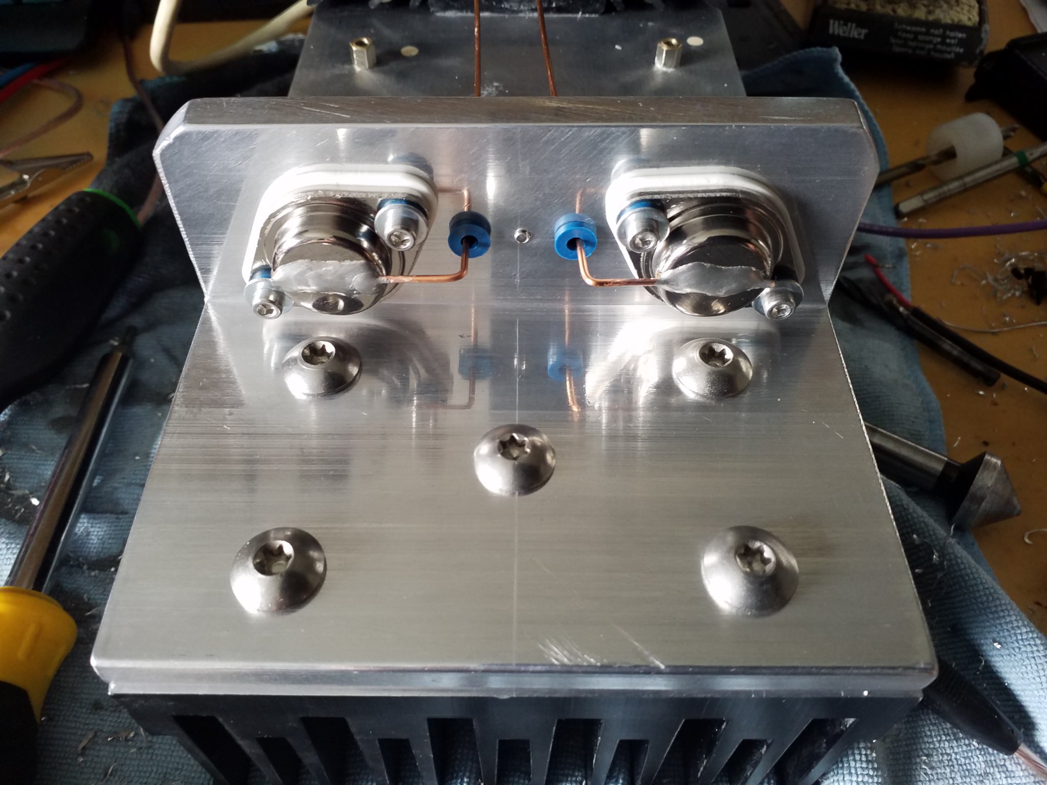

Hello there,
I get that you use a TO3 insulating pad under a TO3 device so you don't short it out to a heat sink if it is mounted on top of one, but what insulators do you use around the leads/bolts passing through the heat sink?
What type of fasteners are commonly used?
What would be a a good "broad" insulator to use between the board the the heatsink?

A 6-32 screw is std for TO-3 mount down. I use brass screws for somewhat better electrical conductivity. There are also std shoulder washers for insulating the screws from the TO-3 case. As Mark has pointed out, if you pony up and buy the mounting kit/kits, you get all the pieces you need. though the screws will probably be steel. If you are outside the US, the M3 screw is about the same size as a 6-32 (a little smaller), and could be made to work. The bushings in the kits might be nylon, not the absolute best for high temperature work, esp. as they can get brittle over time, or just melt. A better alternative would be premium bushings made out of polyphenylene sulfide, a more durable, higher temperature alternative to nylon bushings - expect to pay more, but you get compensated in peace of mind, especially if you're running a hot Class A amplifier...
One 3mm bolt size fits virtually all semis. Just search "transistor insulating bush" either with your browser or at your favourite parts supplier's website for quality product but I've not had problems with buying really cheap stuff from platform sellers either. 200 bushes for a couple of dollars goes a long way, if the plastic grade is up to the task but if you build "hot box" amplifiers, and need more assurance, you'll find major parts suppliers also want most of their money just to count them out.

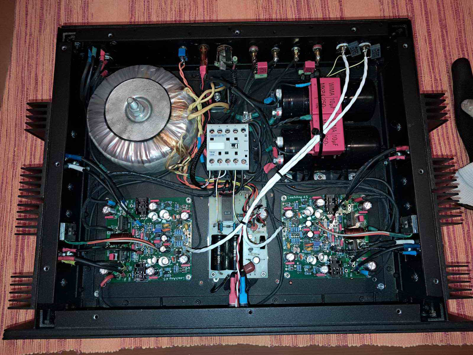

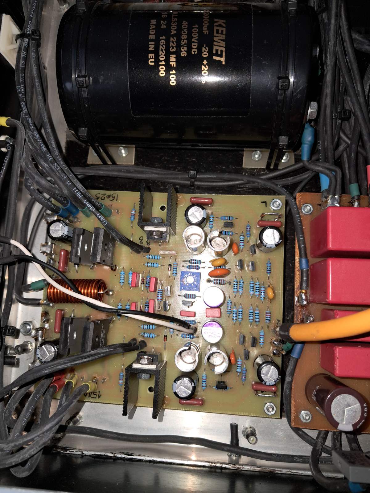

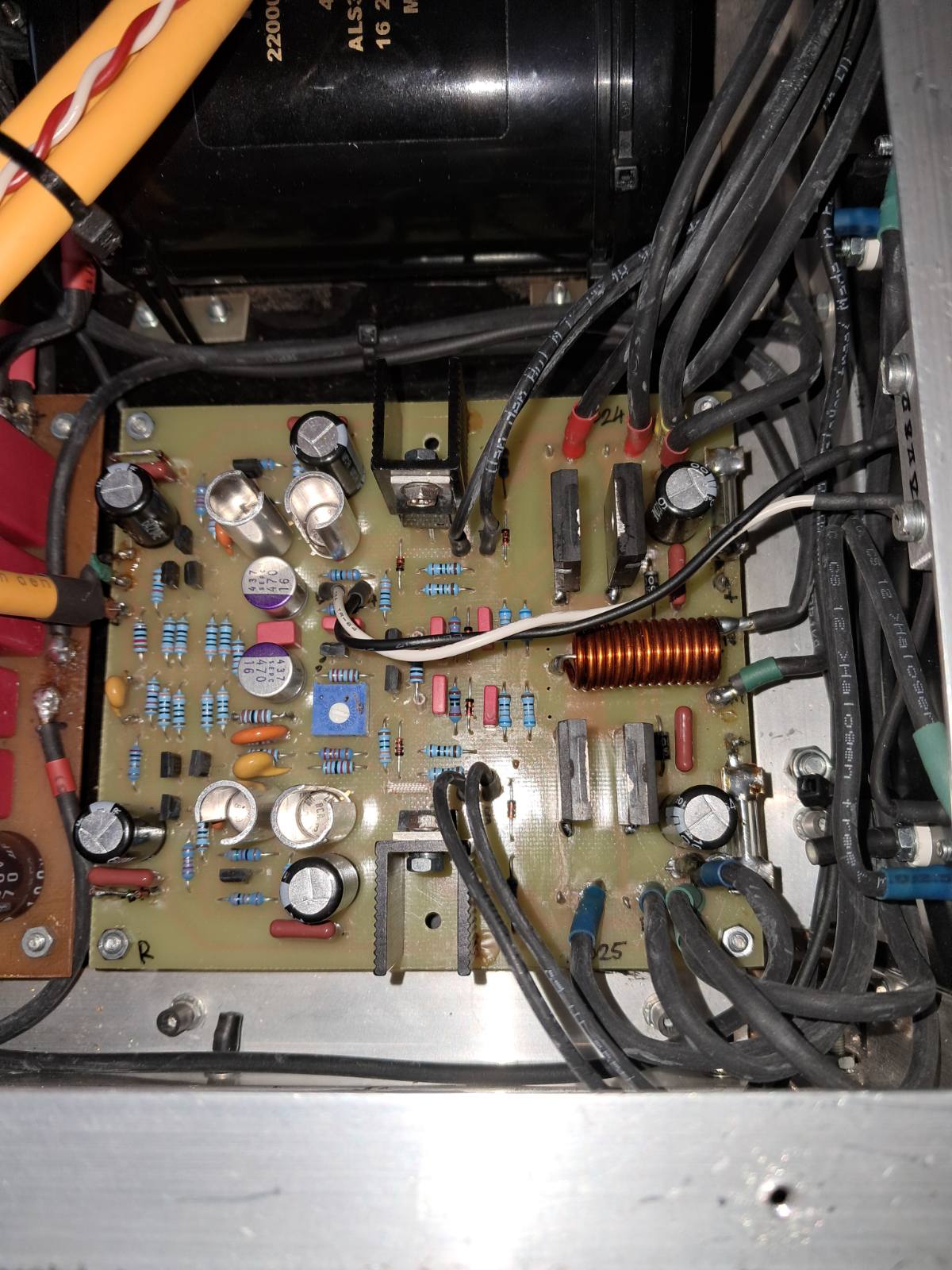

I have two amplifiers with TO3 output transistors. Currently the transistors (MJ15003/04 & MJ15024/25) are mounted on the heatsinks using M3 steel screws. I plan to replace that with brass or copper screws, nuts and washers. For the brass ones, I'm sure they are mechanically sound. I have no experience with copper screws and their mechanical properties. I'm worried that they won't loosen during tightening or later in operation, which would be disastrous. Has anyone used copper screws for TO3?

I asked on a couple of forums, nobody seems to be using copper screws for this purpose. Since I'm a bit scared of their poor mechanical properties, I go with brass. I just want to remove the steel bolts from the signal path.
