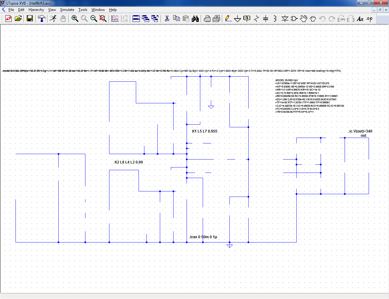

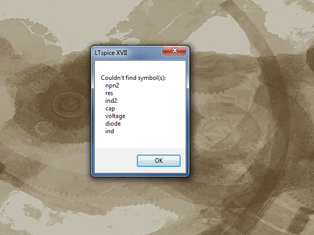

Problems with sync release in LTXVII
I installed LTXVII about a month ago, and after I solved the initial issues, all eventually seemed to run smoothly....
Until today: it asked for an update, and I agreed.
Unfortunately, the update has broken everything: now when I attempt to open an existing schematic, it is unable to find any symbol, including the native ones.
When I start from a blank sheet and I add symbols, I see them in the list, but when I pick them, nothing appears.
Any ideas about the cause of these troubles?
When I installed LTXVII, I didn't opt for the default location, because my C is almost full, but until the sync release, it didn't seem to pose problems

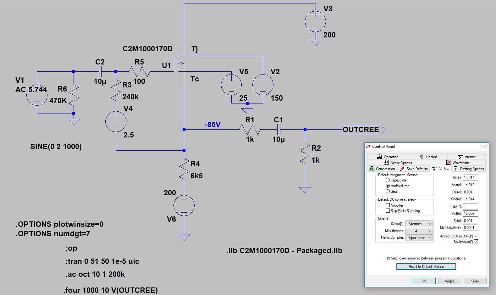

Using Cree SiC FET library for 3 years with no problem, now AC Analysis error:
"Unsupported mixture of time dependent and arbitrary behavior in .AC analysis"
Other .AC analysis simulations, which do not contains this library, are working.
Wrong control panel value?

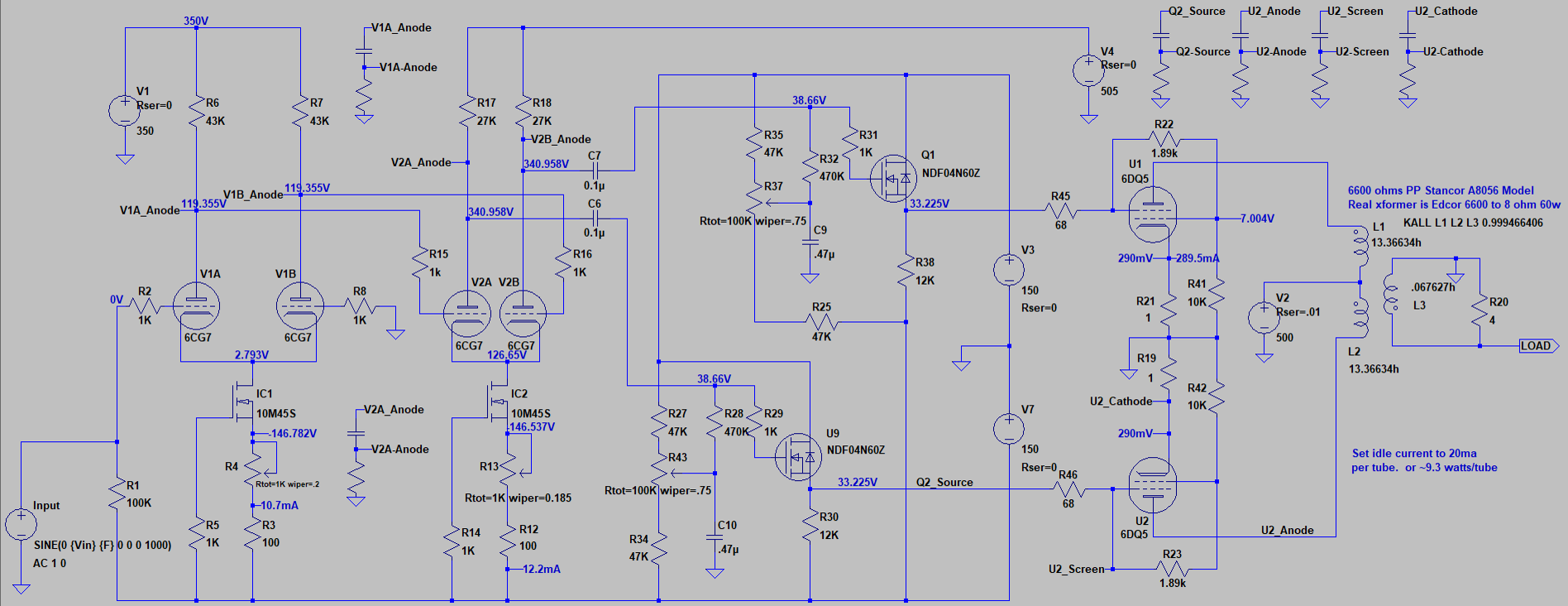

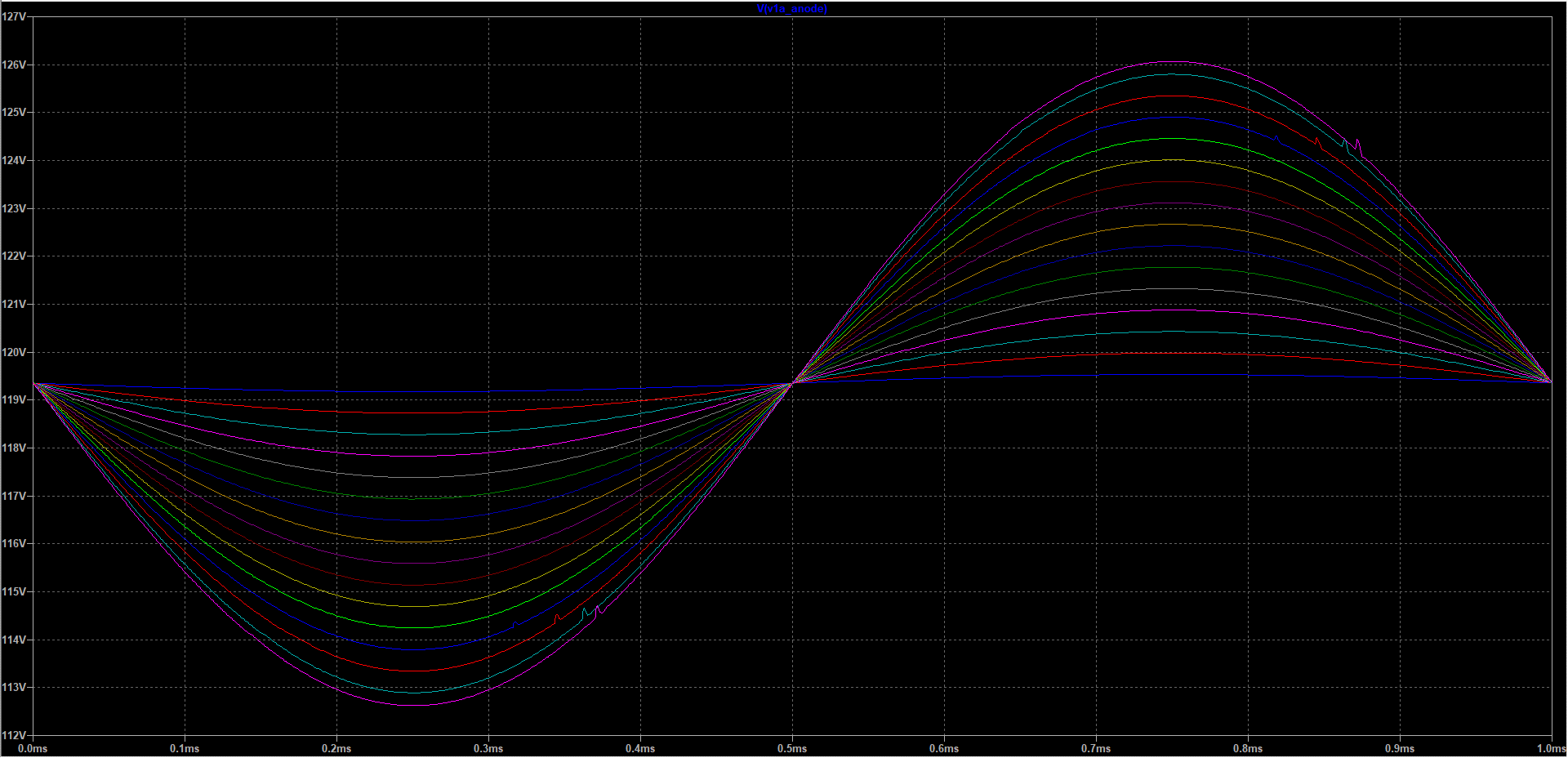

Hi. I have an amp simulation in which changes to the output stage are causing distortion in the input stage when there is no feedback.
A screen shot of one of many variants of this simulation is attached. I've noticed the problem on lots of occasions but here is an example.

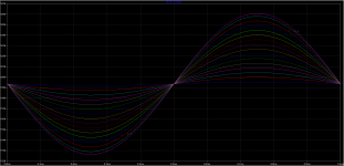

The first screenshot shows the first anode voltage as the input is stepped from 0.02V peak through 0.75V, steps of 0.05V. You can see spikes on the 4 highest voltage curves.
If I increase the output stage quiescent current from 18mA to 289.5mA (unrealistic but it serves to illustrate the problem) the distortion spikes disappear (3rd screenshot).
Any suggestions please?

Thanks Ray. The bottom rail is all at -150V.Try grounding the bottom (common) rail.
Could the observed effect be due to differing loading as the presets are varied in value ? i.e. nothing to do with the output stage as such.
If you remove U1 and U2 do you still see the same effect.
I'm wondering if something non linear (clamping effect) is happening with the FET that alters as you alter the gate bias.
I would like to see the schematic with models if possible since this can be hard to narrow down definitively.
Thanks keantoken. Model attached. Everything you need should be in the zip file.
This morning I copied all the files into a separate folder. Before zipping I opened the model file and ran it to make sure all was OK. Would you believe that I couldn't reproduce the problem?
I closed LTSpice (I've often wondered about problems like this being a result of something like a memory leak) and re-opened the original model. Same.
So, I modified the transformer and the problem returned. Closed and reopened LTSpice just to be sure, and it was still there.
No. It's a crazy drive model - combined screen and grid drive. I'm not having a lot of success with them, probably because the output tube models don't do grid and screen current well.
Q1 and Q9 are turning off during operation, creating spikes. This spike is worse than would occur realistically because the OnSemi models use NMOS which doesn't include subthreshold conduction and so their transconductance shoots to zero when they turn off.
Increase the bias on these transistors and/or use VDMOS models that include the ksubthres= parameter (which will be more accurate). The builtin VDMOS models in LTspice should all have this (although they may just use a generic value of ksubthres that doesn't reflect reality).
Thanks keantoken. I did some research and came across the Better power MOSFET models in LTSpice thread. Lots of treatment of this issue there.
Doubling the bias eliminated the problem.
I assume I have to know the identity of a suitable VDMOS device in order to pick it from the builtin VDMOS models. Can you please suggest something equivalent to the N-Channel Power MOSFET 600V, 2.0Ω that I'm using?
Alternatively, can I just include the ksubthres=parameter in my existing FDPF5N60NZ model? Of course, then there's the question of what I should set it too. I'm not seeing anything obvious in the datasheet.
What is the mechanism in the simulation by which the turn-off behaviour of the 2 MOSFETs impacts the first stage of the amp?
