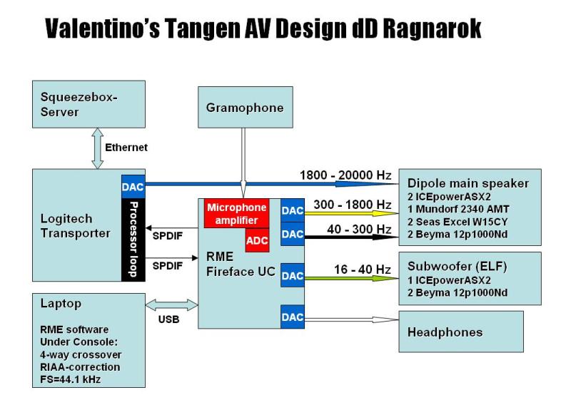

Let me say a few words about the finished product first. We will dig into the development process later, which was quite long and had a lot of design changes up to the last minute.... My customer was also largely involved in the design process - this is a custom design (almost) entirely to his own specifications. :) I hope he will comment in this thread.
The speakers are 3-way dipole, with closed box ELF subwoofers. All XO and EQ is PC-based.
Drivers are:
Tweeter: Mundorf AMT2340 without faceplate
Midranges: Two Seas Excel W15CH001
Woofers and subwoofers: Two Beyma 12P1000nd each
Crossover frequencies:
40 - 300 - 1800 Hz
Tweeter and midranges are baffle-less and supended, hung in wire.
Woofers are mounted in an H-baffle. The outer shell is made from 12 mm MDF and internal structure is 18 mm birch ply. Subwoofers are closed box with two 12" drivers mounted on each side, and they are playing in opposite directions. Cabinet made from 12 mm MDF and 18 mm birch ply.
All amplifier modules are mounted inside the speakers. The amps are:
Subwoofer: bridged ICEpower 125ASX2
Woofers: ICEpower 250ASX2 (one channel for each woofer)
Tweeter and midrange: ICEpower 125ASX2
Note: ICEpower amps are not availble for DIY. This is however not a DIY project, but a finished speaker system sold by my own company.
XO and EQ:
Software solution based on Console and Waves EQ-plugins.
Atom CPU based mini-laptop (Packard Bell)
RME Fireface UC external computer soundcard
Logitech Transporter as playback source
We also use the DAC in the transporter together with the DAC's in the RME Fireface. More on this later.

A system flowchart.
