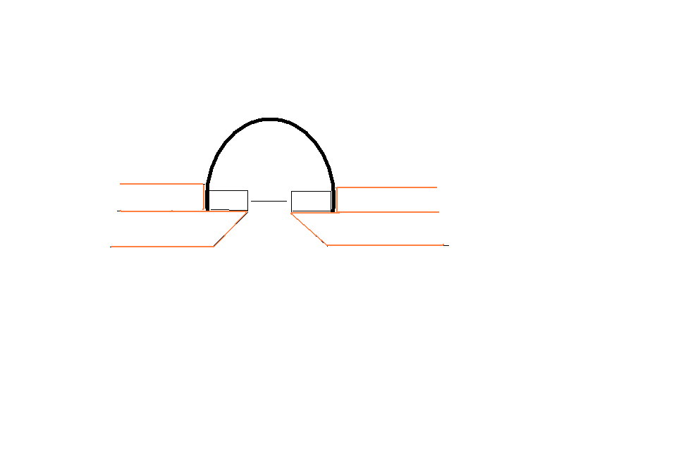

They sure do. The main advantage is a more spherical wavefront , which is natural in nature, by correcting for an out of aspect ratio mouth.Making the BIB a bit taller and including a "scoup" type mouth would refine the Fc wavefront and provide a bit more directivity. Look at the wavefront in a upward firing BIB. It fires directly up to the roof and that being a perfect reflector( 90 deg to the wavefront,energy being dependant on the acoustical impedance mismatch) there is a reflected wavefront with a given energy, dependant on frequency and distance, being reflected back to the mouth. This energy is compressed n its trip back to the driver turning a low pressure wavefront back to a high pressure wavefront, or the reverse of a horn action. This wave arrives in a random timed phase back to the driver causing distortion of the wave that the driver is producing by a pressure differential actopn. Remember that a reflected wave can be considered as a secondary transducer with some different prameters than was originally produced.

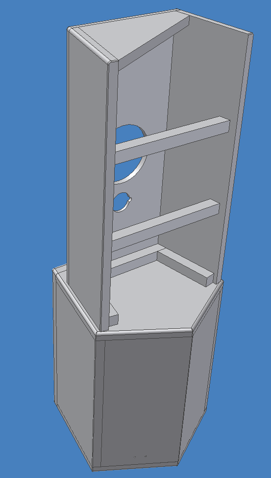

Thats funny .... we are on same path
I am working on something similar .... made the bass boxes almost 5 years ago
200 liter closed with matrix
midrange will also be a 6" in dipole ... with diy ribbons 🙂

Another one falls for the Basszilla style box. Not that there's anything wrong with that of course. 😉 I suspect you might set a little too much store by group delay though.

No prob Scott. The curve on the mouth of the Frugal helped according to Chris, but in that app it required a deflector. For the BIB which is upward firing it wont.

LOL, this is not especially Basszilla box, what I want isn't Big and Loud, but group-delay free, low-distorsion, and clean impulse response bass. Guess what : I can only get 100dB from these subs at 20Hz...

ronc said:This led to the use of the mouth curves that i now use as properly designed they can produce a more spherical wave and help a bit with the TL ripple.

Right, too small a horn mouth is ~acoustically equivalent to a too small baffle, so odd shapes that average out its standing waves helps a bunch if there's not enough room for appropriately large, rolled over flanges. That, or rim the mouth with the appropriate density acoustic foam to mimic the large flares, like done on some Peavy and the old Urei studio monitor HF horns.
