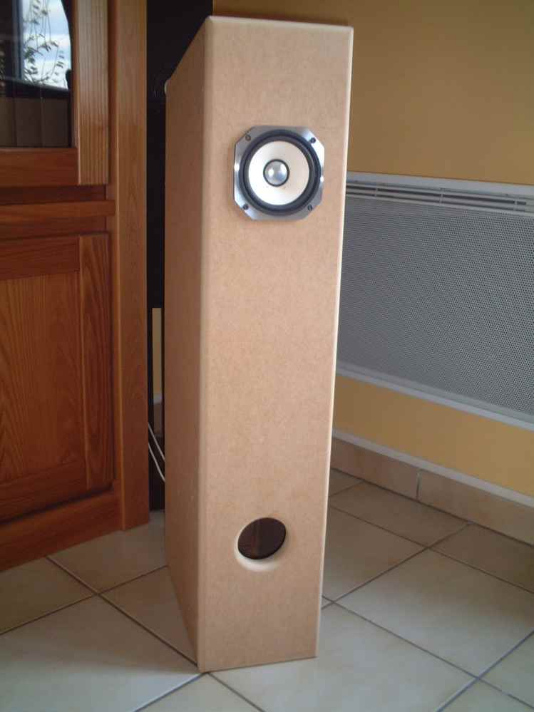

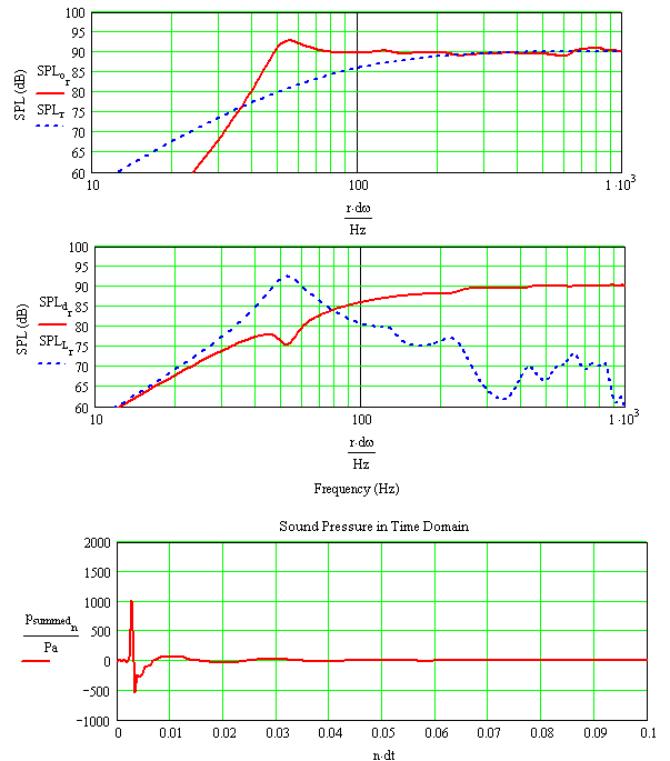

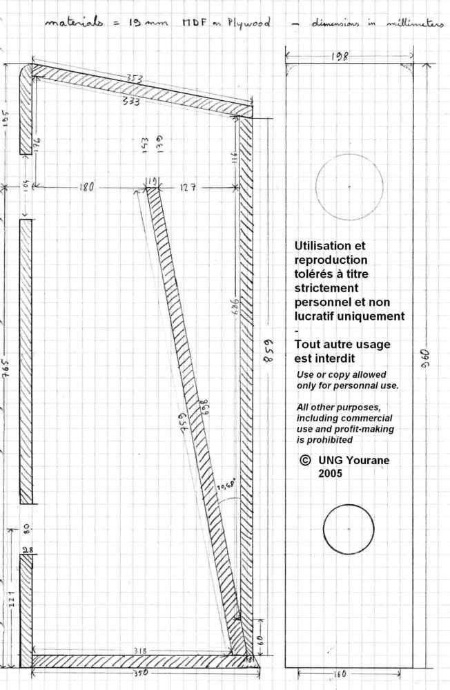

OK so finally I have done a web page describing this project
Inspiration : a TQWT for Fostex FX120
The digital version of the plan is coming

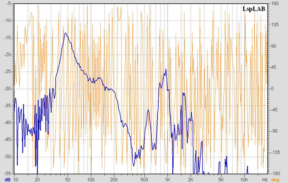

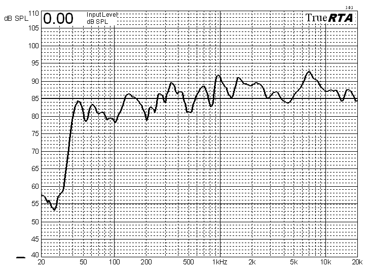

Commenting on your FR plot
The 50 Hz peak is typical of drivers that don't really want to go into TQWT's, or any other resonant cabinet for that matter. EBS BR's work best with these drivers. A bit of damping in the port will fix this.
The ~120 Hz hole is typical of TWQT's. It is the first overtone. More stuffing will help.
The ~180 Hz hole is most likely floor bounce. There is really nothing you can do about this one.
You have generated one of the best examples of baffle step that I have seen. Note that the trend line is ~ -2.5 dB to ~800Hz then it jumps to ~ +2 dB. Something around a 1 mH inductor || 6 ohm resistor is flatten it out. But then, this has aready been addressed earlier in the thread.

BobBrines : thanks very much for your analysis !

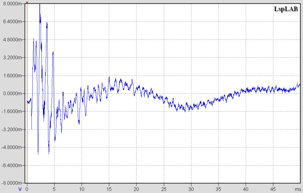

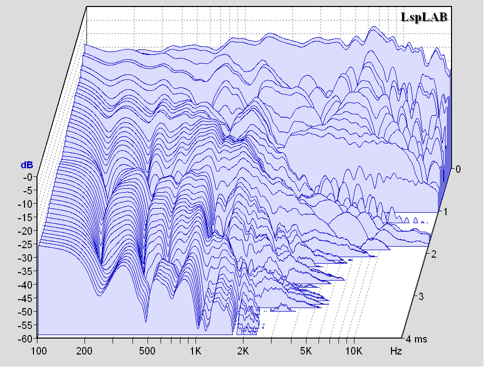

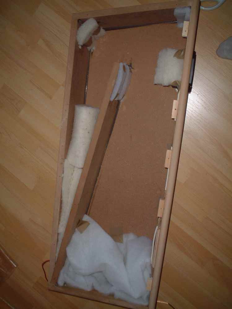

I've realised these speakers are underftuffed because the peak is sharper than in the MathCad simulation. Also, the CSD isn't clean so more stuffing on the walls behind the driver should partially correct for that.
For the 180Hz tone, if it is a floor bounce problem, then it will be corrected very soon, I have designed some stands and I will install them as soon as possible.
Concerning baffle step, well, yes it may be a very good example for noobs 😀
Right now I'm correcting for that just with my computer's equalizer, but if I wanted to sell these speakers, or install them somewhere else, I'd design a passive BSC circuit and post it on my website.
One curious thing is that sweeps give a smoother result than gated sine wave, surely because the bigger number of points. But then I don't have the distorsion measurements.
