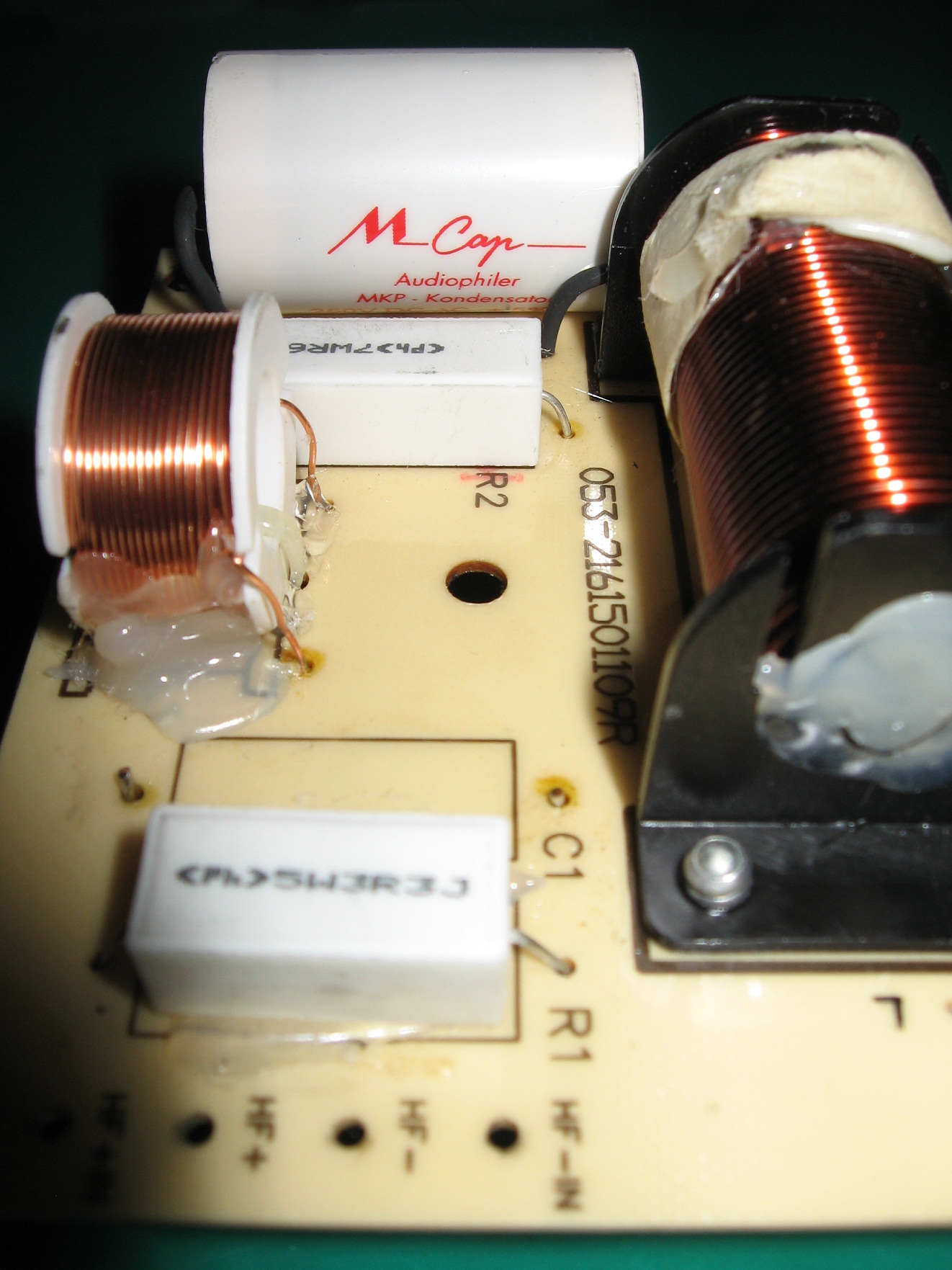

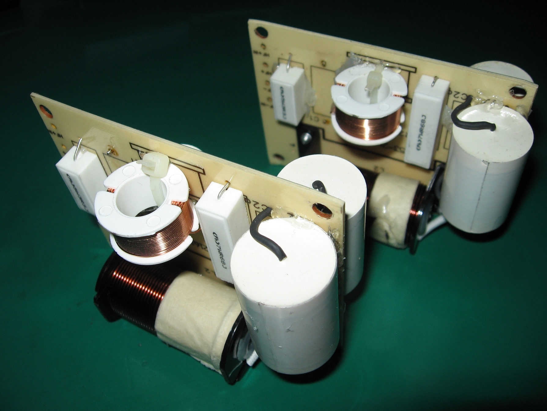

Hi All,
I just picked up a pair of demo spks and was wondering if they made a change? The features description on the Music Direct web site said "Polypropylene Capacitors on tweeter crossover for silky smooth highs". After reading the posts here, I called them and asked if they did in fact have polypro and the salesman said he did not know for sure, but this is what Wharfedale supplied to them. I do plan to change to better caps, but wanted to ask all of you that have looked inside, what you found.
Also has anyone come up with a higher order x-o or improvements to the current design?

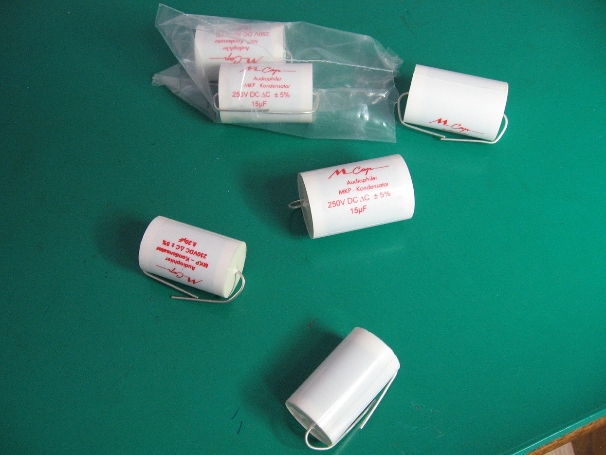

I think that I was the one who originally recommended the Mundorf MKP's as being a very good affordable upgrade, so I would love some feedback on any auditory experiences, and subjective changes by swapping out the caps.
