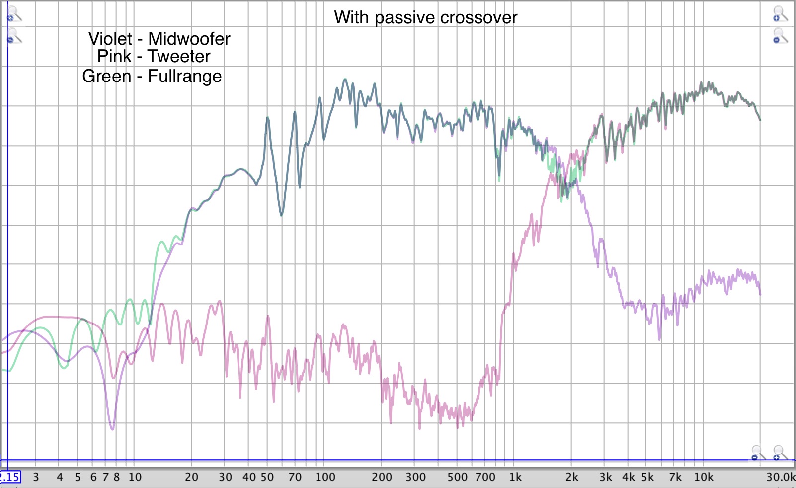

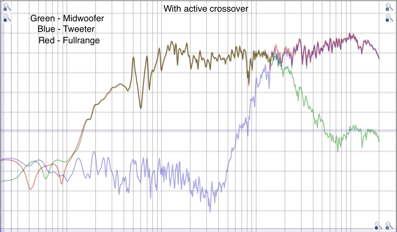

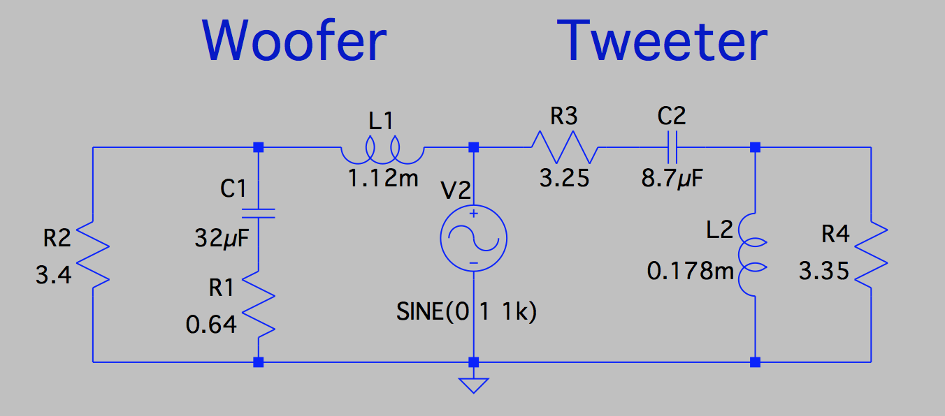

I wonder what they would sound like with the tweeter polarity reversed, to improve the xover dip ?
Why would you want to do that? Gornir's measurements show decent enough phase tracking with the over as is. If you invert the tweeter you'll just get a nice deep null.

The right way to go. You can't match the performance of an active crossover with a passive one. I saw the improvement you made. How would you describe the difference in sound?

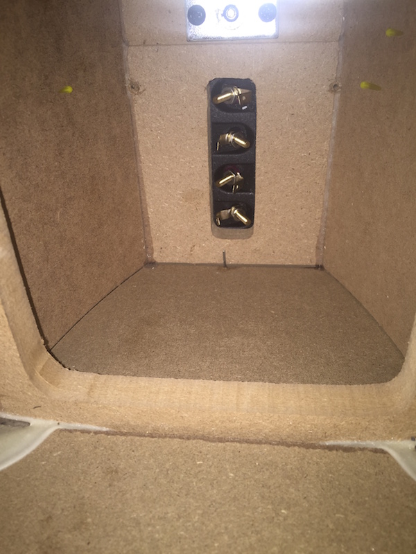

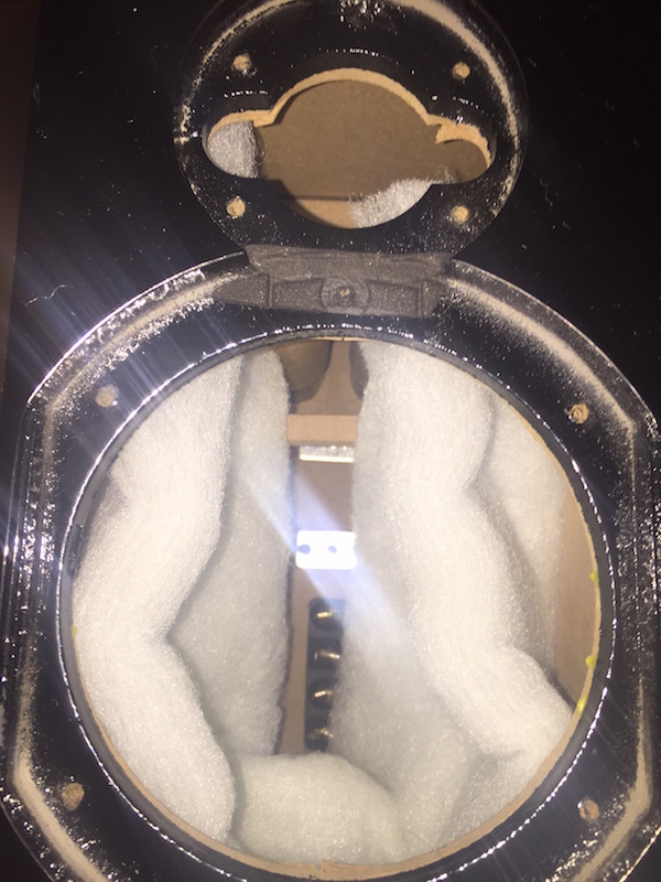

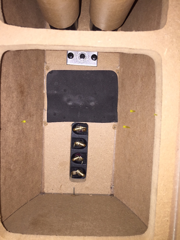

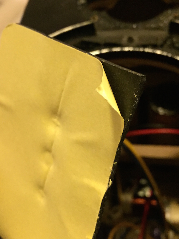

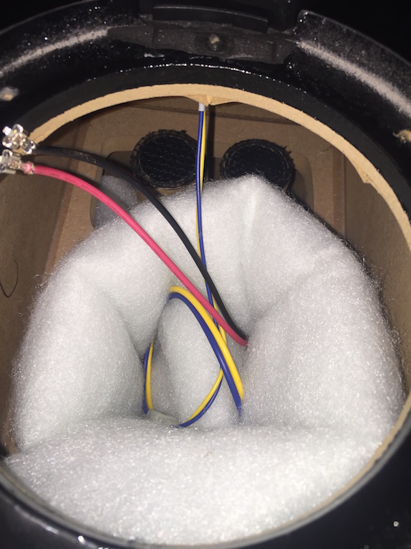

I want clarify my comment on the damping material. The cutaway picture shows the proper way that it was done. It does not need to be glued down, but it needs to be lined up against the cabinet walls. In a vented box design, volume stuffing the cabinet has very little benefit.
Volume filling a reflex box
I will try to get inside again an align the material on the walls and see if that changes the sound.
The speakers seem better controlled by the amp, the sound seems more coherent and authoritative, and I could adjust the phase to be perfect in sync on both the tweeter and woofer. Couldn't notice any xover dip while taking measurements later.
Hope I have some time to do two sets of measurements, one with the passive xover (ran into it in the junk bin last night) and one with the active xover. I could clearly see the dip at xover point with passive. With active I can't tell from the graph.

I think the picture in post 9. as far as I can tell this was the passive version... certainly looks like the tweeter needs inverting

They don't match Gornir's measurements at all.
If I'm not mistaken, gornir measured a 10.2 set, I have 10.1, smaller.
Also my measuring mic is not calibrated (but I'm interested in the general idea, not something very precise).
So I wouldn't call my work a reference, just more of a general idea of what's happening.
Also my passive had a different xover point than 10.2, but I can't remember for sure. Different part values.

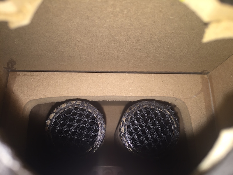

Also i don't think traditional bass reflex rules apply to these speakers. If you look at the ports they have a net on them which makes them a-periodic. I am no speaker expert but i don't think there is a lot known about hybrid designs like this on the internet.
The net could just be there to stop small animals from getting inside.
I've just seen a measurement where it cleans up the overhang to a negligible level. Not sure what it would do to throw off normal bass reflex modeling though.

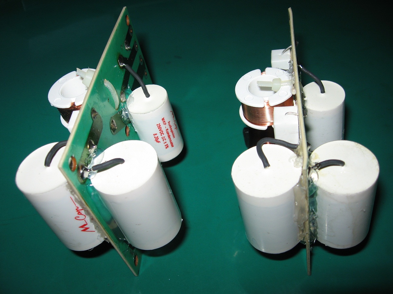

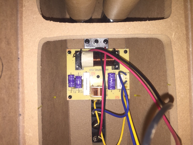

Hi All,
I just picked up a pair of demo spks and was wondering if they made a change? The features description on the Music Direct web site said "Polypropylene Capacitors on tweeter crossover for silky smooth highs". After reading the posts here, I called them and asked if they did in fact have polypro and the salesman said he did not know for sure, but this is what Wharfedale supplied to them. I do plan to change to better caps, but wanted to ask all of you that have looked inside, what you found.
Also has anyone come up with a higher order x-o or improvements to the current design?
