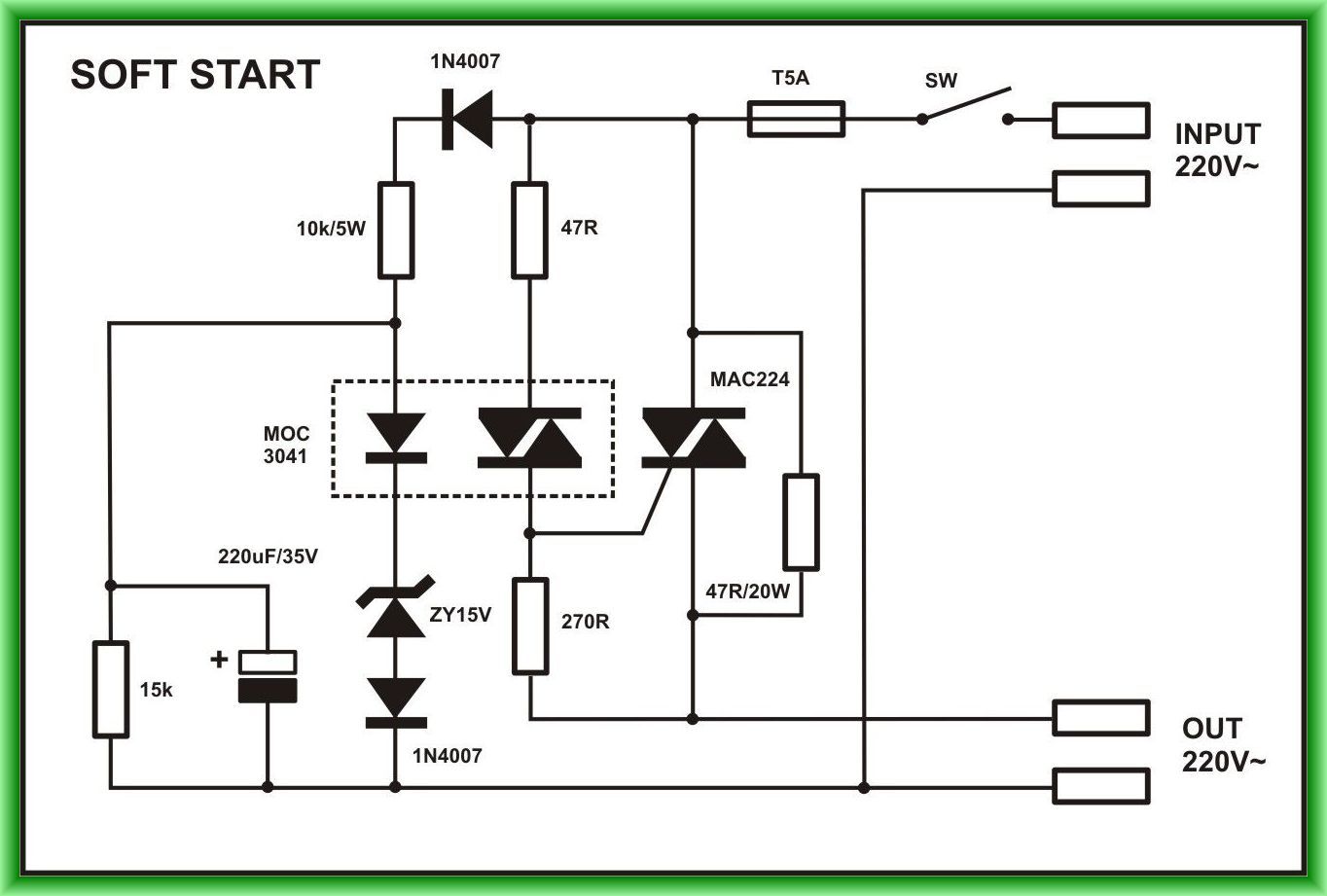

The timing varies enormously with Mains supply voltage. It can reach the point that on low supply voltage, the relay does not bypass and the resistor, then require to be rated for MANY kilo-Watts.
and TNT replies withThat's safer.
But still no fuse.
Add a real timer to trigger the relay, not a voltage dependant RC
The example shown is a very bad timer circuit.But then it's not *very* simple anymore
This is the correct analysis...................As I said earlier, in my case I have a 1.5kVa trafo with 0.564F cap bank at 52Vdc with a class A circuit drawing 6A at 52Vdc behind all that. A soft start with a 10A fuse will NOT work in my case. I had to design a separate slow charge circuit after the trafo in order to slowly charge up the cap bank. In my case I used NTC's in series with a relay to switch them out after about 18secs of charging .
A soft start to "START" the transformer. Any following capacitance/inductance does NOT affect the soft start circuit, nor the components selected to enable the ~200ms delay.
The capacitance AFTER the transformer is what may require a slow charge.
The CURRENT through the rectifier is controlled/limited by the slow charge resistance.

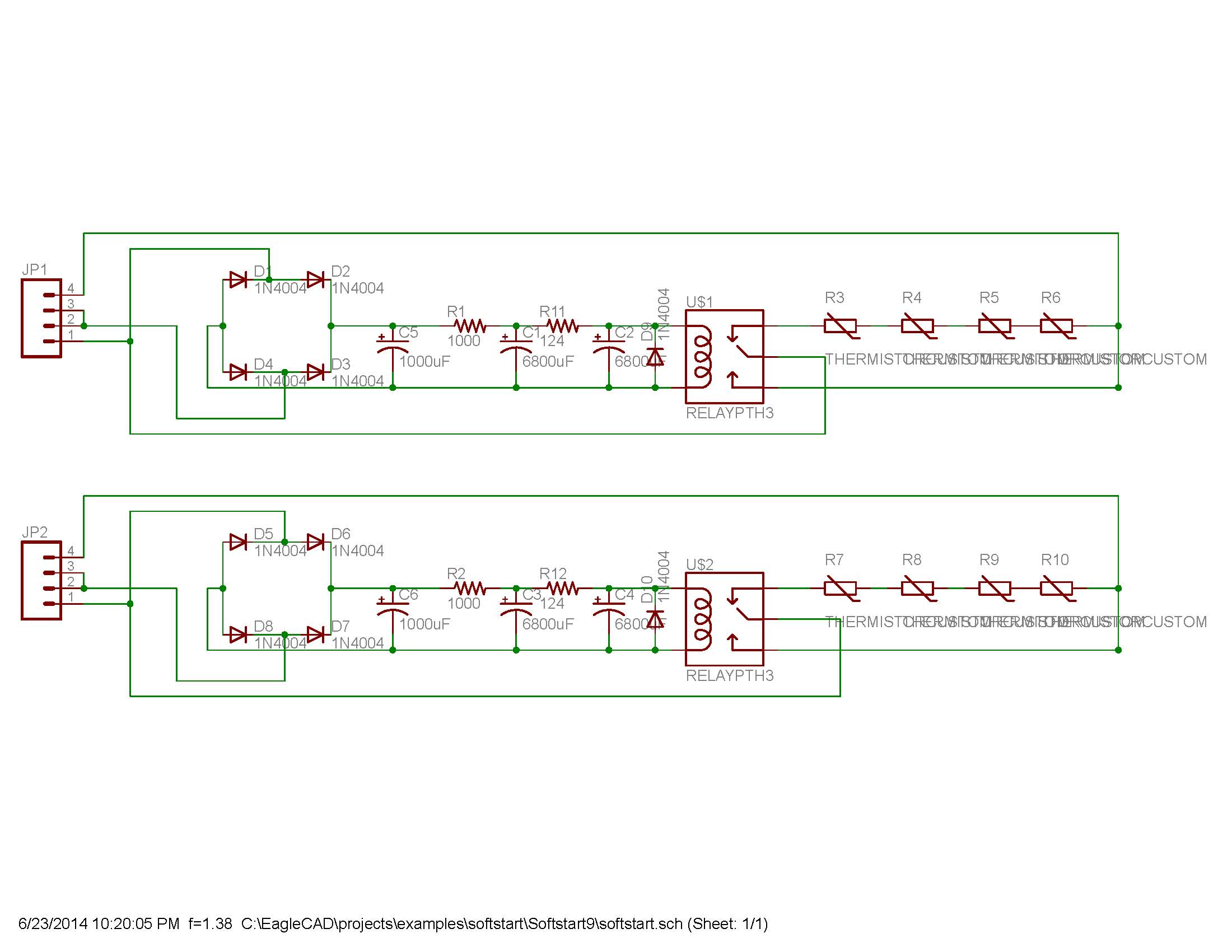

should say:In my case I used NTC's in series with a relay to switch them out after about 18secs of charging
NTC's in parallel with a relay to switch them out

Except:should say:In my case I used NTC's in series with a relay to switch them out after about 18secs of charging.
Hmm the circuit I use after the transformer is below.
