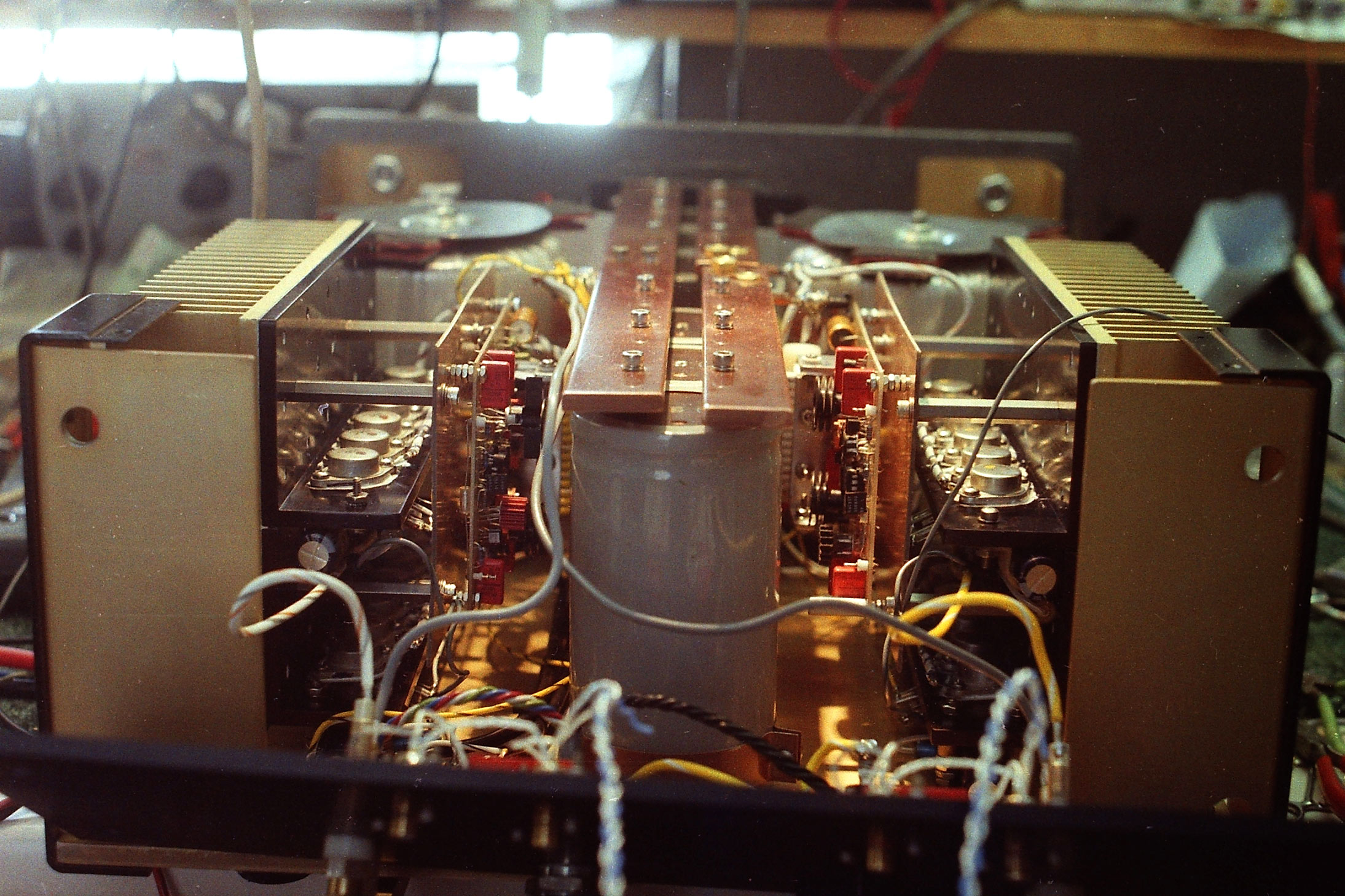

Here's the output side, the relays (2) one for on/off and one to bypass the resistors, each a 4 pole P&B with ~0.250" contacts in parallel, are on the other side of the stacked toroids. But you can see the cap bank.
