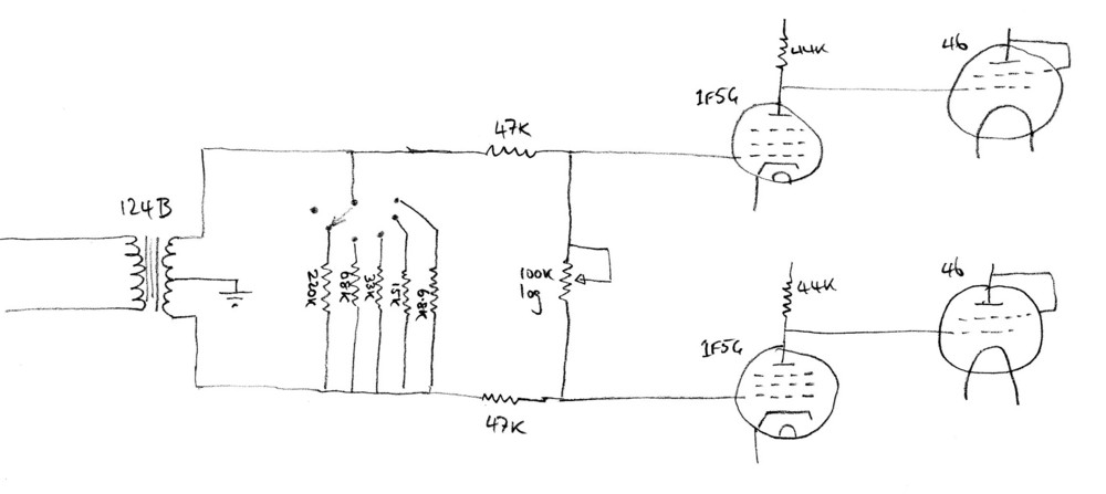

Hi All,
Been struggling with my very limited understanding of input/interstage transformers. In a setup I have with an input transformer (humble Hammond 124B-works surprisingly well and suits my 'budget') on the input to an amp should the volume pot be across the primary or secondary winding (between the grids of the diff pair)? The Tx is doing phase splitting to a pair of 1F5G's as diff amp driving trioded PP 46's sitting on a 6F6G CCS (local feedback from screen taps on output Tx to plate resistors of 1F5G's). Amp input is direct from CD player at present... Now would I just be better off to insert my 71A linestage (which has a volume pot across its input) and just do away with the pot on the amp? I'd really rather be able to use the amp without necessarily having to hook up the preamp just for volume control +/- impedance matching issues...
My understanding of the frequency concequences of primary/secondary loading and impedance matching etc is sketchy at best - I could really do with some help from the learned and experienced to set me off in a sensible direction. At present I have a 100K pot across the primary as one would for a standard SE voltage amp which works but the result is perhaps a bit on the 'bright' side (bass is fine) and in fairness I haven't explored the question of loading of the secondary or anything like that as yet.
Cheers, Andrew.

Mmmm, 2 schools of thought with 2 to 1 in favour of pot across the secondary. Conceptually that is probably slightly more pleasing. The Raleigh Audio approach was what I was what I had in the back of my mind (nice to see it implemented by someone so at least I can be confident it will work)
SY - ta muchly for the ref to the Jensen site. Loads of info but mucho bewildering - could I trouble you to point out the more poignant papers to this Tx neophyte?
Presumably I will need to work out what resistance across the secondary sounds best (least ringing with these cheapo trannies) and then fashion a setup as in Fig 17 of the Raleigh Audio or pannos29 on this forum (that thread started after my search and I'm embarrassed to admit I didn't see it before my post....). Should I use my preamp (likely output impedance of perhaps 2K) in the chain with the current vol pot removed and then experiment until I get the sound I like or can I leave the pot across the primary for the time being and skip the preamp? Are the shunts across the primary and secondary likely to significantly interact or are the relatively independant? No sig gen/o-scope available so I can feel a bit of trial and error coming up!!
Andrew.
The maker of the input transformer will generally recommend a load. If your potentiometer is larger than the recommended load, you can either pad it down by paralleling a suitable resistor or use a series RC to tame any ringing. For the case of the Jensen JT11-P1, the recommended load is 10K; in my preamp (http://www.diyaudio.com/forums/showthread.php?s=&threadid=58757), I used a 100K volume control, then just paralleled the control with a 15K resistor to bring the load closer to spec. IIRC, Jensen showed the series RC trick on the JT11-P1 datasheet.
Putting the pot on the primary of an input transformer will compromise the common-mode rejection.
I'll poke around and see if Hammond specs the best-case load for your transformer.
Thanx SY - a lot of the info I need. Ta for the link to your preamp schematic. May I ask is the 1M resistor from pot wiper to ground just insurance in case the wiper ceases wiping?
I will jump straight into loading the secondary of the Tx with the pot tonight after the kids are fed, washed and in bed...
Would it be wise to find a good value of total load resistance and then split it in 3 series parts with the central bit being the pot (I don't mind changing from 100K that's just a value I use from habit for volume pots) and equal to half the total needed load R? This is basically the schema used by the Raleigh Audio design for push-pull grids in a differential setup like mine (the SE case is way easier to get my brain around - as in the Heretical Unity Gain Line Stage).

Resistors placed across the primary and secondary will interact. Each is reflected across the transformer as the square of the winding ratio.
Sy is correct in that putting the potentiometer on the primary will compromise the common-mode rejection. One of the advantages of a transformer on the input is that it provides the opportunity of having a balanced input. Of course, you can ground one side of the primary and have an unbalanced input if you want. Putting the potentiometer across the primary forces an unbalanced input.
Determining the total load resistance and then splitting it into three (unequal) parts is a good way to start. The main reason for the shunt resistors is to provide a minimum input impedance when the volume control is turned all the way down. If they were not there, the input impedance would be zero Ohms when the volume control was turned down. Determine what you want your minimum input impedance to be and then each shunt resistor should be one-half that value.
The shunt volume control can be used with the center tap of the secondary of the input transformer either floating or grounded. With the center tap floating you will need to provide a ground reference to the grids with resistors between each grid and ground. These resistors are not needed if the center tap of the transformer is grounded.
The volume control configuration shown in figure 6.9 of Version 1 of Morgan Jones is essentially the same as that shown in configuration B of figure 17 in the Raleigh Audio article. In both cases the potentiometer is wired between the two grids with the wiper of the potentiometer connected to one of the grids. Raleigh Audio shows the top of the potentiometer floating and not used. Morgan Jones shows the wiper also connected to the top of the potentiometer, which shorts out that part of the potentiometer so it is not used. In both cases the input impedance will vary with the setting of the potentiometer.

Hi All,
Finally had a chance to fashion a volume control on the secondary side of the tranny. Rotary switch with a series of shunting R's to give variable loads. Been listening to 100K mostly which sounds quite good - fuller bass and less tizzy top end than the pot across the primary. 200K is a bit thinner but I really can't pick much in the way of difference with loads from 100K down to 6K. This is with the input straight from DVD and I guess may not be so with a preamp in the chain (my current one has an output impedance of around 2K).
Is it a reasonable rule of thumb to use the secondary load roughly equal to the rated secondary impedance? So for a 10K:90K (like mine) 90K would be good and for a 10K:10K then 10K would be a good place to start?
Cheers and thanks for all the help, much appreciated.
Andrew.

Square test
Apart from the listening test which is very much needed indeed, I would suggest you to try square wave test at about 3-10KHz signal while changing the secondary loading in order to get the best results. I my case it worked wonders and completely transformed the responce of the input transformer, in my case 10K was the best ans 6K and 22K was acceptable.
Panos
