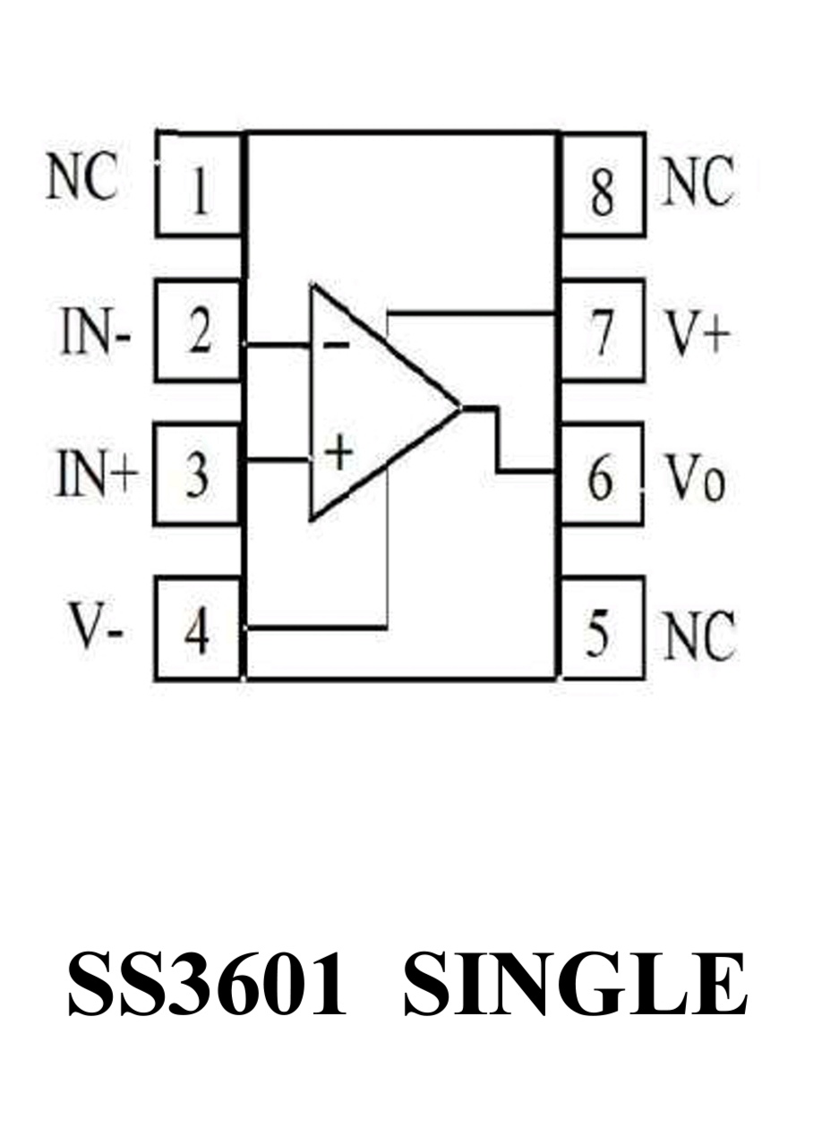

I have two OP Amp's Sparkos 3601 single lying around. If I understand it correctly I need 2 pieces per channel, first S-Pro2 module 1 * op amp for Ch1 normal and 1 * op amp for Ch1 inverted (phase reverse) ... The same then for the second S-Pro2 module for Ch2.
Can I use the Sparkos 3601 for this?
Enclosed the pin assignment of the op amps. How can I connect the signal CH1 to both to get the desired result?

Hi Manro, not sure if I understand you correctly, you have 2 s-pro`s or one?
The output from you dac (L and R) will have to go through 2 s-pro`s otherwise you will have only
a mono amplifier.
I don`t know how to configure your op amp to phase reverse.
OK I see you have 2 modules, did not read your text properly.
Perhaps you find a ready board that does do the phase reversal for both your s-pro´s?
Easier would be to use 2 transformers one for each module.
Sorry but I cannot help you with this any further.

Yes Subtonal the input of the module is unbalanced.
In that schematic S-pro2 module has a typical inverter opamp and input impedance is 2.2k. The 47K resistor to GND doesn't make sense there unless they use noninverted opamp which has high impedance
