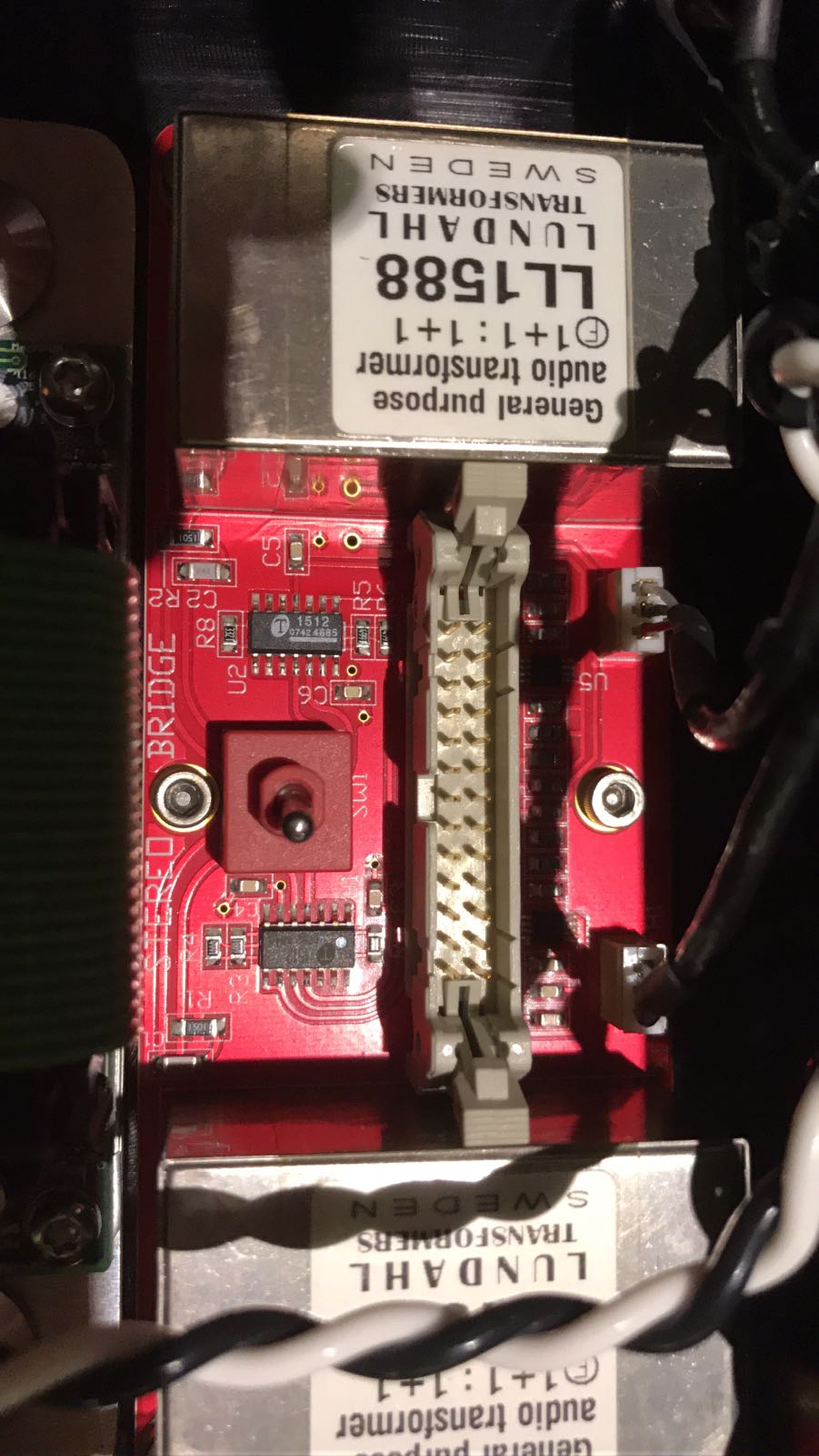

This is my first posting here, my question is if a 4:1 input transformer would work on the Pascal S PRO2 module.
The gain of the S PRO2 is 26db and it has a 2k2 input impedance.
My tube preamp has 20db gain from parallel 12au7, anode output, output impedance 2k5.
I found the following transformers: Lundahl LL1545 and Jensen JT 10 KB-D.
Would this work or will I loose too much gain because of the 4:1 transformers?
A alternative could be a output transformer in my preamp.
Any thoughts or experience about/with this?
Kind regards!

The 4:1 transformer will cause a loss of -20*log10(1/4) = 12dB.
The effective input impedance will by scaled up by the square of the ratio: 2.2K * 4^2 = 35.2K
There will be a voltage divider action between the preamp output impedance of 2.5K and the 35.2K resulting in an additional loss of -20*log10(35.2/(35.2+2.5)) = 0.6dB
Giving a total insertion loss of 12.6dB

Thank you both for your valuable information!
JohnnyInBris, it seems I might have enough gain to play with and worth trying a input transformer.
Eva, these modules may not be high end in terms of measurements but they are well regarded in various well known amplifiers, Rowland for instance.
It seems to me that adding more opamps in the signal path would not be a sound idea
as the sound is already "compromised" by the use of the MC33079.
Anything in front with a higher slew rate than 7.0 V/µs does not make sense if I understand this correctly.

Calculating Output Zobel/ Input filter for power amp module
I would like to introduce a filter stage between the Jensen JT-10-KB-D and
the Pascal S-Pro 2 module to limit bandwidth reaching the S-Pro 2.
How do I calculate this, I have a input resistance of 2k2 on the module, a DCR from the transformer secondary of 91 Ohm in parallel with the 2k2.
Can I just put a cap parallel to this or would this create a problem because
of the inductance of the secondary of the transformer?
Would a Zobel be a better solution?
Someone from JRDG mentioned that to get the best out of a class D amplifier
it would be good to limit the incoming bandwidth to the module.
Please advice,
Please advice,
