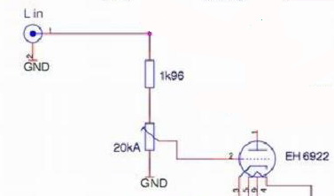

Why amplifier designer has to put resistor input normally 1K ohm after RCA-In.
What are the purpose of that resistor?
Can I put capacitor 2.7nF after 1K ohme to ground? (low pass filter of 58946.275 Hz)
My amp does not have that 2.7nF capacitor after resistor 1 Kohms.

I would insert the resistor in series with the grid.
How I see it :
iImagine that
- the cursor is either full clockwise or full anti-clockwise,
- the grid connection from the pot cursor is slightly inductive,
- there are parasitic capacitors
between the cathode and the grid and
between the anode and the grid.
That's a lawn propitious for LC oscillations.
The purpose of a resistor in series with the grid is to damp them.
Putting a resistor as shown above the volume pot does almost nothing. It needs to go straight onto the grid pin.
Adding a 2.7nF (not uF!) capacitor to ground might make the input difficult to drive. Note that the HF rolloff is extremely unlikely to be at 58,946.275Hz. Several reasons for this:
1. resistors are not usually obtainable at such tight tolerance
2. capacitors are perhaps never obtainable at such tight tolerance
3. the source impedance affects the result
Might be better to describe the rolloff as being at 59kHz or even 60kHz. Have you heard of significant figures?
