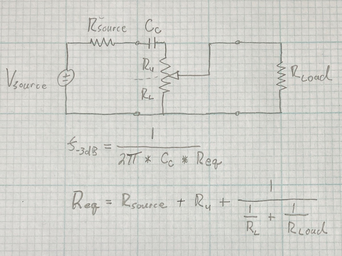

The output impedance of the CF is supposedly 612 ohms. How is that affected by the use of a combination of a 10k pot and 1uf cap (the stock combo) vs a 10k pot and 10uf cap vs a 100k pot and 5uf cap?
I hate to ask but, is there a formula?
OK, so I think I'm getting it now. Thanks so much!!
So the output impedance of the CF (612 ohms) doesn't really figure into the calculation? He seemed to indicate that it did.
You are welcome. The preamp’s output amplifier (a cathode follower in this case) output impedance does play a role as you correctly heard. It’s just that the the value of that impedance is usually very small relative to the load resistance which it drives that it typically becomes negligible. For demonstration using your example of a CF with a 612 ohm output impedance, you would simply sum that impedance with whatever value is the load in series with it. In other words, you can treat it as though it were a fixed value part of the upper segment of the volume pot.
For example: [612 ohms + 9K ohms upper-segment of pot. + (1K || 10K = 909 ohms) = 10,521 ohms in total]. 10,521 ohms in conjunction with a 1uF coupling capacitor gives a -3dB frequency of 15Hz. When we didn’t consider the effect of the CF output impedance, the total load was 9,909 ohms, only a 6% difference. Which is why the -3dB frequency only changed by 1Hz.
You can see why it’s often considered better (but not always, for reasons of noise, and input bias current offset) to have the power amplifier’s input impedance higher than lower. As doing so enables the use of a smaller value (read as, less costly) coupling capacitor.
You've posted the results in chart form but not the actual calculation. What formula is used to integrate effect of the CF impedance and the series R of the pot with the data points (the 1uf cap and the various R to ground values) used by the high pass calculator? If you could "show your work" rather than just the answers it would help.
I will try to make this as simple as possible. In figuring the low frequency rolloff point you need to include the source impedance, the coupling capacitance, both sections of the volume control (above and below the wiper contact), and the load impedance on the circuit. Please look at the attached diagram.
First, please note from the equation for the frequency, that the lower Req becomes (for a given value of Cc) the greater the rolloff frequency will become. When Rl is small compared to Rload, then Req is relatively constant and that accounts for the "flat" part of the curve on the left hand side of the graph. However as Rl gets larger and Ru gets smaller, the total resistance will become smaller because the Rload is in parallel with ever greater portions of the volume control total resistance. This is why the curves bend up at large values of control setting.
Given the numbers I used Rsource = 612Ω, Cc=1.0µf, Ru+Rl= 10kΩ, and Rload = 10kΩ. So at 50% shaft setting on an audio taper potentiometer, RL≈1kΩ and Ru ≈9kΩ. This makes Req=612+9000Ω+909Ω=10.52kΩ. But at 100% shaft setting, Req = 612Ω+10kΩ||10kΩ=5612Ω. Because Req is smaller, the low frequency cutoff is higher.
Does this help clear up your confusion?

Yes, thanks, this confirms Ken's earlier explanation. As I said, I ran the high pass calculator with data based on settings at 10%, 50%, 70% and 100% and the results tracked your graph results.
