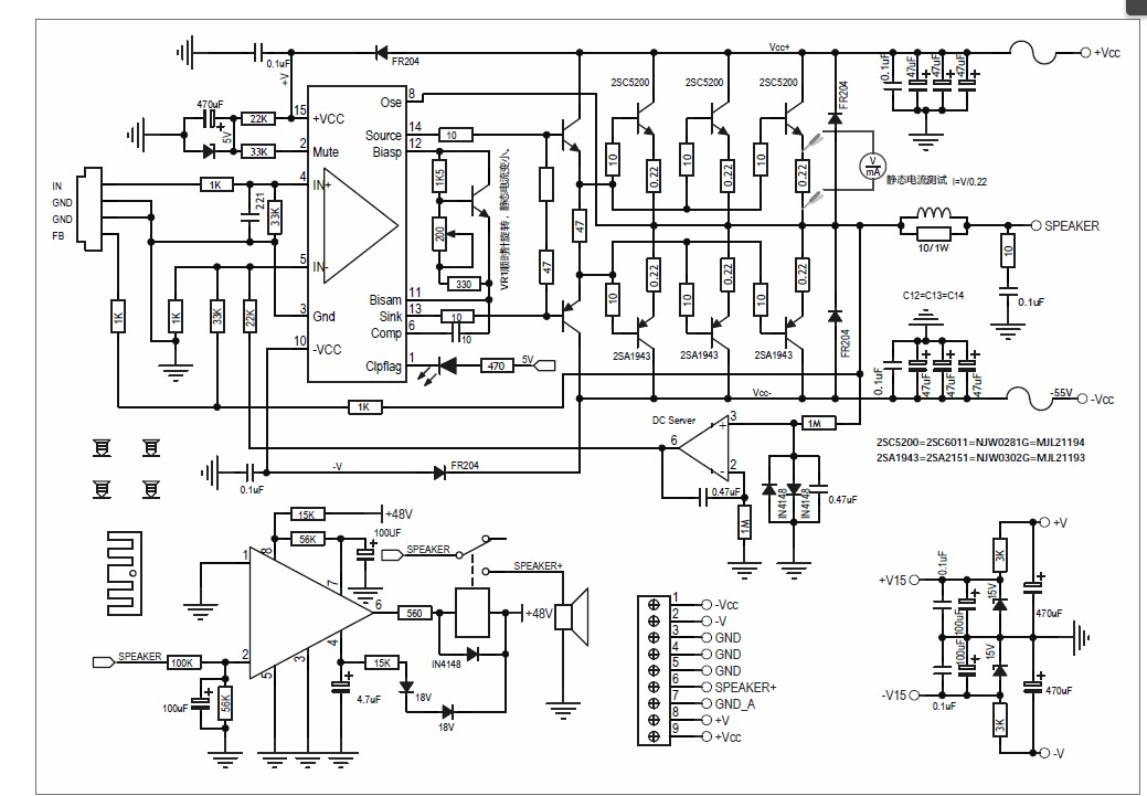

So taking for example the feedback cap and resistor in my LM3886 amp:
22uF and 1K resistor = 7.2Hz corner frequency.
Is this correct?
(Note: The cap shown below is 47uF but have changed it from a cheap lytic to a 22uF wima MKS2-XL polyester)

This case is different that simple RC lowpass or highpass filters but the equation still works.
First, not considering the capacitors the voltage gain is equal to
( (R57||R53)/R8 + 1 )
where the "||" indicates "in parallel with".
The addition of C22 means that the total impedance of R8 and C22 in series will increase as the frequency decreases. At the frequency where the capacitor's reactance equals the value of R8, the value in the denominator of the equation above is sqrt(2) times larger.
This is approximately equal to the corner frequency (-3dB)... not exactly because of the +1 term because this is a non-inverting configuration, but close enough.
Along the same lines, the frequency where C73 is equal to the combination of R57 and R53 in parallel will cause another corner frequency. This will be a lowpass because as frequency increases C73 will cause the value in the numerator of the gain equation to reduce.
The equation in previous posts will also work for the highpass at the input formed by C3 and R58.
All of these highpass and lowpass poles are 1st order but they combine with each other. So if set C3 and C22 to the same corner frequency you will have a total of -6dB there and the -3dB point is higher than you initially inteded.
A good value to remember is that by one octave away from the corner frequency the response is still -1dB. So for example if you had 3 high-pass poles in a circuit at 10Hz, you'd get an actual -3dB point of 20Hz.

If you had a single pole filter on it's own, the F-3dB can be predicted and you know that for a passive filter preceded with a near zero source impedance and near infinity load impedance that the Q of the filter will be 0.7 (1/sqrt(2))
If you cascade two passives filter the Q becomes Q1*Q2 ~0.5 if both filter are at the same frequency and meet the input and output impedance rules.
If you cascade three filters then the Q becomes ~0.35.
This is a very wide and slow roll off that extends many octaves away from the individual roll off points. Yes, it'll have F-3dB at the F/2 or 2*F frequency but the -0.1db point will be decades away. The phase shift extends even further.
If the NFB filter sets the pass band of the amplifier then that means that the input filter is passing some low frequency content that will generate a voltage across the NFB cap. This is not good. Ideally you never want any measurable AC voltage across the NFB cap. This is achieved by ensuring that the amplifier passband is determined by the input filter. This is the reasoning behind the scaling of the input and NFB filters, that has been repeated ad infinitum in this thread and others.
