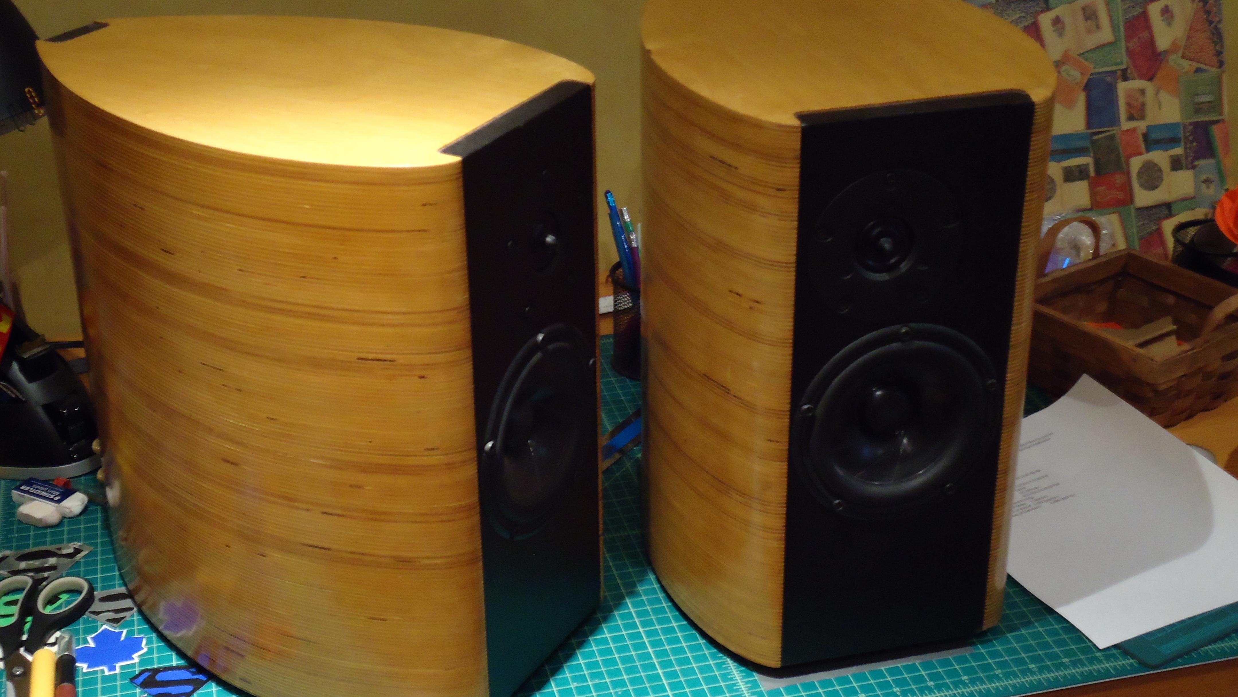

It means that I'm at the point right now where it's relevant to start experimenting with stuffing/lining. I'm not finished with the build. So there's nothing to listen to, at the moment. But the original plans were for a cuboid enclosure, where mine are a much smoother prismatic shape. So, the nature of my question was entirely in regards to my strategy for fine tuning the last little bits.

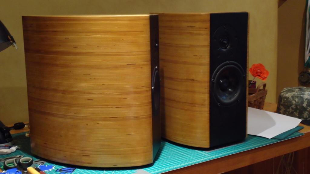

I actually did most of that. The walls are really thick - 1-7/16", to be precise. The bracing corresponds to the woofer, to break up the standing wave, and also to help disperse mechanical vibration. The threaded rods will take the place of my alignment holes when it's all said and done. (they provide the additional benefit of preventing delamination - which has really never been a problem in 10 years on my first translam build) And yes, I did a 1/2" thick aluminum baffle. But I only have a baffle on the front. I just increased the thickness on the back face, instead of adding more metal.
These are sealed, and intended to be used primarily with a subwoofer, but could also be standalone. I'm right in the middle of the recommended volume. Madisound gives a recommendation of .6 to .8 cu ft. on the enclosures, and I'm just a pinch over .7. So, I have some room to play.

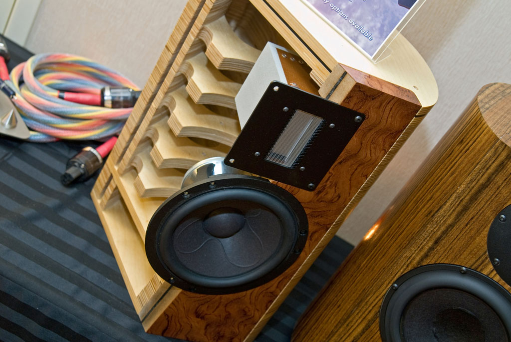

I think we are thinking differently re the threaded rods. It sounds like you are using yours vertically inside the walls of the translam to help secure all the layers together. Which is great - no problem there. Maybe fill any empty space around the rods with sand. Or even look at what Selah Audio did with their Cirrus below, cutting out a cavity in the walls and filling it with sand.
Magico uses their rods horizontally, front to back to secure the front and rear baffles to the cabinet. Given the curve of the cabinet walls and the simple 'X' shape of the bracing, some flexing is inherent in the design so that stiffness is further increased when the front and back are pulled tightly together. The mechanical attachment of front and rear aluminum baffles with the rods may have some benefit in terms of keeping driver mechanical vibrations within that system but I'm nowhere near knowledgeable to say if that's true or not.

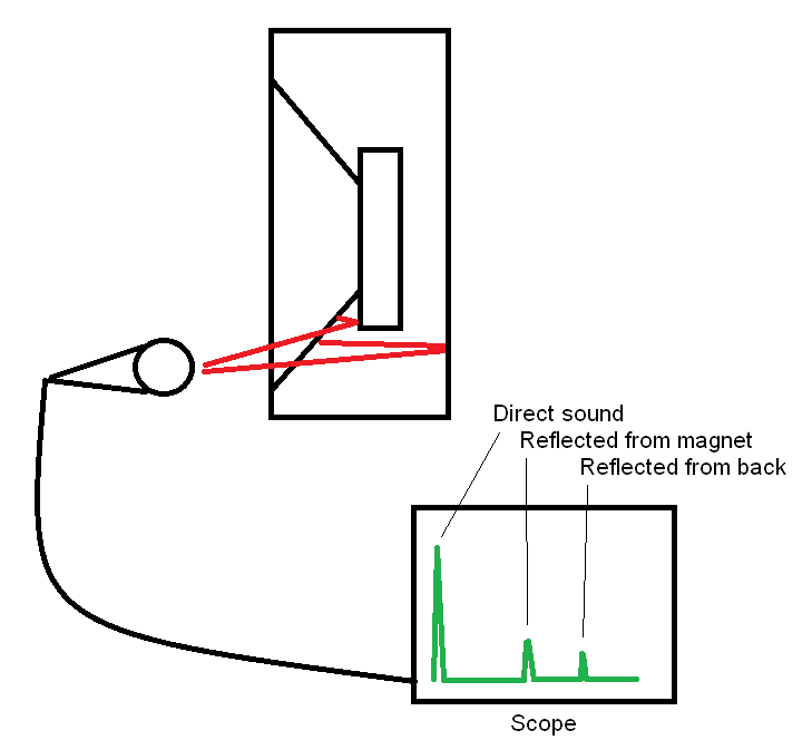

I found a way of testing stuffing/dispersion ideas.
You need a function generator, amplifier, scope and microphone (doesn't need to be high quality)
Connect the function generator to amplifier through a small capacitor (I think I used 10nF)
Set to a low frequency square wave like 0.1Hz and turn the volume up till you can hear clicks from the speaker
Connect mic to scope input and function generator to scope trigger
Point mic at speaker cone
You should see the clicks reflecting off different things inside the box on the scope
(I might have bypassed the crossover for this and just used the woofer - it was a long time ago)
The biggest one for mine was the woofer magnet
Hope that helps,
Brian

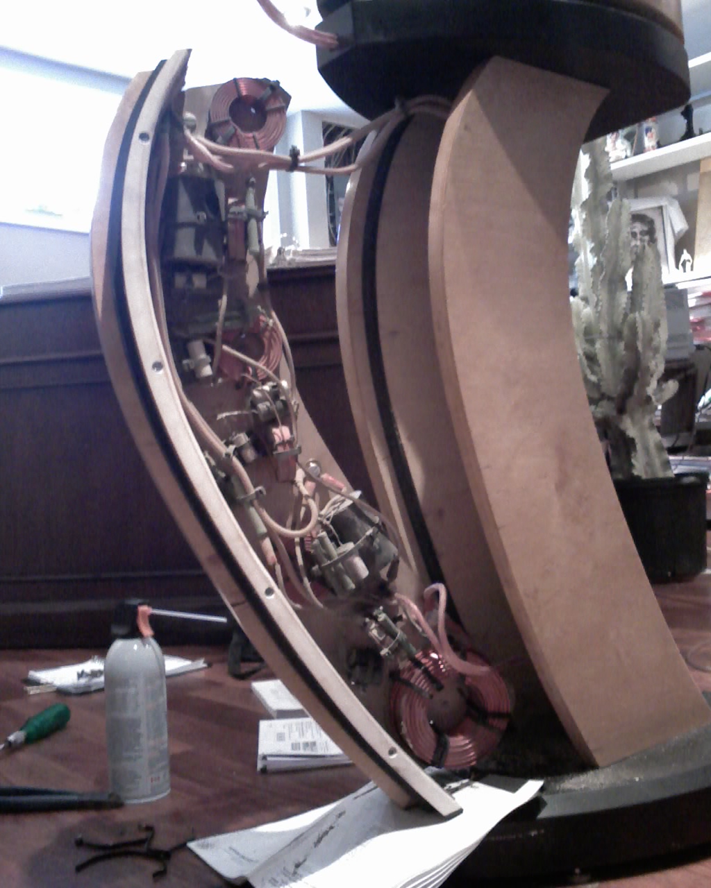

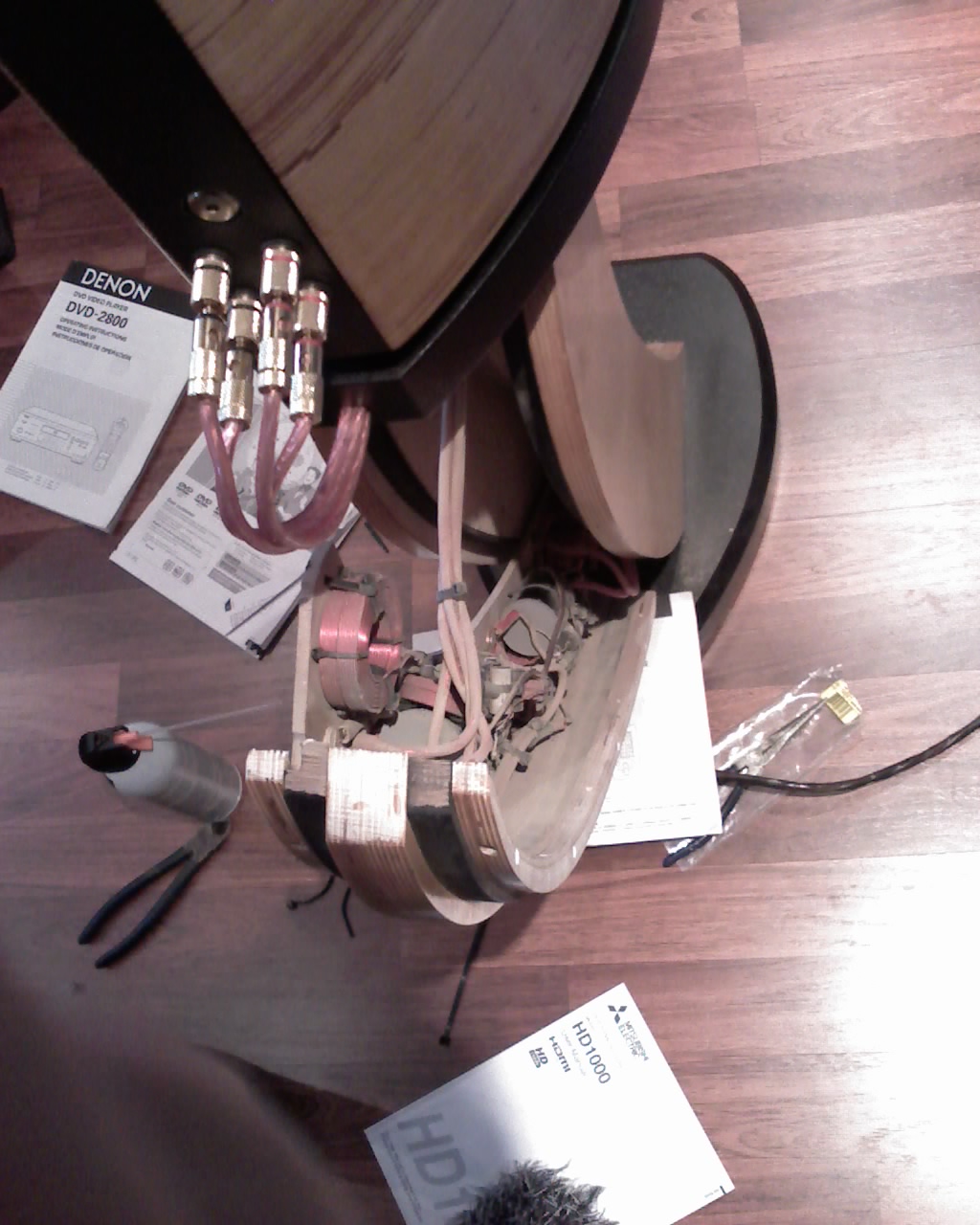

It sounds like you are doing something very similar to what I did (see attached). Walls about 1 1/2" thick, 4 or 5 Magico style X braces (5 or 6? - I can't remember now 10 yrs later), front and rear 1/2" aluminum baffles with horizontal threaded rods but no vertical rods. Xo's are in the stands.
The baffles and cabinet interior got several coats of sound dampening paint (something like QuietCoat) although in retrospect, it's probably only important for the aluminum. The baffles were then painted while the cab interiors got another layer of 1/8" bitumyn pads (or maybe 2, again memory fails me) before stuffing the back, top and bottom with RockBoard and the rest with polyfill, still leaving room behind the driver for it to breath. I stuffed the Roxul into wool socks to ensure no stray fibers would ever get near the drivers.
The results absolutely blew me away, mind you those are rather good drivers to start with. If I did it again today, I would probably make the cabs a little bit deeper and wider to accommodate a little bit more of the RockBoard insulation around the interior perimeter but I wouldn't worry at all about some kind of interior convoluted wall surfaces.
Hope that helps.

I like the crossover placement. I think I just might do that. At the very least, it will retain maximum volume in the cabinet for whatever sonic treatment I need to do.

Clicks sent to the speaker travel direct from the front of the cone to the microphone and also from the back of the cone inside the cabinet. These are reflected off anything in the box and come back through the speaker cone. A microphone can pick these up and a scope can display them. Hope that's a bit clearer - I'm not great with descriptions
Smartphone microphones are generally excellent, so I wouldn’t worry about that. Just tried SignalScope X on iPhone and it looks like it would do the job from a measurement point of view. Just got to find a way of generating clicks. I am traveling for a while, so can’t test unfortunately
