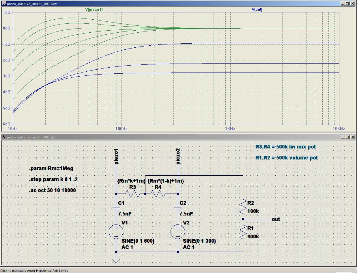

Leaving the balance pot, but eliminating the volume control - and saving the 10M input, what does that do to the simulation?
It doesn't work well - this gets you a permanent 50:50 pickup mix. If the mix pot has far less resistance than the load, it doesn't attenuate either pickup output, no matter where it's set, so it's almost the same as just wiring the two pickups in parallel directly.
I tried replacing the 500k volume pot with a 10M pot and simulating that, and sure enough, there is barely any mix range, only about 0.1 dB.

But 7.5 nF is already useful...I plugged that value into the LTSpice simulation, and with both pots (mix and volume) increased to 1 Meg, things look usable - screenshot attached.

Well, it looks like the circuit Enzo suggested will work, with a couple of 1M pots, or one 1M linear "Mix" pot, and one fixed 1M resistor, if you don't need to turn down the piezo signal.
There isn't a huge amount of mix range, but hopefully sufficient for your purposes. The only way to get more mix range is to also increase signal loss (insertion loss), by reducing the resistance of the "Volume" pot, so the goal is probably to have just enough mix range for your preferences.

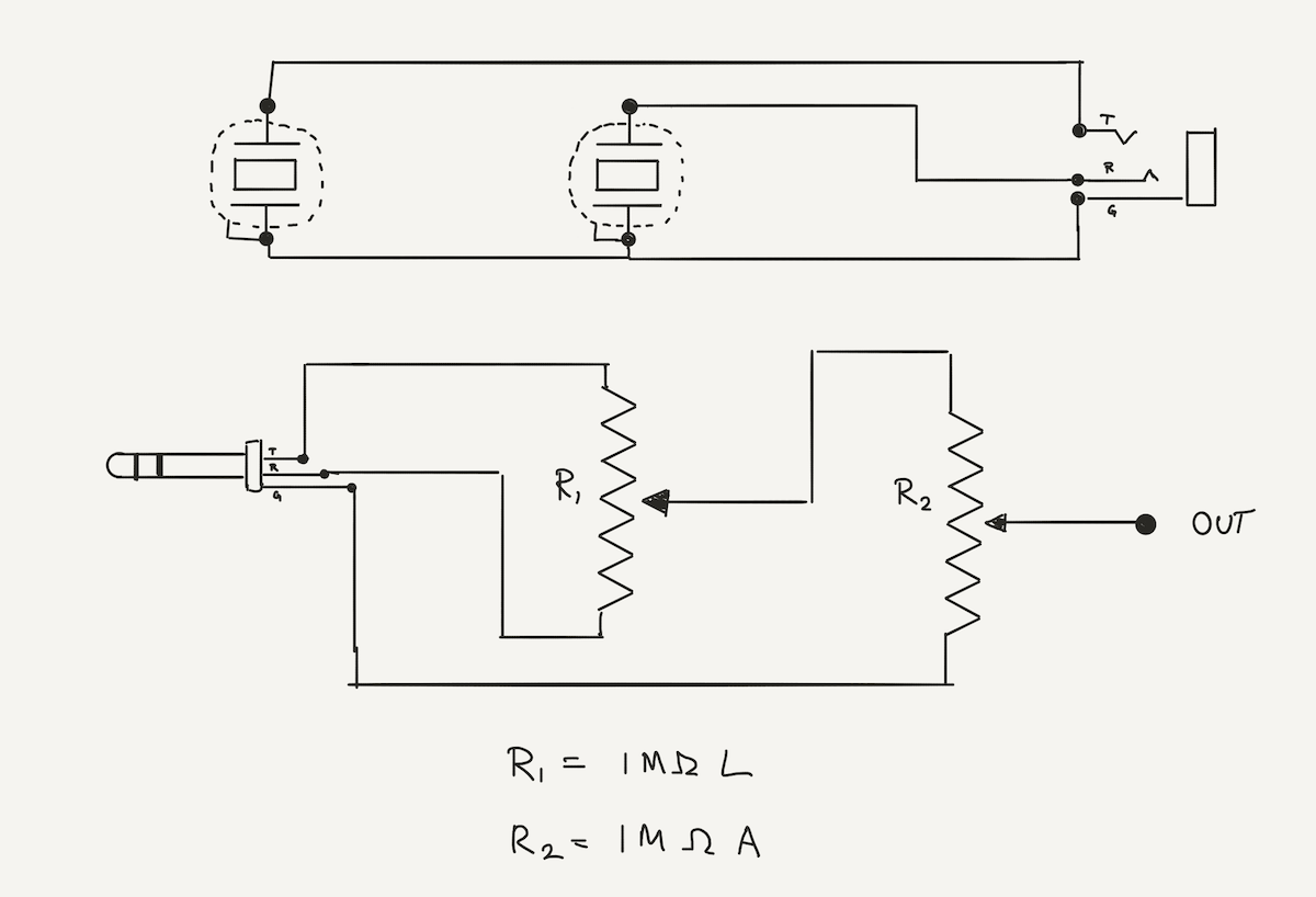

I have a custom "stereo" cable that assuming I got the concept right, means I could have the resistor circuit hidden in the tailpiece of the bass (see attached)

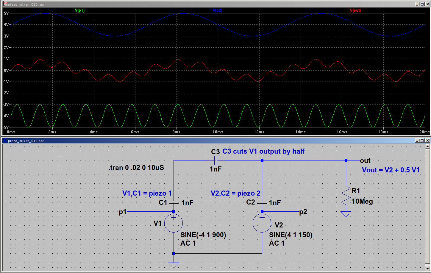

I worked out the math, and did the calculations. Both rows of data above give me the same answer: the sensor capacitance is 1 nF.
(1.02 nF if we're being fussy, but we can't trust those extra digits, as attenuation was only measured to a half-dB accuracy. So 1 nF it is.)
Now, 1 nF sensor capacitance is ten to twenty times lower than I was originally expecting. This is cause for a complete re-think. There is no potentiometer on the market with a big enough resistance to use with 1nF sensors, on a double bass, in the circuits we've been considering on this thread. A completely different approach is required.
To maintain bass response down to 40 Hz from a 1 nF sensor, the preamp input impedance has to be 4 megohms or preferably greater. Since you have a 10 meg preamp, our task now is not to reduce that in any way - we shouldn't be adding any resistors that might reduce the circuit impedance below the preamps 10M input impedance.
I do have a solution for you, and on the one hand, it is very simple. On the other hand, it is going to be a little bit of a pain in the behind!
The solution is to add a small capacitor in series with the output from ONE piezo, before paralleling the two piezo outputs.
For example, if you added a 1nF capacitor from the output of sensor V1, then joined the far end of that sensor directly to the output of sensor V2, you now have a mix in which the output of V1 has been halved (-6 dB), while the output of the second sensor V2 is unaffected. So this capacitance creates an output mix where V2 dominates, and V1 is weaker.
The bad news is that if 6 dB is not the attenuation you want, the only way to change it is to remove the 1 nF cap, and replace it with a different one. The smaller the cap, the weaker V1's otuput will be in the mix. If you use 470 pF, the output of V1 will be even weaker in the mix.
If, on the other hand, you used, say, 2.2 nF, V1 would be mixed in less than 6 dB down; it would still be weaker than V2, but only by some 3 dB.
The good news is that there are not that many values of capacitor between 470 pF and 2.2 nF, so it won't cost much to buy one of each, and just try them until you find what you need. The values you're likely to find available are 470 pF, 560 pF, 680 pF, 820 pF, 1 nF, 1.2 nF, 1.5 nF, 1.8 nF, and 2.2 nF. You don't need to buy every one, every other one is probably fine enough steps; say 470p, 680p, 1nF, 1.5nF, 2.2nF.
The attached screenshot shows an LTSpice simulation of this idea. V1,C1 is the first piezo; V2,C2 is the second. C3 is the 1nF external capacitor, wired in series with the output of V1, before adding that to the output of V2.
The green trace shows the raw output of V1 if nothing else were connected to it. The blue trace shows the same for V2 (I changed the frequency so you can easily tell V1 and V2 apart.)
And the red trace, of course, is the output, at the point where the direct output of V2 is joined to the through-the-1nF-cap signal from V1. You can see that the output of V1 has been halved in the mix - the high-frequency wiggles are only about 1 division in amplitude, instead of 2 divisions like the green trace.
Don't worry about magic capacitors with "good sound" - there is no such thing. I wouldn't use ceramic capacitors for this application, however, because they can be piezoelectric themselves, and might make thumping noises through your amplifier! So, use any type of film cap - Polyester, Mylar, whatever, it doesn't matter. A 50V rating is certainly adequate, more won't hurt if you can't find 50V caps (but don't buy caps rated for high voltages like 630 V, as they will be physically huge!)

I've installed a few Piezo's in upright basses and it is certainly very tricky to
get an even natural sounding response.
There are a few options.
- The stereo jack OP with separate feed from each piezo is a good way to go
I don't think using a 1M passive potentiometer level control after each is the
best idea, depending on the OP level, the pot could introduce significant noise
purely due to the high value of resistance (Johnson noise) and the piezo
really wants to see a very high impedance for best sound. IME, an
active buffer fed directly from the piezo will give the best results.
- Another option is to make a dual active buffer + level control in a tiny box
with a single 9V battery. This can be mounted to the Bass with velcro etc.
FWIW, I've usually obtained best results using just 1 piezo and play with
the mounting location. How and where is your Piezo attached to the bass?
This makes a massive difference to the sound.
