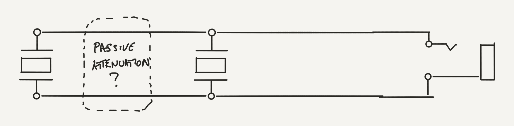

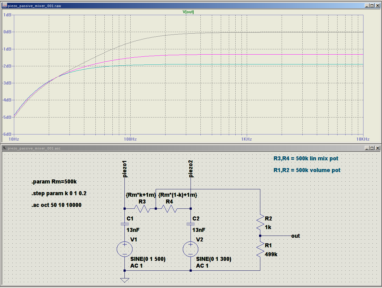

It doesn't work well - this gets you a permanent 50:50 pickup mix. If the mix pot has far less resistance than the load, it doesn't attenuate either pickup output, no matter where it's set, so it's almost the same as just wiring the two pickups in parallel directly.Leaving the balance pot, but eliminating the volume control - and saving the 10M input, what does that do to the simulation?
I tried replacing the 500k volume pot with a 10M pot and simulating that, and sure enough, there is barely any mix range, only about 0.1 dB.

If this is true, the capacitance will be much less than a flat disc. The biggest-value pots we can buy these days are 1M, and if the pickup capacitance is too low to work with these, then your only choice is to use fixed-value resistors (chosen to tweak the pickup balance to suit your preference.)...a thick crystal...instead of a flat disk piezo.
Your other comment that using an input impedance between 1M and 10M varied the bass response is also of some concern. With a 10nF or more piezo disc, there is still full bass response below 40 Hz even with a 1M input impedance, so you won't hear any bass change in reducing the pickup input impedance from 10M to 1M.
(However, really low frequency thumps and bumps - the sort produced by your hands on the instrument - will be removed, even with a 10nF or more pickup, by reducing input impedance to 1M. Perhaps that's what the musicians who tried this heard?)
So, in short, we don't know. And we're really working entirely blind until you know the capacitance of the pickups. 🙁

But 7.5 nF is already useful...I plugged that value into the LTSpice simulation, and with both pots (mix and volume) increased to 1 Meg, things look usable - screenshot attached.

Well, it looks like the circuit Enzo suggested will work, with a couple of 1M pots, or one 1M linear "Mix" pot, and one fixed 1M resistor, if you don't need to turn down the piezo signal.
There isn't a huge amount of mix range, but hopefully sufficient for your purposes. The only way to get more mix range is to also increase signal loss (insertion loss), by reducing the resistance of the "Volume" pot, so the goal is probably to have just enough mix range for your preferences.

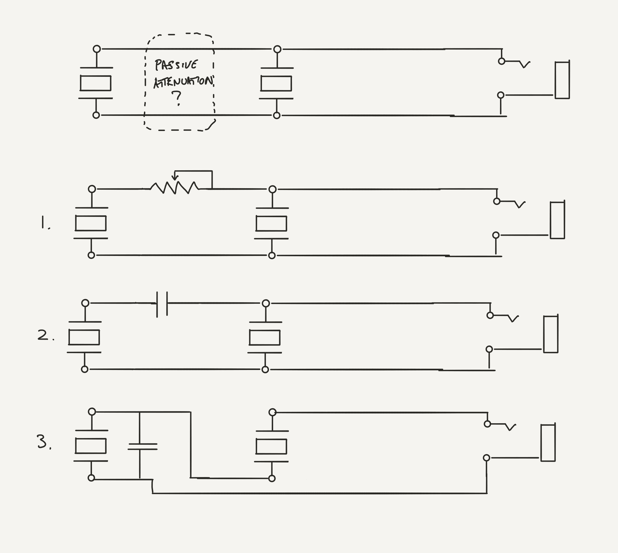

I have a custom "stereo" cable that assuming I got the concept right, means I could have the resistor circuit hidden in the tailpiece of the bass (see attached)

I do have a solution for you, and on the one hand, it is very simple. On the other hand, it is going to be a little bit of a pain in the behind!
The solution is to add a small capacitor in series with the output from ONE piezo, before paralleling the two piezo outputs.
For example, if you added a 1nF capacitor from the output of sensor V1, then joined the far end of that sensor directly to the output of sensor V2, you now have a mix in which the output of V1 has been halved (-6 dB), while the output of the second sensor V2 is unaffected. So this capacitance creates an output mix where V2 dominates, and V1 is weaker.
The bad news is that if 6 dB is not the attenuation you want, the only way to change it is to remove the 1 nF cap, and replace it with a different one. The smaller the cap, the weaker V1's otuput will be in the mix. If you use 470 pF, the output of V1 will be even weaker in the mix.
If, on the other hand, you used, say, 2.2 nF, V1 would be mixed in less than 6 dB down; it would still be weaker than V2, but only by some 3 dB.
The good news is that there are not that many values of capacitor between 470 pF and 2.2 nF, so it won't cost much to buy one of each, and just try them until you find what you need. The values you're likely to find available are 470 pF, 560 pF, 680 pF, 820 pF, 1 nF, 1.2 nF, 1.5 nF, 1.8 nF, and 2.2 nF. You don't need to buy every one, every other one is probably fine enough steps; say 470p, 680p, 1nF, 1.5nF, 2.2nF.

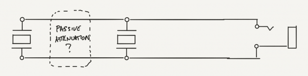

The attached screenshot shows an LTSpice simulation of this idea. V1,C1 is the first piezo; V2,C2 is the second. C3 is the 1nF external capacitor, wired in series with the output of V1, before adding that to the output of V2.
The green trace shows the raw output of V1 if nothing else were connected to it. The blue trace shows the same for V2 (I changed the frequency so you can easily tell V1 and V2 apart.)
And the red trace, of course, is the output, at the point where the direct output of V2 is joined to the through-the-1nF-cap signal from V1. You can see that the output of V1 has been halved in the mix - the high-frequency wiggles are only about 1 division in amplitude, instead of 2 divisions like the green trace.
