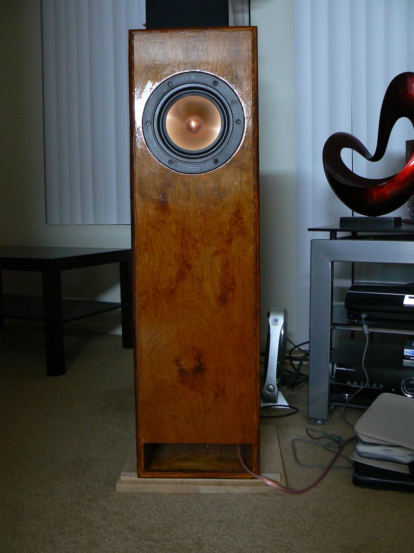

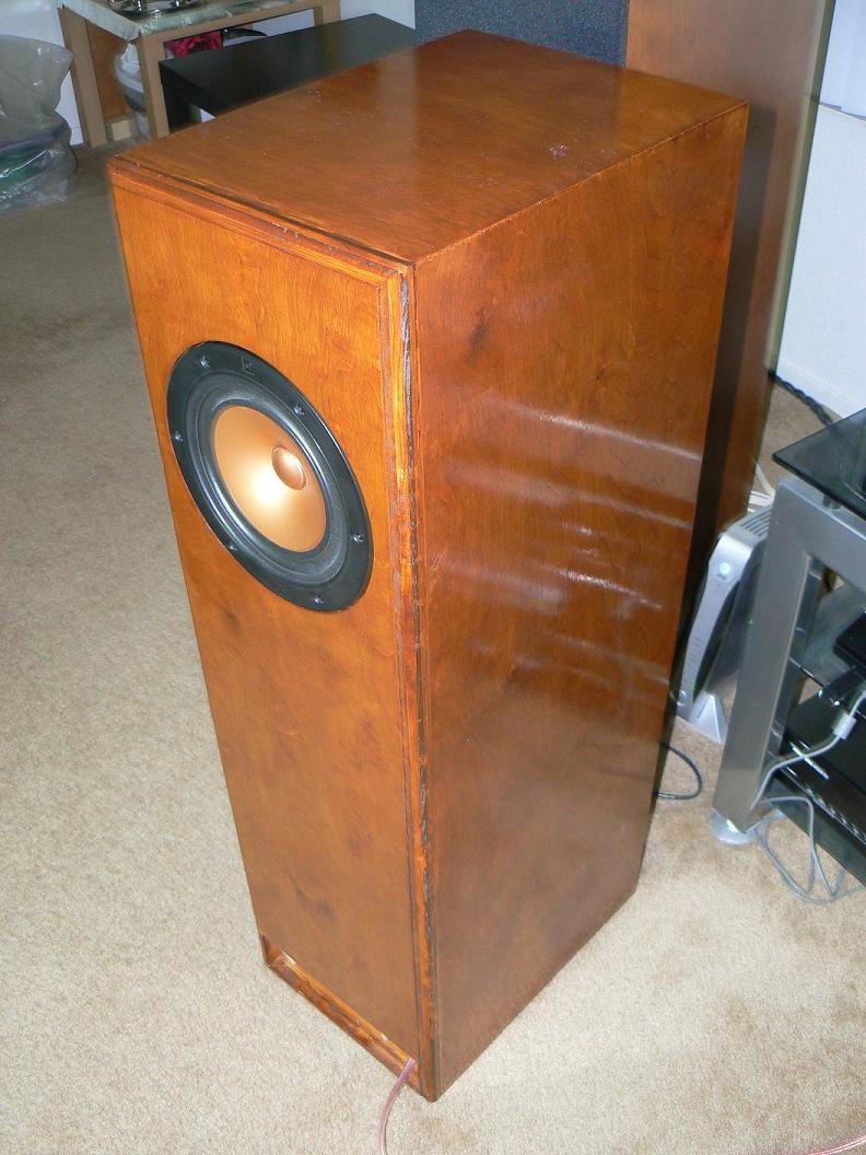

Hi Creekkumar,
Excellent work - well done! Wish I could take time out to listen to your system.
Here's a possible suggestions for you. It may help to improve the flow coming from the back of the driver's cone if you open up the mount a little more. The Alpair 12's cone is very sensitive, best try to minimise any wood edge profile that might reflect part of the cone's pressure wave back towards it.
I've Photoshoped your pic to help illustrate my suggestion. Hope this helps

Thanks Mark for you suggestion. The inside circle diameter is 5.75 inches which is outer diameter of suspension where curvature stops and is glued to the frame. The wood thickness is 10 mm after trimming for driver. My only intension was to provide enough mechanical strength to wood by providing enough width and as the internal edge ends before suspension starts theoretically it should not hinder air flow. But I could be wrong, pls let me know where the edge should be in inches to not to effect air movement.

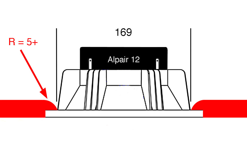

Hi Creekkumer,
Please take a look at the attached pic. You may have a recess profile similar to this illustration? Ideally, its best to have a radius facing out and away from the cone. Depending on the wood thickness but something around R=5-mm is nice. It may be useful to consider opening the cut-out to 6.65 inches (169-mm). This would make the hole size just shy of the legs on the Alpair's frame (as per my earlier pic). But if the music reproduction is clean and clear under load, then its OK to stay as is.

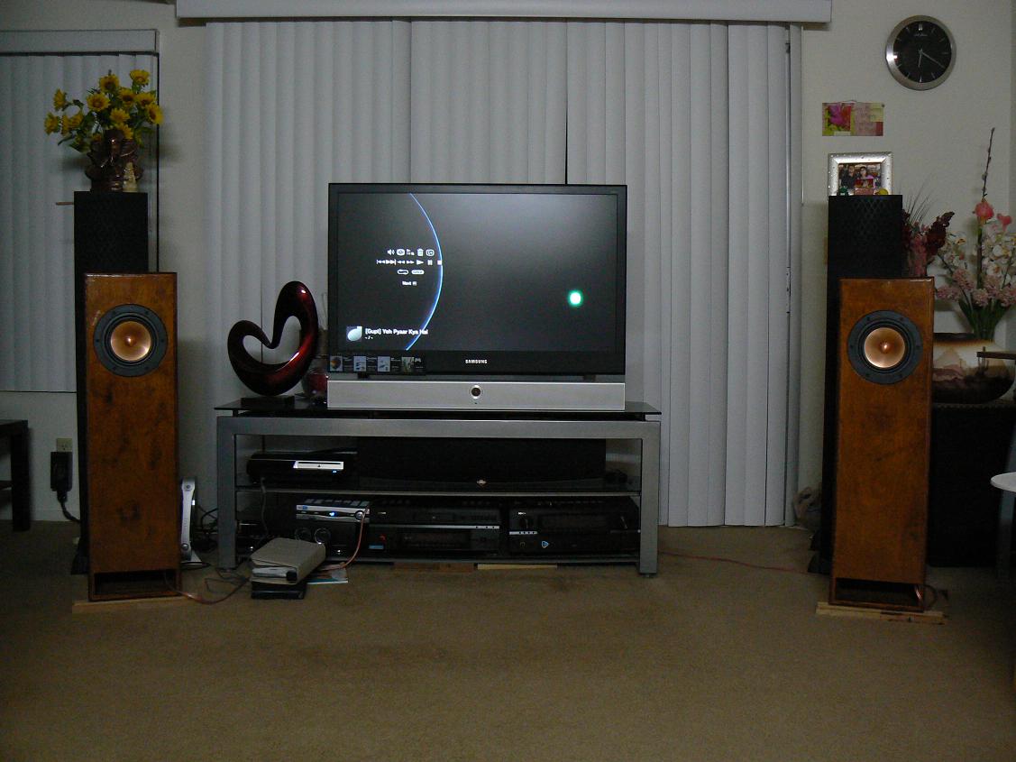

Comparing to my active Klipsch system, it has its own class. In details at top end Alpair has edge. Dynamics is almost equal to Klipsch with Klipsch having the edge. For bottom obviously Klipsch wins but in apple to apple comparison Alpair has more clarity and definition. In imaging both are very good but not the best (not sure if it is my system or my room)
It's amzing that a single cone fullranger has similar or better top end detail and overal dynamics of a multi-way active horn system !! 😱
