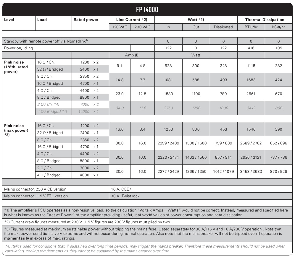

Oh that's the 14KW clone amp with the 120V 15A line cord.
The original Lab Gruppen 14000 manual's power specs section consist of technobabbleand it runs on 230V/16A which is 3680VA. It's really no better, so save the $ and get the Chinese one.
The spec says/means the Po is limited by the mains breaker. It is certainly limited by the power cord melting anyway. It's just another 1000-1500W household amp. If it were a 14KW amp it would need 230VAC @120A. The cord would be just a little bigger.

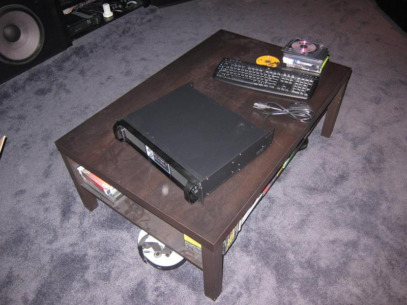

Here's a few shots of the power cord. Apparently it now comes with a larger cord than it used to but I don't know what gauge wire is in there. The second and third pics compare the new cord to the old one.

I do believe it's a good amp design or people wouldn't be buying it or paying so much for the genuine model.
No claim here that the amps can't do the 14K in short bursts, for music purposes.
Don't like the way that short duration peaks of output power are presented in the literature as "continuous".
It's just words but they mean things.
To me, the word 'continuous' means a solid RMS power level sustained indefinitely. I sort of live in the industrial world where certain words are used very strictly.
So I was annoyed, seeing the word "continuous" used in a way I considered inappropriate.

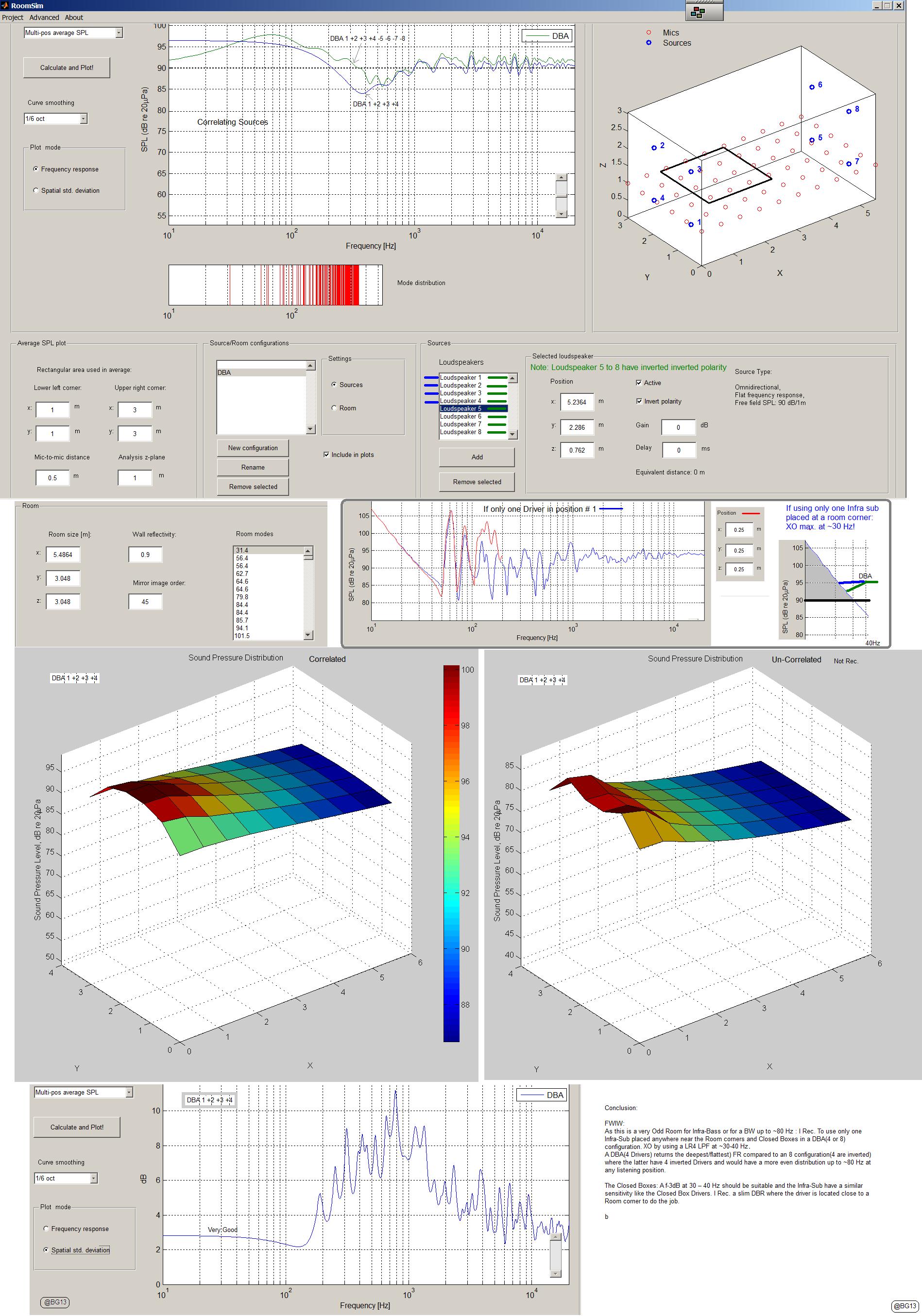

Posting some simulations showing reflex boxes is at least as capable as the Holliman infra speaker for frequencies below the lowest modals occurring in a room.
B
Simulations here. http://www.diyaudio.com/forums/subw...oupled-infra-bass-speaker-10.html#post1051920
Also posts 96, 97, 98 and 100 might be interesting.
I spent this weekend a lot of hours testing this Holliman phenomenon with a real setup (40L box and Peerless XLS 10”) and came to the conclusion that the high efficiency 5 to 25 Hz bandwidth probably is only a myth for this type of infra speaker.
This was back in 2006 when I didn't know anything about anything, and ironically I thought this thing was going to work and you proved it wouldn't. Now you are recommending it and I'm not.
