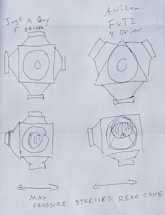

Back in the late 1970's Anicom Sound in Minneapolis used to use a large sealed cabinet called the "Futz" which had 4 drivers on a triangular manifold, three on the sides, one in the back.If used in IB you can fit 5 drivers on an 18 inch cube manifold.
The rear driver consistently was ruptured while the other three never had any problems.
There are tougher cones now (the Futz used JBL 15" woofers) but I still would not put a single cone in the back space of a manifold, even if it would not tear up the cone, it would probably add distortion.

I'm having trouble imagining this layout. A quick search didn't lead to any pics of this creation. Are you saying the manifold exit was at the peak of the triangle (like a pyramid)? If so that's an extremely odd layout and I'm not sure why the manifold exit would be made smaller than the cross sectional area where the woofers mount.
Maybe I'm not imagining it right, but any type of triangular manifold sounds very odd and a very bad idea.
Anyway, afaik only pressure can rupture cones and there shouldn't be any pressure worth noting in a 5 driver IB manifold with a consistent cross sectional area and an exit equal to the cross sectional area. Using a smaller sealed box would be different, that could generate extreme pressures.
I can't imagine why the 5th driver would add distortion. It wouldn't have the benefit of opposed forces that the other 4 drivers have but that's not adding distortion, it's just not benefiting from reduced opposed forces distortion.
A manifold can have just two opposing drivers, or 3, or 4 or more.I'm having trouble imagining this layout. A quick search didn't lead to any pics of this creation. Are you saying the manifold exit was at the peak of the triangle (like a pyramid)? If so that's an extremely odd layout and I'm not sure why the manifold exit would be made smaller than the cross sectional area where the woofers mount.
Normally the back of the manifold is simply a wall, you suggested putting an additional driver there, just like Anicom did with a three sided manifold.
Showco did have a four driver pyramidal arrangement which worked OK around the same time period (probably the inspiration for the Futz), as would a tetrahedral arrangement with only three drivers.
The 3 (or in your suggestion) four side drivers are all pushing air, the air pressure is at maximum in the center. The rear cone is also pushing air, but is also pushing against the maximum concentration of pressure, and is subjected to more pressure than the rest of the cones.
Extreme throat pressure causes cone flex, which causes distortion, even if it does not lead to cone destruction, as it did with the rear driver in Anicom's Futz arrangement.
I have tested many horn loaded units for distortion, the distortion at a given excursion is more than the front loaded counterpart.
A quad loaded manifold gives around a 3/1 compression ratio, higher than many horn cabinets.
After tearing up the rear cones a number of times, if I recall correctly, the Anicom guys put a plate over the place where the cone was, and had no more problems running three drivers. Those JBLs were very expensive, they learned the hard way that the back cone would not hold up.
The cabinet still was a pig though, the efficiency of a large sealed cabinet could not compare to the rest of their horn loaded system.

Thanks, the picture helps, I was picturing some kind of pyramid.
I'll have to think a bit about your explanation of the max pressure buildup in the center before commenting further.

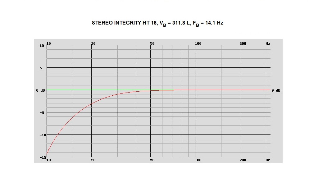

Isn't the size of the enclosure in direct relation to the lowest frequency extension, in this case ~F12=10Hz (80dB - ff, from 92dB). I assume you are using active equalization, can you elaborate. 😕No, the SI 18 doesn't need anywhere near that much space and can't handle even close to that amount of power.

The power I mentioned is just the power needed to achieve max extension (Xmax) and respective SPL, given by the software. I was not looking at any limitations of the driver of max accepted input power or other restrictions. If the driver burns with less power I assume it can not play at max. volume for required output (voltage) of 94.65 V. 🙂
I didn't design the driver and I didn't come up with the enclosure size recommendation. The manufacturer won't honor the warranty if he knows you pushed it past 600 watts, and if the vc burns it was definitely more than 600 watts.
