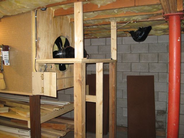

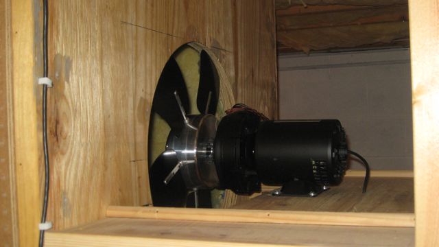

Use a rotary subwoofer and your virtual
pipe organ will sound about as real as it
gets. I couldn't be happier with this
rotary subwoofer!!!!!

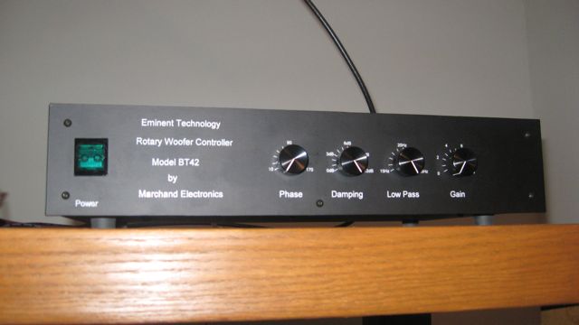

I built the enclosure and modified the floor opening (structural)
and the total cost was $15,000 including the amp that
pitches the blades.
The cost of $21,950 to $25,950 is for the entire project,
which Bruce Thigpen would do (construction, design,
installation and testing.
One needs a very large space for the rotary to vent into,
which I used my entire basement (a small space limits the
output somewhat, not the extension of the rotary.
The amp is designed by Marchand Electronics and is rated
at 200 watts, which is more than enough to pitch the blades
of the rotary sub. The real power comes from the 20 amp
circuit that powers the fan motor. The price was $1200. for
this amp.

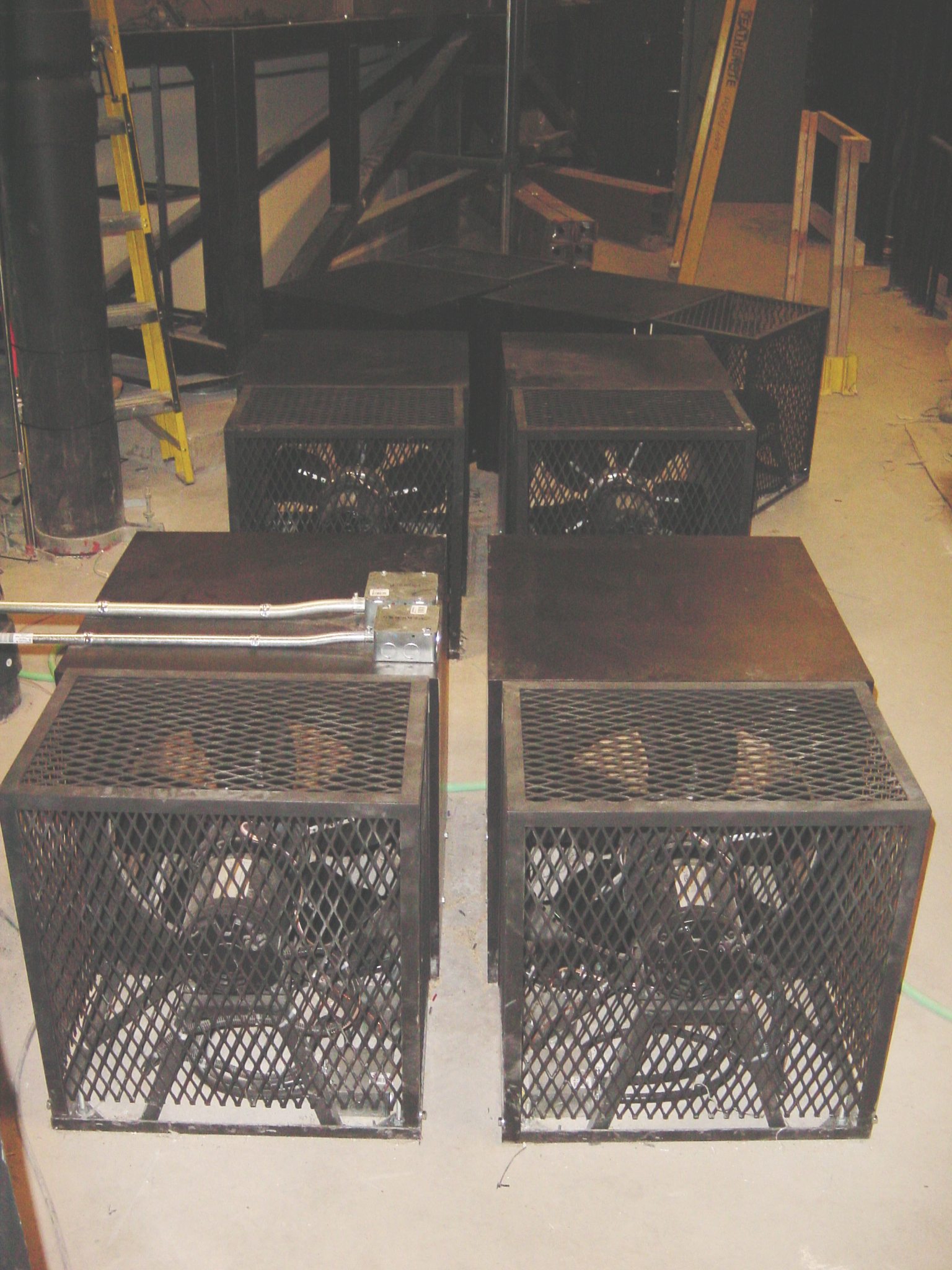

Here's some pics of multiple rotary subs. One domestic, one church, one commercial. (The commercial pic shows 6 subs, link to the writeup is here - Niagara Falls Fury rotary woofer installation )

Those installations, except one are commercial
installations and are huge in size requiring a lot
of subs.

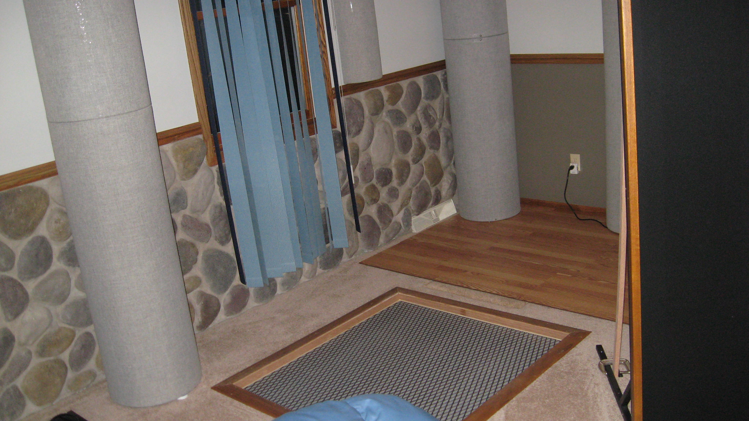

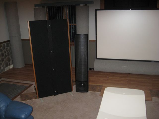

Mine room is 20' wide x 30' long and I use
less than the full output of the rotary sub.
Transient response with rotary sub (below 10 hz
is one of the hardest things to get right, and the
rotary excels in this area.

Distortion is low with the rotary sub and
is a perfect match for my Magnepanar Tympani
IV's (coherence is superb with no apparent
colorations, which one would get with conventional
subs.
