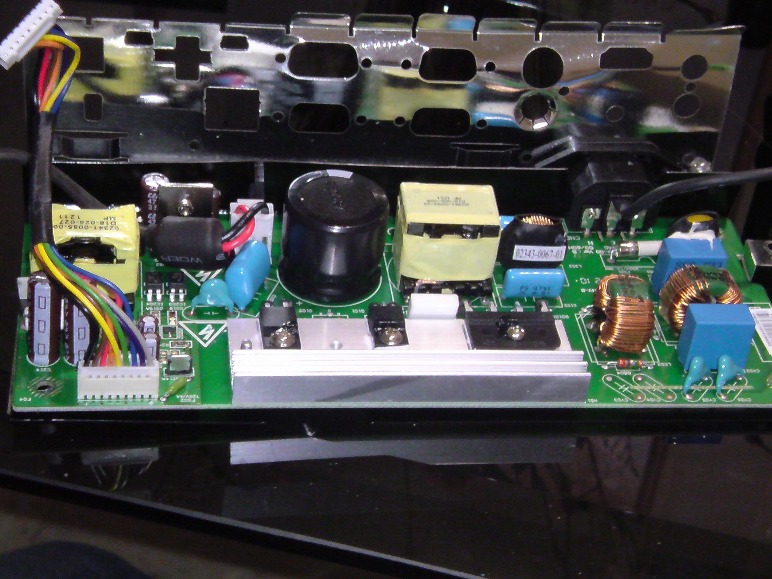

Infocus IN116 no power
anyone??
It's the IN116 model
I have the power supply out right now and with a power cable plugged in I see no voltage over the main fuse.
Where should I check first?
the stuff on the heatsink
k20a60u & fsu10a60 and the bridge rectifier D10XB60b
+ to - on the bridge rectifier I'm getting 164 V
