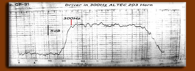

Was backing up my now antique website and noticed some images hiding in the corners. This is one.
From the time before we all used computers to do this stuff...
The observant reader will note +/-1dB across a very wide range - no EQ applied, no smoothing added to whatever the measurement system default was.
