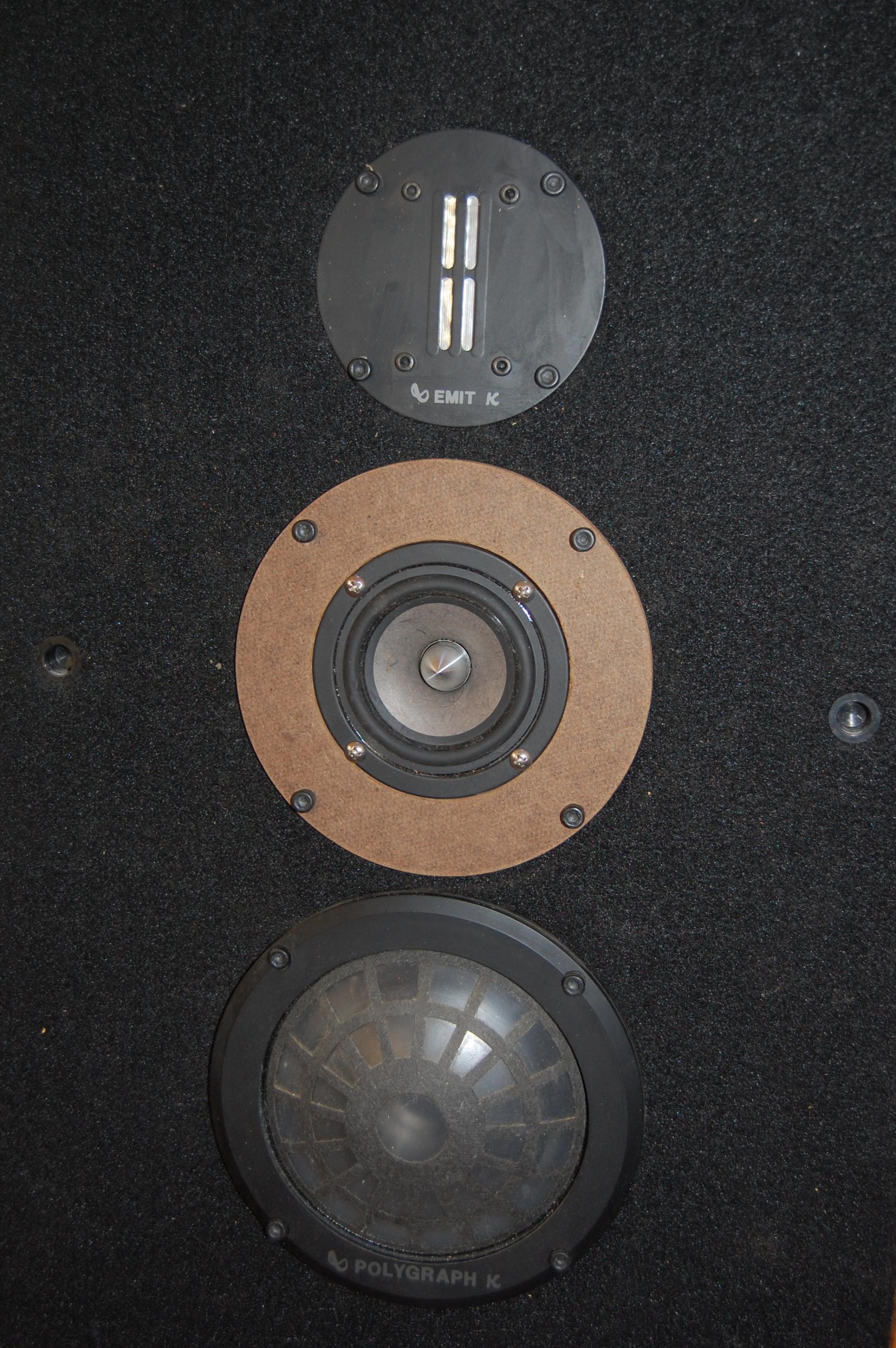

Richard, the midrange drivers have separate enclosures already, so the 3" TB may work.
I really like the presentation of them, so I'll give them a try. This to me, is the fun part of DIY. I only wish that I had a decent polydome to compare.

Just installed a bamboo driver in place of the poly on a home made adapter plate made from Masonite on one of the Kappas. With the controls set on Norm, the initial impression using my iPod into a NAP140 clone is very good. Twiddling the midrange controls bring about a surprisingly big change and one of the pots is scratchy when moving it, but seems OK at the norm position.

Installed the TB 3" driver in the second cabinet, lugged them into the music room, which now looks like a second hand hi-fi store.

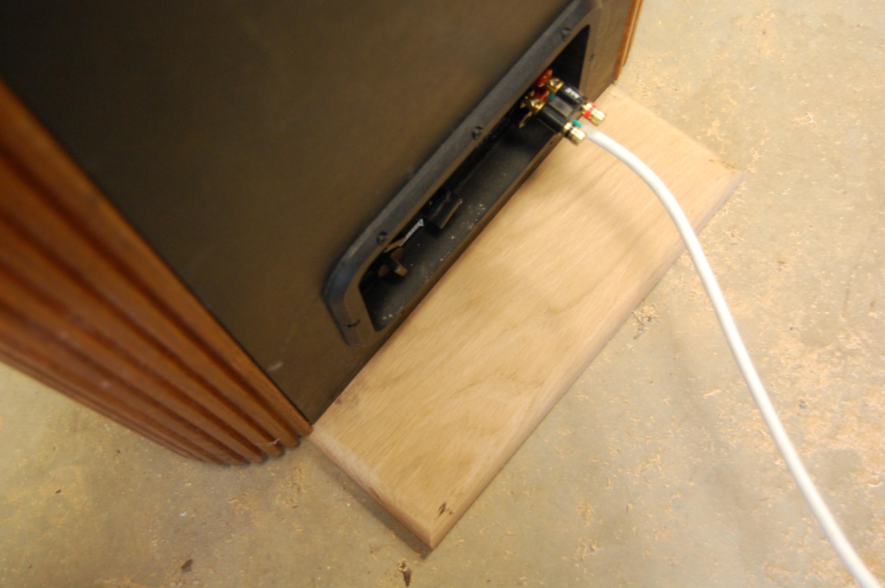

Here are pics of the upper drivers with the 3" bamboo mounted on a masonite adapter. Excuse the dusty polygraph!
Also a poor pic of the solid oak pedastal I made to replace the shoddy originals.
