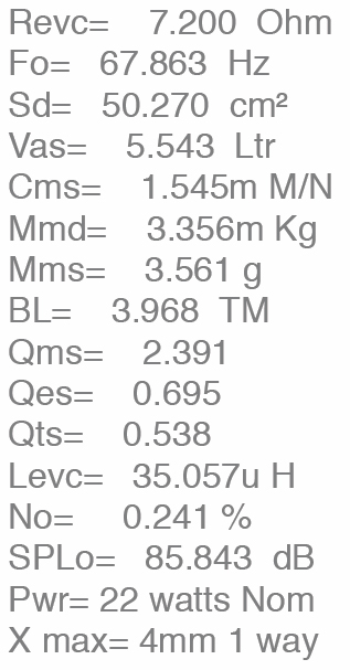

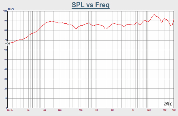

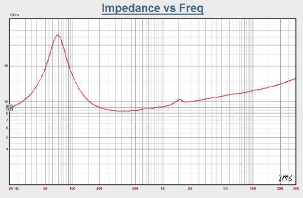

Common to both array designs:
1) Pluvia 7 4" Full Range driver by Markaudio

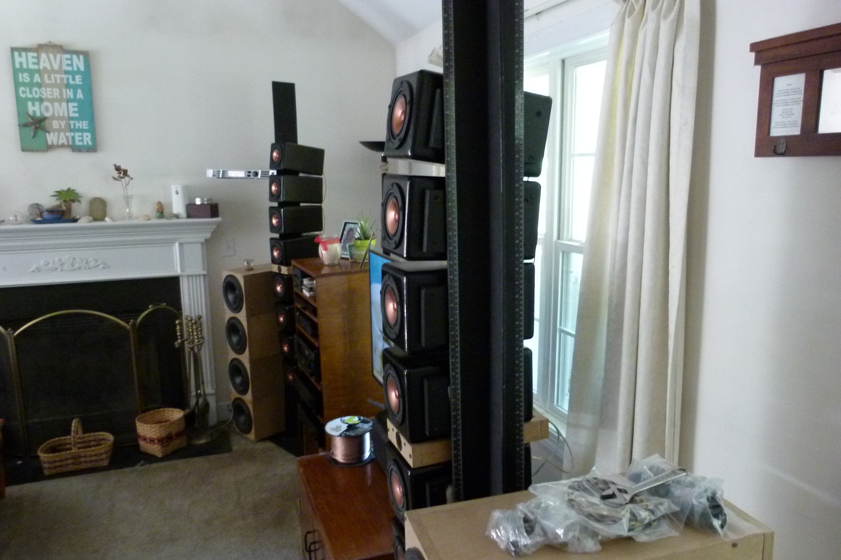

Design #1 uses 8 P7's per side. Each driver in a sealed rectangular MDF enclosure 5/8"(.016m) thick.
Internal measurements on this common enclosure is 9 1/4"(.235m) length, 4 1/2"(.114m) height and 4 1/2" width. Very minimal internal stuffing.
Here is the best pic I have of this setup. Please ignore the tweeter in the middle. I estimate the angle about 15degrees between each enclosure.

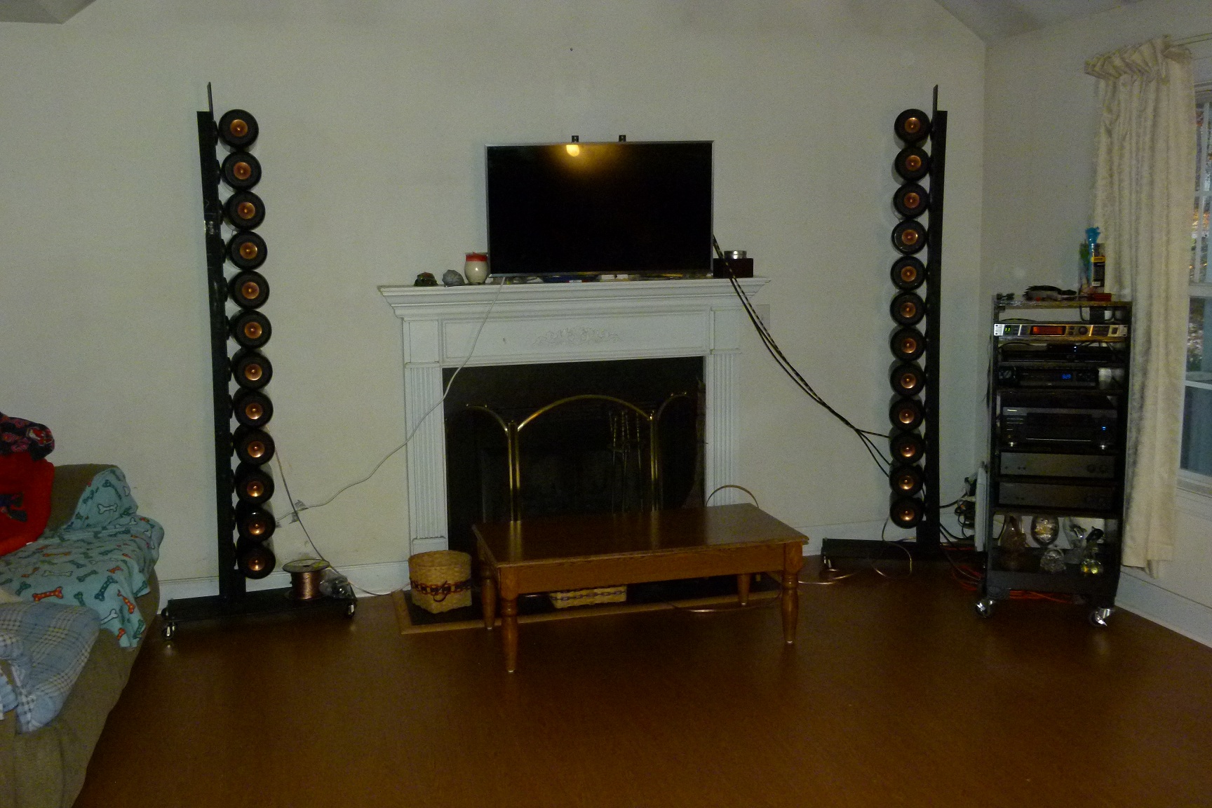

Design #2 uses 12 P7's per side.
Each driver in a sealed PVC enclosure. Some stuffing, loosely packed. I choose it because of the rounded cylinders 2nd best diffraction characteristics. 2nd only to the sphere enclosure.
Front and rear PVC endcaps are rounded internally and externally. Volume is estimated @.1cuft(2.8l). Internal dimensions are approx: 7"(.18m) length x 5.5"(.14m)
Consider this a shootout between cylinders vs. rectangles in a configurable line array. I need some help because while transitioning from 8 rectangles per side to 12 cylinders per side (and changing from carpet to vinyl flooring simultaneously), the sound difference is quite different. I'm not what sure to blame, so need some help 😉 8 New P7 drivers do have about 50hrs break in with still no appreciable difference in sound.

Looking at your pictures it seems the 8 drivers per side system have subwoofer support and the 12 drivers per side system run full range, that difference can have big influence for many reasons.
