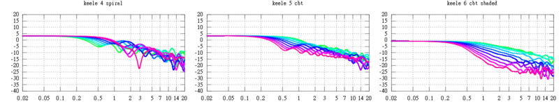

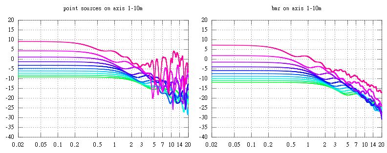

Just coming to this topic, maybe I can help : if you give me the number of (ideal) loudspeakers of the array (16 max or 784 max for continuous arrays), distances/positions (x y z or type like J, CBT,...) and/or delays between each source, I can show the simulated global frequency response at 10 listening positions, so you may compare ie nearfied and farfield responses.
here is an example of arrays for different angles
or other arrays at different distances
I can also send the impulse responses so with any convolution soft, you could even listen to results.
