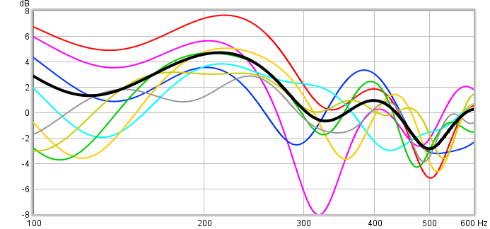

@BRYTT - Ha! Still working on my own bounce problem but its up around 430 Hz and so doesn't affect "feel". Line array is where I might end up if all else fails but going to try taller horns first.
Hoping this thread will address shorter arrays and combing issue quantitatively.
@Wesayso - I don't listen any louder than you but I still feel need for more bass than a single 15" woofer per side can supply. I like to feel the low bass but around 30 Hz I lose corner support due to walls becoming transparent and come up short.
Hoping this thread will address shorter arrays and combing issue quantitatively...
Okay bounce problems are better than mine then because have several of them below 400Hz : )

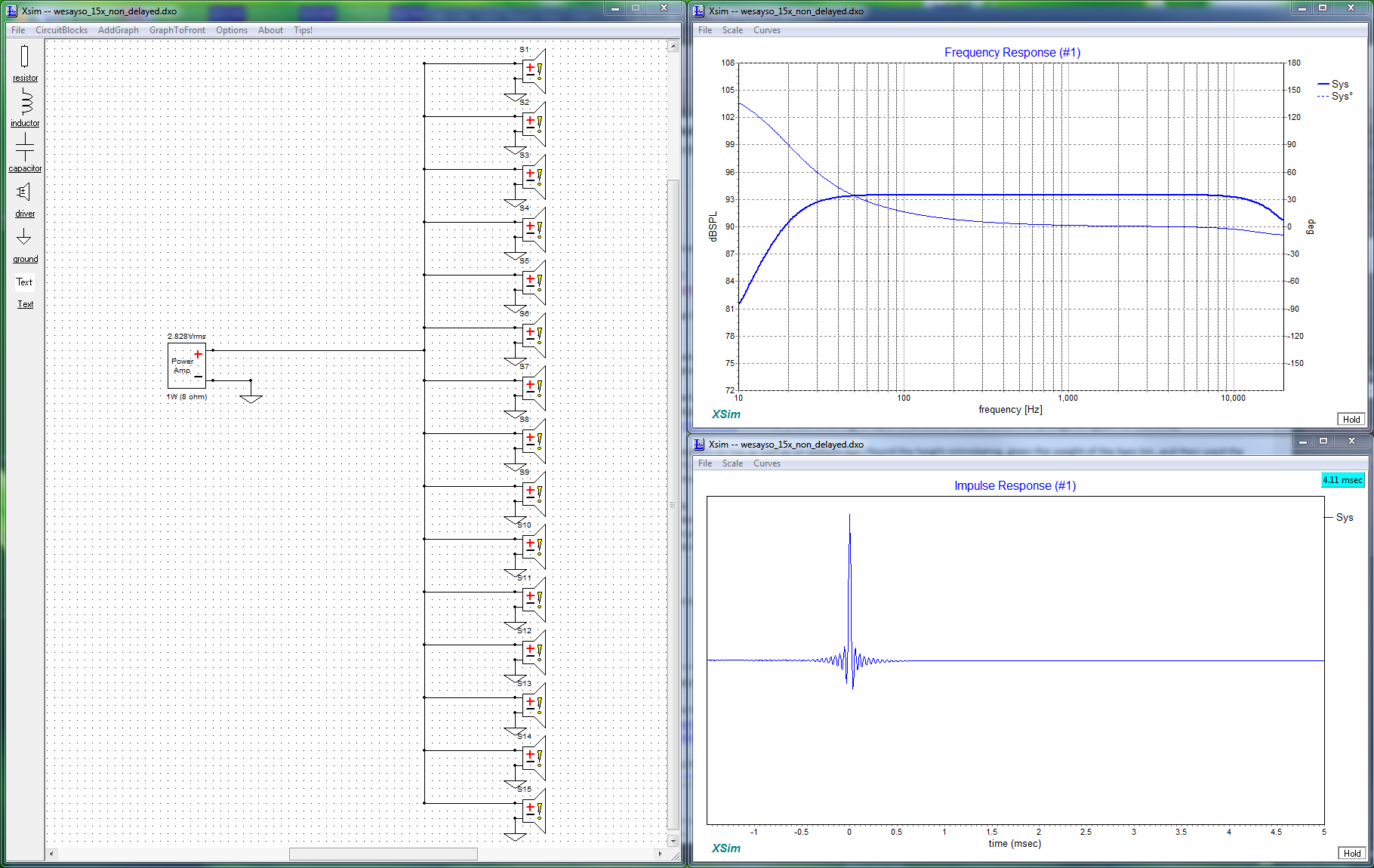

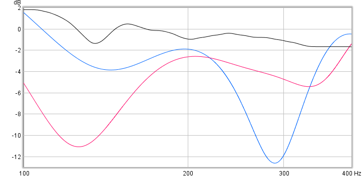

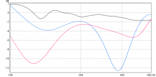

Xsim is not meant for this case but if we take the 15 distances wesayso share in post 237 think we can learn a bit about theoretical direct summing setting up 15 drivers, frd response curve per driver is based a Rephase 44,1kHz IR-file set as 20Hz-20kHz BW2 passband so phase is per 44,1kHz domain relative flat up high, first graph attached below is if all 15 drivers summed with same distance to listener and second one is with the various small delays set per driver. Think it tells say below 400Hz that because both amplitude and phase is not so far between the two models from that point on and lower in frq we should get theoretical good result.
Myself is seriously thinking over try out a compromise array for 400Hz area and down, a compromise because its not covering floor all the way up to ceiling because i can't afford so many drivers and power amps but 8 times of relative small SB17NRXC35-8 should give me 1,5 meter high array and more than enough cone area and displacement than i need for that room so distortion numbers should theoretical get over average good. Here is overlaid individual curves for each woofer height position into 100-600Hz area exported from eight individual Jeff Bagby spreadsheets and think the black average trace show much less error than any of the individual height curves.

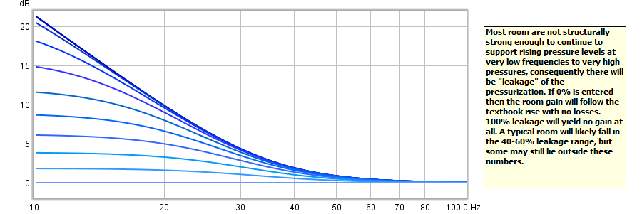

Ha ha probably it sound stupid but does it help close doors and windows especially below 30Hz, graph below is my room size set into Jeff bagby spreadsheet plotting only the room pressurization gain with room leakage set in steps of 10% including the build in spreadsheets guide for this field. Looks theoretical if one can break normal 40-60% numbers there is dB in sight especially at very lows but keep that door closed 🙂.

Good points there but will say for wesayso's case that myself didn't physical see any of the 50 TC9s make visible movement in normal role as a music system, another case for maxed out frequency domain is headphones and think they also can go relative far in quality.

@BRYTT
Yes I have woofer on floor serving 300 Hz and down so obviously no floor bounce. Mine is a corner horn so no boundary interference. Its a more complex situation with conventional speakers out in the room
But an elevated point source will have floor and ceiling bounce which leads to large horn or array or some combination. If doing that, one needs to switch from horn to array while horn still has pattern control. Assuming you get that right, then you have controlled directivity in the horn region and uncontrolled directivity below, which isn't good for power response, unless the horn is 90H and in a corner.
Clever to use XSIM to see combing. I will have to figure out how to do that. What driver spacing were you modelling? Can you change the observation point correspondence from seated to standing equivalent?
Look at SpeakerDave's classic line array paper. The original version has simplified formula for summing spaced point sources that one could build a spreadsheet or program around.
Unfortunately my room has no doors to close. I hoped for room gain when I designed the speakers but it didn't materialize. Recall what Dr. Geddes has to say about room and corner gain.
