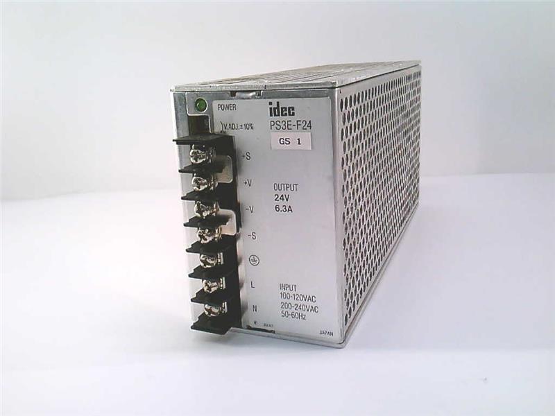

The power supply is an IDEC P3SE-F24, really one of the best in the league. On the output there is less than 15mV P-P noise is visible on a scope. The point is that I tried it with at least 4 different class D amps, (TPA3251, TPA 3255, MA5332 other MA12070), and none of them produced this anomaly even with larger inductance ferrite core filter on the DC cable. On the incoming side it is connected to a WAudio W4000 power line filter/conditioner.

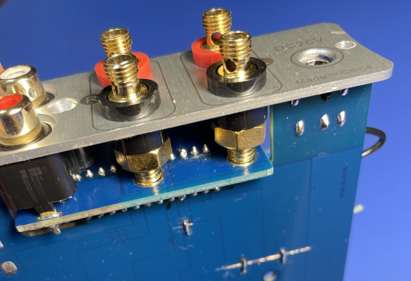

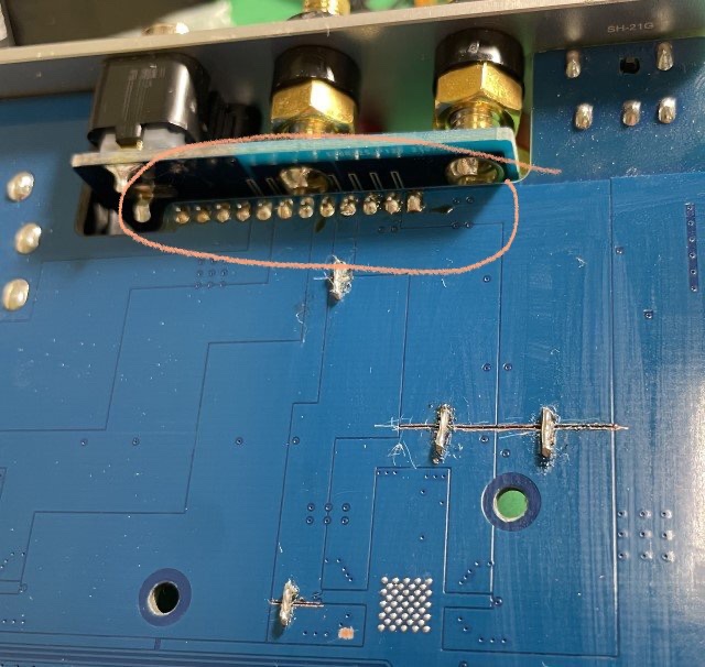

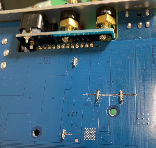

Today I've tried the simplest variant to put ferrites, but there are duplicate conductors on the board in other layers, I had to short-circuit them back. Owners of PA3s, don't try this method
We cant to dismantle rear aluminium panel withouth desoldering that additional pcb with RCA and banana plug connectors. On that board there are no conveniently method to put filter. Think that better solution will be throw away this small PCB, and connect it to mainboard with cables (and solder filter before this cables)
