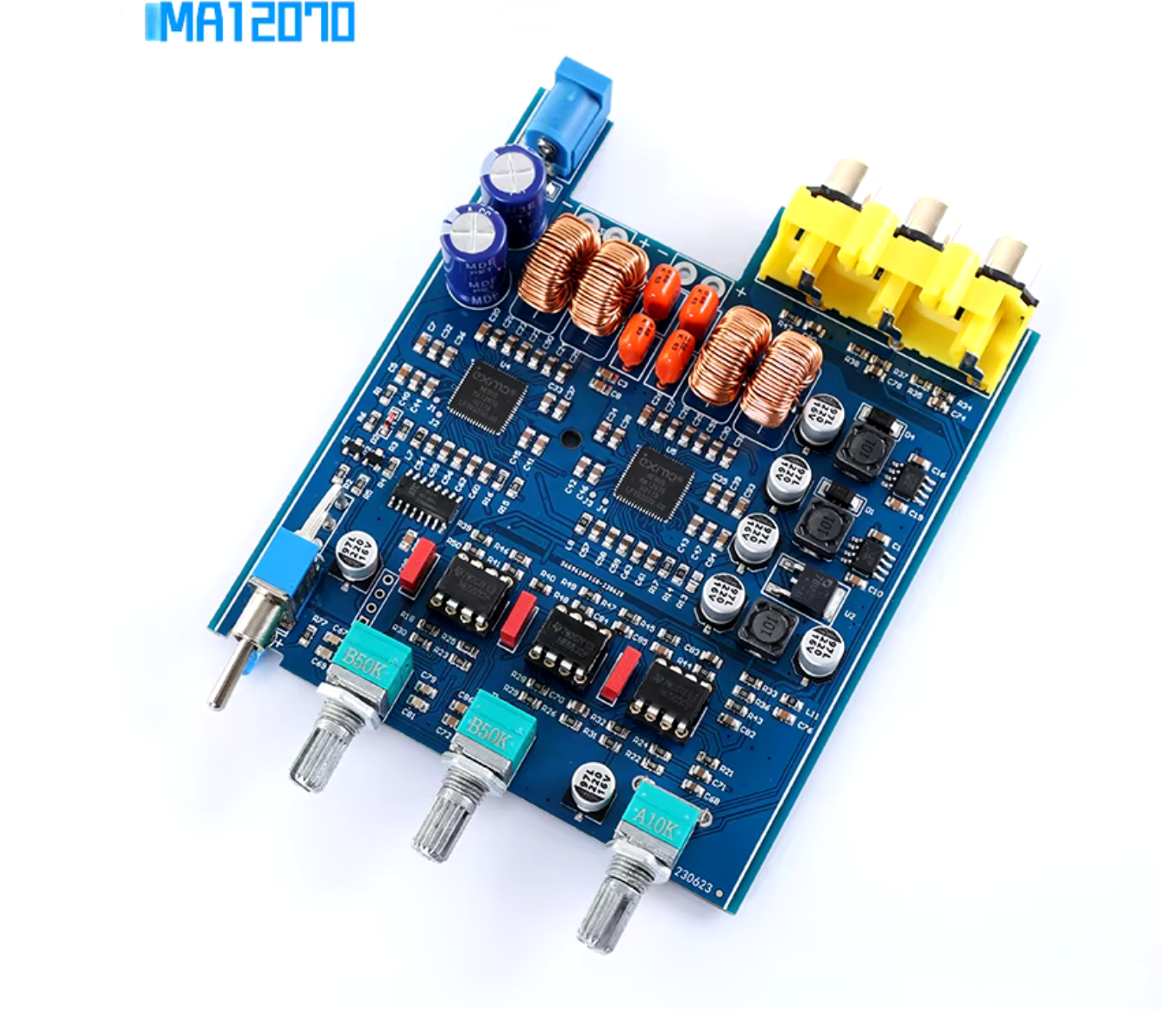

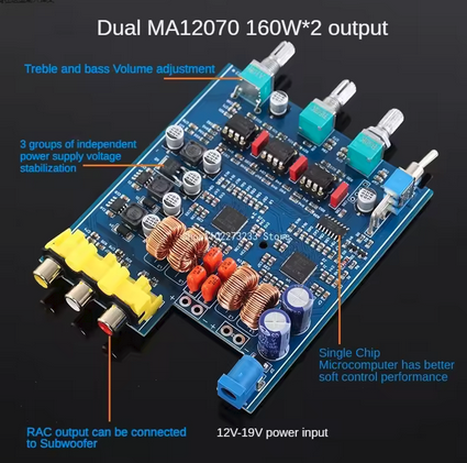

Hello everyone! I read this forum thread. I am very interested in buying an amplifier on this chip. The board shown in the photo has the so-called MСU chip, if I understand correctly it is responsible for changing the volume in digital form and possibly for other controls such as changing high and low frequencies, etc. I wonder, what do you guys think, does this MСU chip already transfer the amplifier to PMP2 mode? I will be glad to any information, since I do not know which board or ready-made amplifier on MA12070 should I choose! Thank you in advance for your answers!Btw I measured this design. Lost of filtrering going on and decent quality on caps and coil
I'd guess the audio flows through the three 8 pin chips on the red sockets. That's why they're conveniently provided with sockets, so they can be "rolled" for different, "better" devices which is an audiophile advantage and selling point. I'd guess its these devices doing any pre-processing of the audio signal, before going to the amps.The board shown in the photo has the so-called MСU chip, if I understand correctly it is responsible for changing the volume in digital form and possibly for other controls such as changing high and low frequencies, etc.
Not knowing anything about the MA12070 and how it works / what it needs to operate, I do know that many of these modern devices dont just power up and play upon being placed in a circuit. They need to be "loaded" first with parameters before they can do anything. That's what the MCU and any associated "boot ROM" does.
Just where the analog input audio gets digitized I'd assume happens in the MA12070 itself. So I'd guess the architecture is Audio in, through 3 op-amps per channel (with their underscored "independent power supply stabilization") and then to the MA12070. The MCU sits off to the side and handles power up/down housekeeping.
It's all a guess; but what else would six op-amps in sockets be doing if not "Treble and bass Volume adjustment".
The world being still so stuck on the analog paradigm, that when these digital devices come out, they need a wrapper to shove that square peg through the round hole. Analog is for Vinyl and RTR tapes if you hold such a collection.
Why anyone would take digitized information, convert it back to analog, only to convert it back to digital is beyond me. Probably because they can understand and handle an RCA line level cable connection, in the same manner as plugging in a TT to the preamp.
MA12070 existe in both an analog and a digital input version MA12070P. The amplifier part is analog in both.
You are right that conversion to analog is not the shortest party from A to B but that is not the habit in audio anyway. People want to roll opamps 😊
