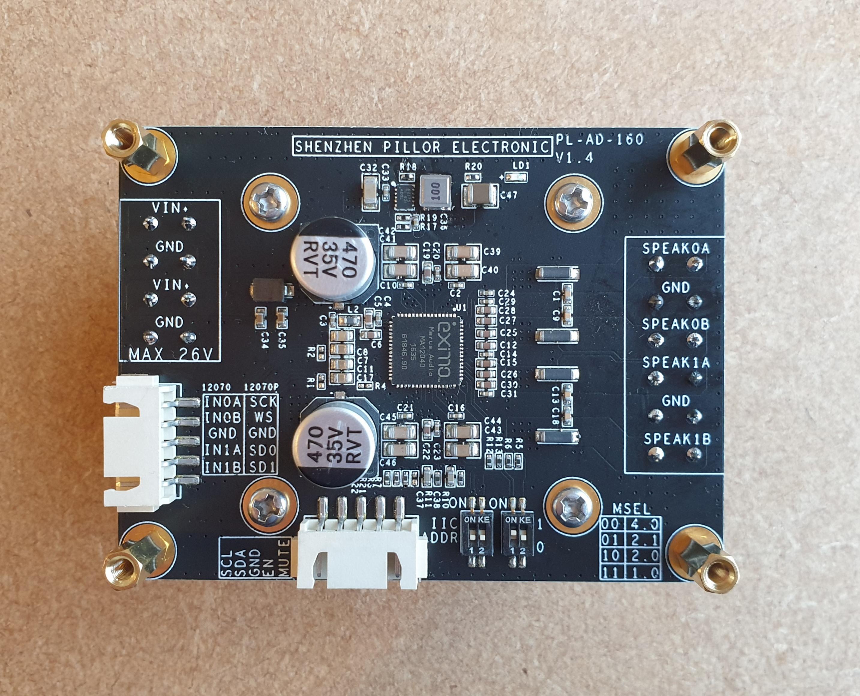

IF YES : I disagree with you, because I have absolutely 0 pop noise when switching ON / OFF neither any input noises when connected in full balance mode (XLR). Tested it via my Double AK4497 Dac and my LG V30 with internal Quad Dac = 0 issues, no noises, no pop... This amp is absolutely dead silence.
I guess our setup is just different, maybe we are using different SMPS PSU, etc etc
As reminder : I am using it in dual Mono Mode with 2 SMPS PSU (one per module) :

This product has no schematics or detailed instructions. When I examined the board, I decided that it was a copy product of the Infineon MA12070 EVM board, and I refer to this manual.
Excuse me, please tell me.
The operation mode setting switch is so small that it doesn't look good to my presbyopia.
Is it OK to remove the thin sticker on the surface and slide it with a very thin stick to operate it? It seems to break easily and is scary.

Toku, yes i removed the sticker and used a tiny flat tip screwdriver to toggle the switches. Is easy, no problem at all.
Today my SMPS reached me and i got the opportunity to try one of the module in the same mode of operation as you - 2 x 80w BTL. Upon powering up, I got a very rude POP, almost a crack sound. Thanks to your warning, this happened to my pair of very cheap computer speakers which i used for testing my DIY projects.
Next, i tried your recommendation to connect a small capacitor (i used 68uf) between mute and GND. Works nicely. However, on some occasions switching Off SMPS and then On again a couple seconds in between will result in a POP. The strange thing is it does not happen every time. I guess it depends on the charging state of the capacitor when power is turned on. However, the initial POP upon power On from the cold state has been effectively removed.
I would like to add that powering down has no POP or thump sound. And i am amazed that this amp runs so cool. hardly can feel the heat.

POP noise prevention capacitors may work better with 100μF than with 68μF. I am currently installing 100μF.
We have tested it by turning the power on and off frequently at various time intervals, and have confirmed that there is no pop noise at 100μF.
I'm currently testing with two units, but I ordered two more. It's a very small unit, but it's fun to play with.
Since the XLR connector arrived, I immediately switched from unbalanced input to balanced input and tested it.
The pop noise when the power is turned on / off is lower than that at the time of unbalanced input, but it appears. As with the unbalanced input, you can completely prevent it by connecting a 100μF capacitor to the mute terminal.
