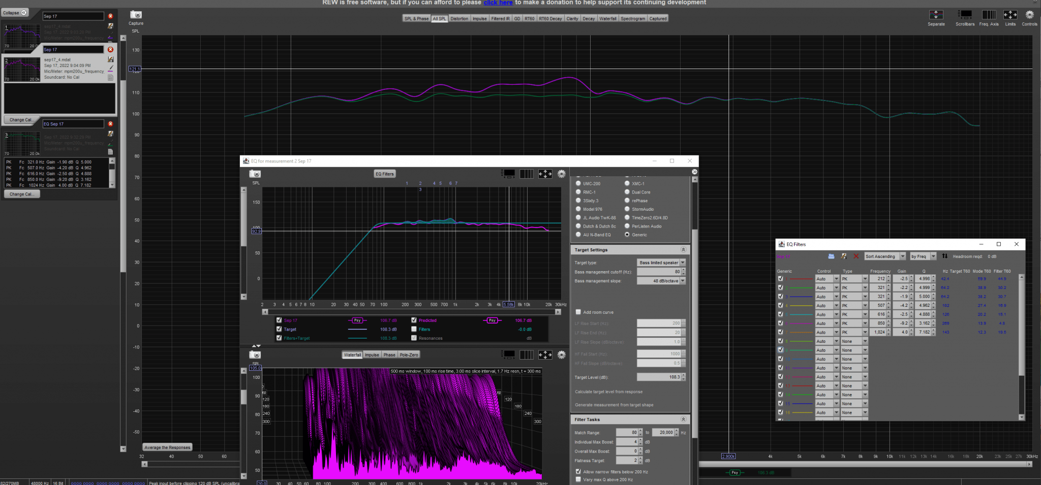

Played with REW and the DBX software and got this. Green line is where I am at so far. If I do a 20db attenuator I can probably use the +4dbV input setting and get more bang for the buck, though pushing the volume past 70% is likely to result in people outside my home enjoying my music as well.

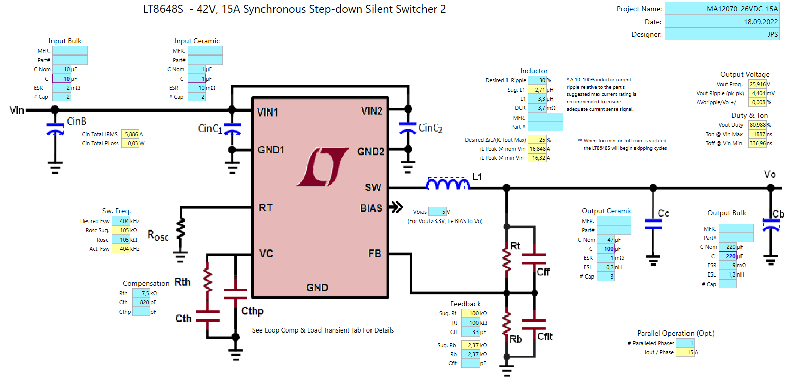

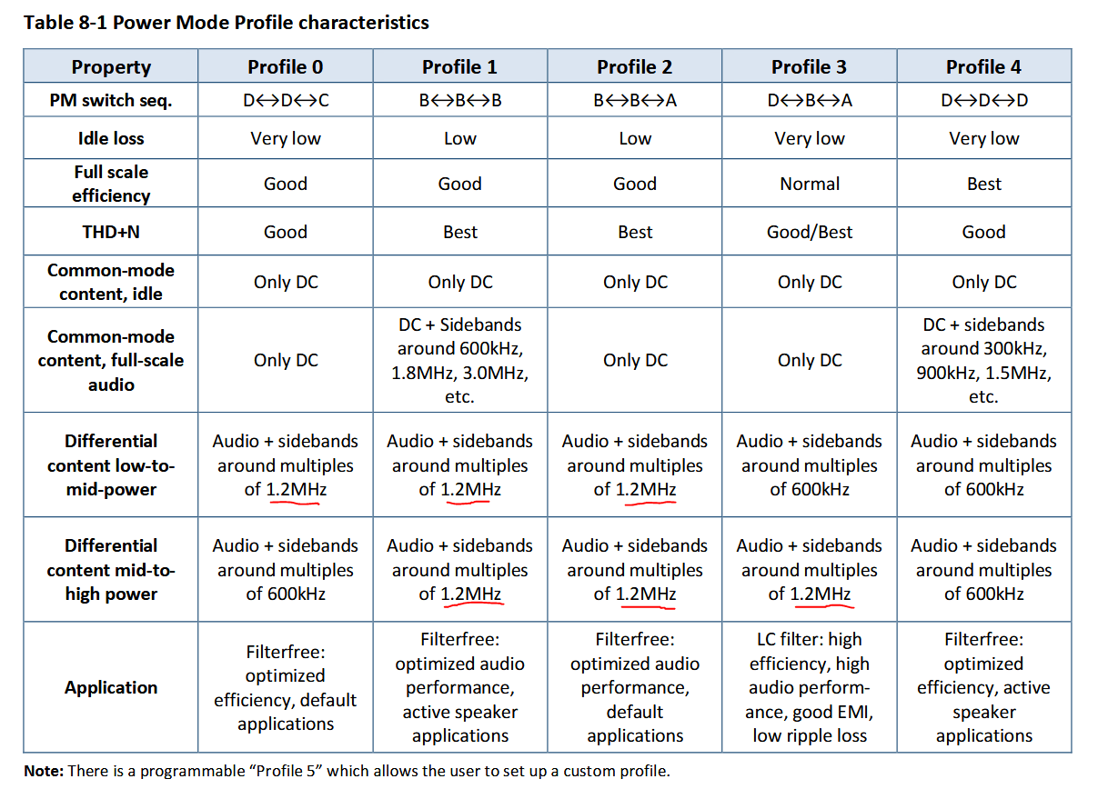

It looks pretty good. I think it's your ver of the low EMI 5V application example, right? I am guessing you will leave the 26V to the discretion of the end user, which I think is a good move. The only thing that bothers me about 400khz switching is the possible interference since most of the power modes have sideband resonance in the 1.2mhz range, which is an integer multiple of 400khz. This may upset sensitive drivers.
The application noted show a 5V 2MHz setup. But what I am curious about is the 1MHz frequency. Looking at Kyocera AVX datasheets for X5R and X7R dielectrics, the lowest ESR tends to be in the 1MHz range. This is also outside of any possible resonance stacking on the MA12070. THe lowest ESr point as a switching frequency may also reduce the ripple even further. Not sure if it would make any audible difference, but numbers bragging is numbers bragging 😛
No one serious would use a 42V 15A capable switcher for 5V 0.25A. Sorry.
Of course this is the switcher for 26V PVDD.
Wow that is so embarrassing. For some reason I thought I read 5V. How did I miss the output voltage notes? Hahahaha. I feel dumb.No one serious would use a 42V 15A capable switcher for 5V 0.25A. Sorry.

it‘s for the bias of the switcher (< 25V@100mA).Option to connect the bias to ground on board, needs to be tested regarding performance.

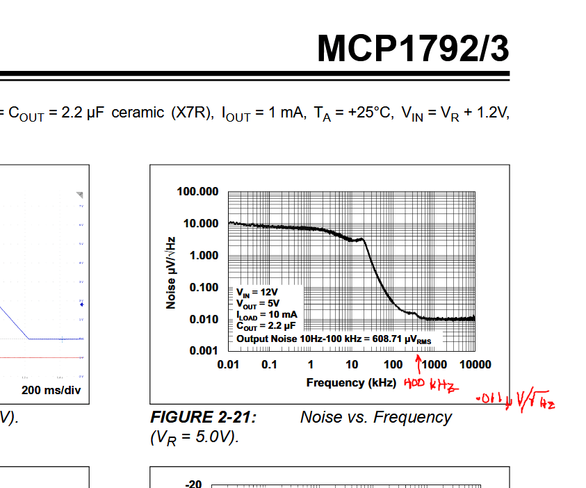

It's going on the out of a 400KHz switcher. Per spec sheet it should be .10 uV/sqr(Hz)
sqrt(400000)*.01 is only about 6.32uV rms.
PSRR also peaks at 400kHz at about -45dB for 5vO. But if we calculate PSRR as log20 (4.4mV /Ripple Out) = 45dB we're looking at 24 uV ripple or ~178x attenuation. Somewhere around there. (10^ (45/20)) =~ 177.8X ripple attenuation.
It doesn't seem especially noisy considering it's dropping 26ish V to 5V. Even going TI and running 6V - 5V you only gain 20dB PSRR headroom. The Analog ADP7142 has a 20dB PSRR gain over the MCP and actually looks to have less noise and incorporates the -20dB PSRR gain of the TI part. Just for biasing the switcher the noise really doesn't seem that bad at all.

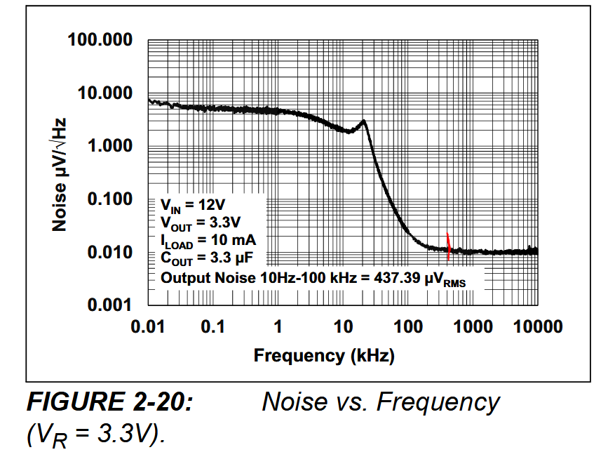

MCP1793 has a typical output noise of its own of 608 uV @5V output. That is 15 times more than an Onsemi 7805.

Not a real issue with the MCP. Could replace them, but need to know what do you want, I hate continuous changes.

Datasheet of LT8648 is IMO not very clear about the bias pin 1:
"BIAS (Pin 1): The internal regulator will draw current from BIAS instead of VIN when BIAS is tied to a voltage higher than 3.1V. For output voltages of 3.3V to 25V this pin should be tied to VOUT. If this pin is tied to a supply other than VOUT use a 1μF local bypass capacitor on this pin. If no supply is available, tie to GND. However, especially for high input or high frequency applications, BIAS should be tied to output or an external supply of 3.3V or above."
Well what is it, Linear Technology? 🙂
BTW no opinion on TI Post Filter FeedBack PFFB TPA3255 solution as I never used that chip or a product with it.
My reading of the datasheet just says "for HF or high input applications, do not tie to ground" since they list ground as an option earlier. I still think the MCP would be fine.

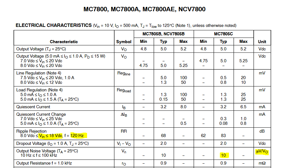

L7805 are OOS at Mouser and Digikey with an ETA of 2023 at the earliest. NCV and MC7800 series are available but they measure worse on noise except for PSRR which is already very low.
L7805 is also noisier than the MCP at 400KHz.
OnSemi provides no actual measurement graphs that show anything beyond an idealized mathematical function to make a pretty curve. For the 400KHz application the MCP is superior. The STMicro, TI, and OnSemi datasheets for 7805__ products could literally be the same document. All with nonsense "measurements" which are just identical to the limited information they provide above with no real tools to extrapolate noise levels beyond the shown 100kHz.
The tables at the top of the datasheet are trumped by actual measurements provided further down in the Microchip documentation. Most of the datasheets only show up to 10kHz but that is not where @JPS64 has set the operating point.

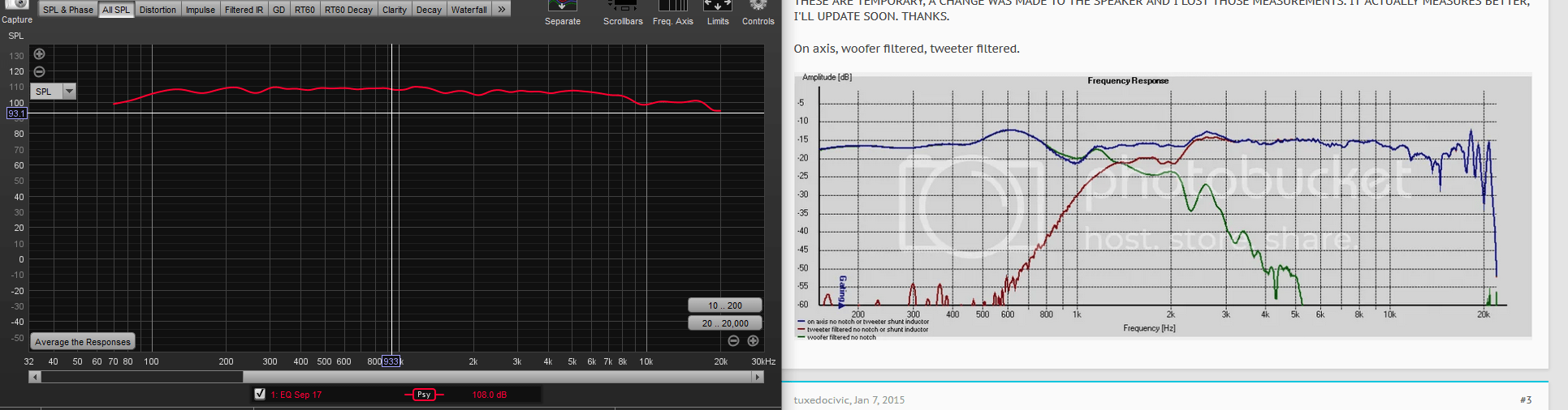

Here is a DIYSG Fusion 10 Pure as measured by the designer (tuxedocivc) versus the exact same speaker built by an amateur (me 10 years ago, still pursuing an ME degree) but with active DSP XOver. There is just no comparison. But to take advantage of DSP, you need to build to the most demanding channel in the physical speaker coupled with gain staging losses (no adjustable gain outside of 2 profiles to select on the MA12070) so a clean 20W isn't really a clean 20W compared to higher potential (read: voltage potential) amps because the MA12070 will drop the Vpp way low (1.8Vpp max, aka .6XX Vrms). In theory, 13W at 8 Ohms should be plenty to be uncomfortable, but I am not the only person to say "it depends." My 12Wpc EL84 amp feels like it has a bit more grunt than my PBTL MA12070 amps. By every measure the MA12070 should get louder; faster... but it just doesn't.
Analog vs DSP XOver as applied to DIYSG Fusion 10 Pure. The DSP XOver is also able to go 200+Hz lower than the passive XOver (1.2kHz compared to passive @ 1450Hz). Bi-Amping allows more usable range from the CD+Waveguide with its own dedicated channel.
