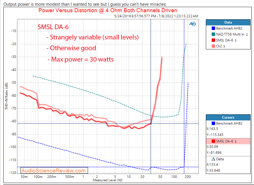

@JPS64 you laid out the Symlph and it measures very well on ASR https://www.audiosciencereview.com/...ics-sylph-d200-amplifier-module-review.25295/

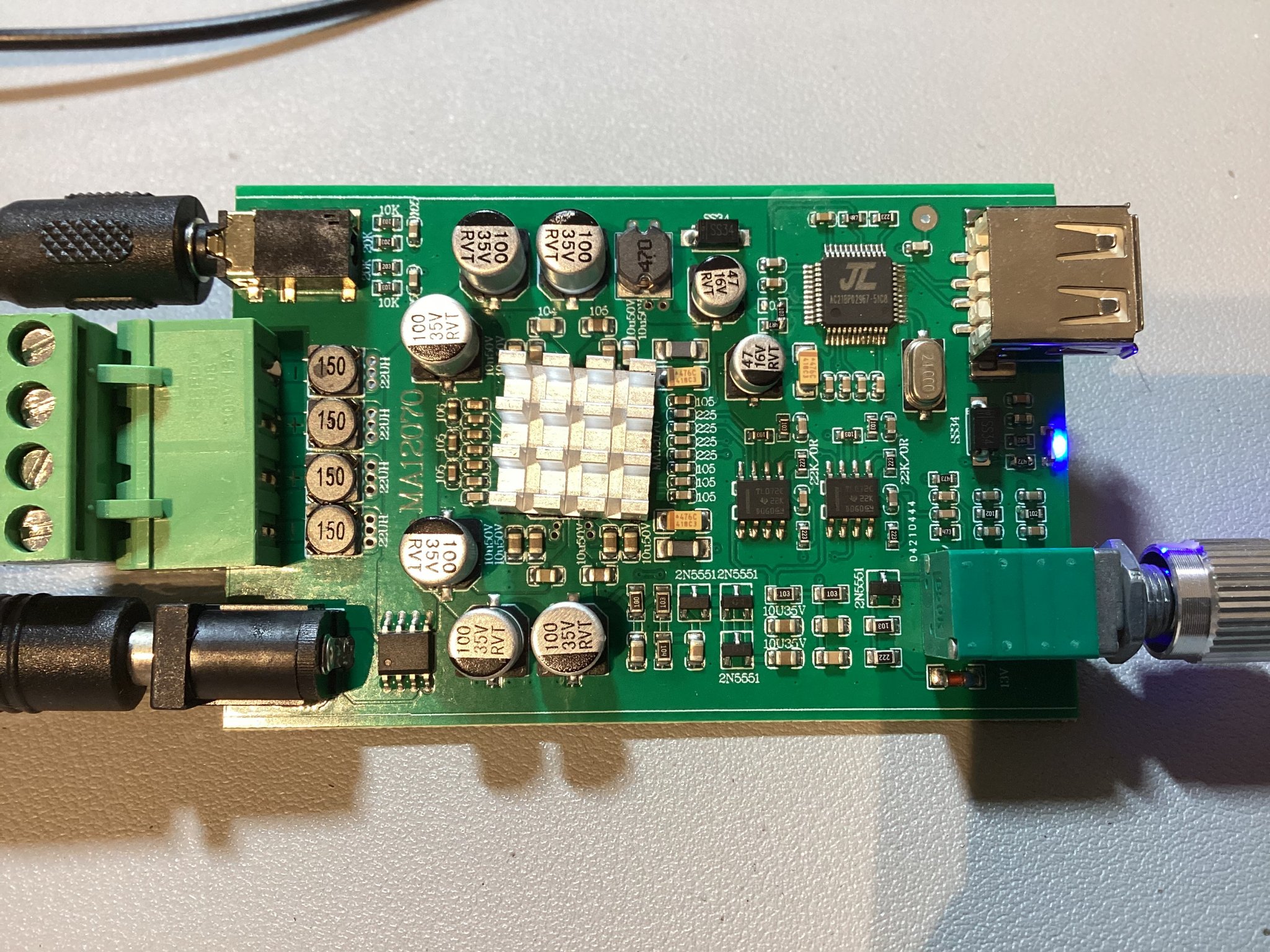

Just got these.
The cheapest i could find(€20 with shipping)
It plays right out of the package.
No noise or hum.
I will make some baseline measurements before i start to modify.
It has line in, bluetooth in and USB in autoselect.
2 channel.
TL072 input buffers.
Switching 5v supply.

Incredible price for what you get. But.. how does it sound?!
Small coils and is that a 4 gang potentiometer!?

No,it is a stereo pot with on/off switch.Incredible price for what you get. But.. how does it sound?!

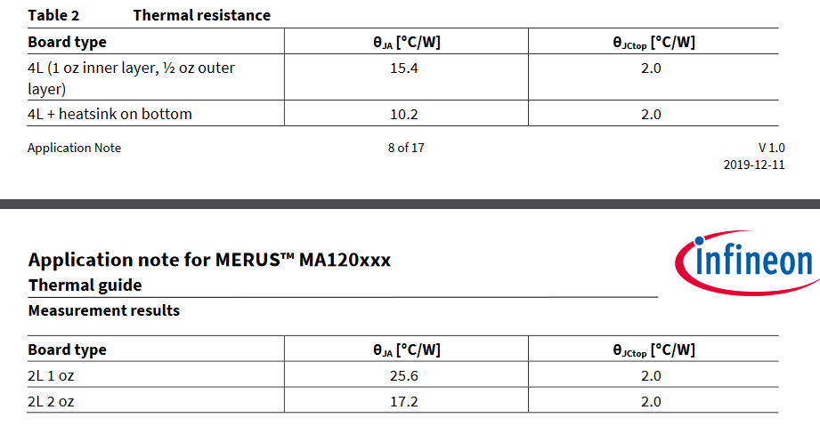

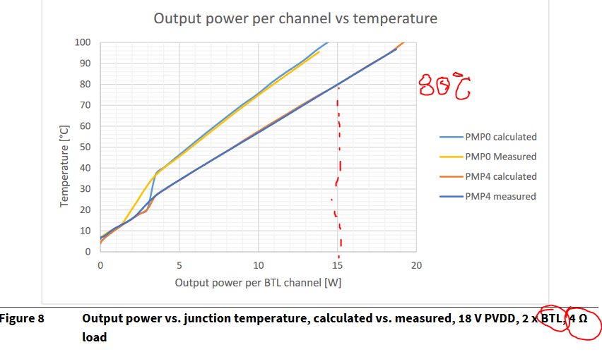

THe current handling capability will just depend on the dielectric substrate and transistor design baked into the chip itself. I think the only way to coax more power out of the MA12070 would be some sort of sub-ambient cooling, so I think @Koifarm's plans to go PBTL and higher voltage will probably get him a few more watts than the 20W tube amp. Maybe liquid cooling would get a few more watts out of the chip since Infineon shows it at saturation being 125C?

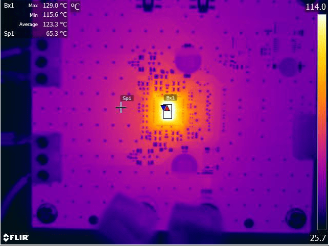

But ASR tests show ~15WPC into 4-Ohms before distortion skyrockets which maps to ~80C on Infineon's application notes.
So liquid cooling might allow more headroom with power. In theory that barrier should be stronger at lower temperatures in every silicon structure. Infineon shows a fairly high thermal resistance in every configuration but a decent waterblock with very good EPAD contact (assuming the chip is well bonded to the same epads) should achieve under 1*C/W. A single 120mm PC radiator with fan could likely cool 2-4 chips assuming the pump used could achieve the required head pressure.

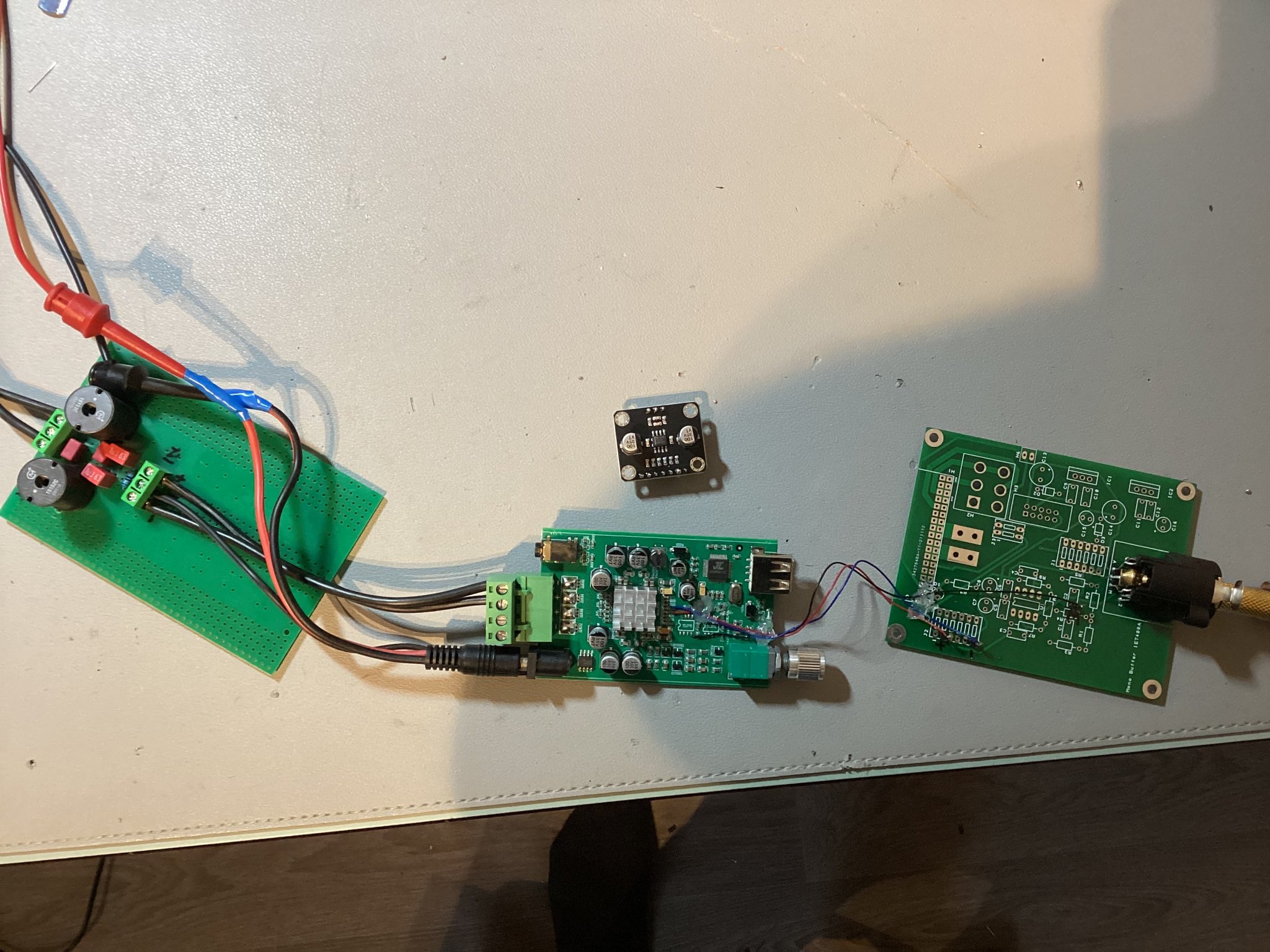

I like the changes i did today🙂
Today did the Pbtl mono mod and removed the TL072. Further i used/build my own output filter.
Used 24V , no problem with 5v onboard supply. I can substantial drive my dynaudio loudspeakers louder.
Filter change giver better bass control but also the mids/hights are more in balance.
Removing the TL072 and drive the MA12070 Gives less distorsion and noise. But when i used unbalanced setup the noise get ups(10 a 15db). Also when nothing is connected the input pickup a lot of noise.
Next i will use opa1632 input board(€ 3,-) and try to remove the input capacitors with the vcom correction of the opa1632.
Then i will change chargingcaps and when still in use inputcaps.
After that it is time for modify the 5V supply.

Today i used the opa1632 on the input. This is a lot better. No noise when no cable connected. No noise(<-100db) whit balanced input, still a little more noise( -88db) with RCA input. Also tried Lundahl LL1521 input trafo but this gave a lot of noise/static.
Tried also to remove the inputcapacitors(2u2) by using Cref(MA12070) and Vcom(OPA1632), but these are not compatible. Just a pumping amp.
The idea was to get DC on output OPA1632 on same level as DC input MA12070.
