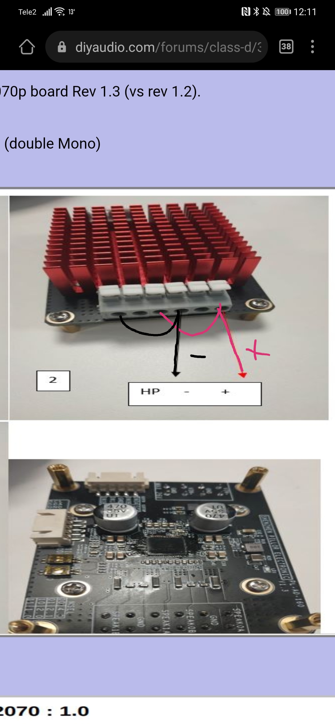

I received the new version of Audiophonics MA12070p board Rev 1.3 (vs rev 1.2).
The new version has a few speakers connectors...
Can you help me to setup the board in Mono mode (double Mono)
what is the correct picture 1 or 2 or 3 ?
Version 1.2

In mono configuration you have to connect wires in the same way as pictured in the last page of the document https://www.audiophonics.fr/fr/index.php?controller=attachment&id_attachment=1409 i.e.:
input:
IN0A and IN0B - for the left channel of the mono amp
IN1A and IN1B - for the right channel of the mono amp
output for both amps:
OUT1A => OUT0A => Speaker +
OUT1B => OUT0B => Speaker -
input:
Sorry, not correct in input:
IN0A and IN0B - for the right channel of the mono amp
It must use 0 inputs as the main ones.
