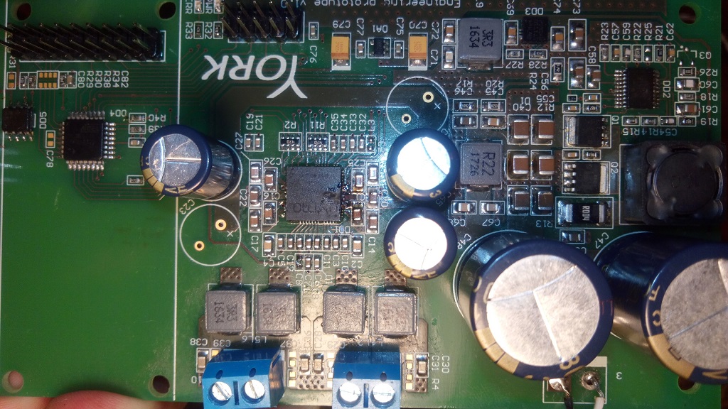

This is MA12070P, with the I2S interface. Later I did another revision of PCB with Schottky diodes added to protect the IC from overstressing (you can see results on the photo attached).
The sound was good thou, I still have a couple of PCBs and IC's to play with. However, I did not compare it with my TAS5548+TAS5162 amp.

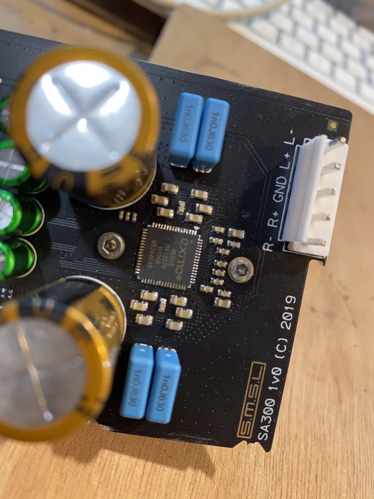

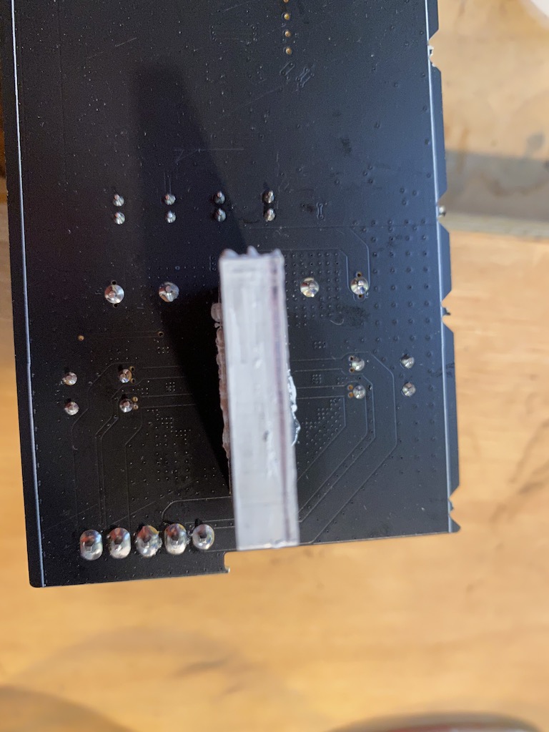

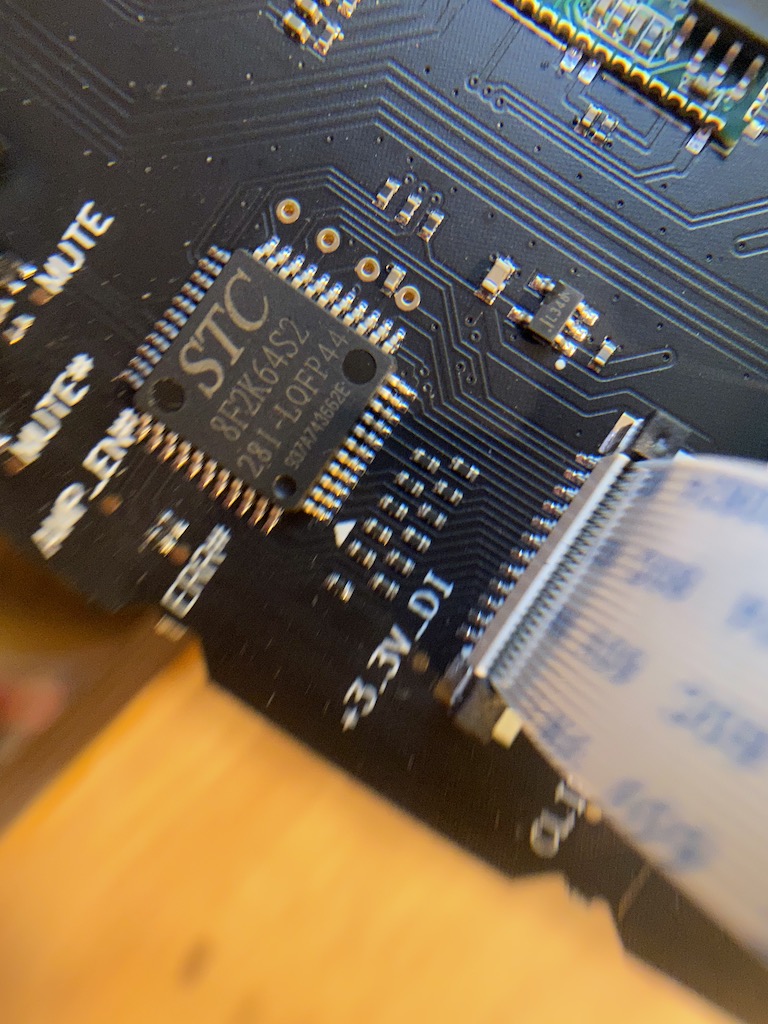

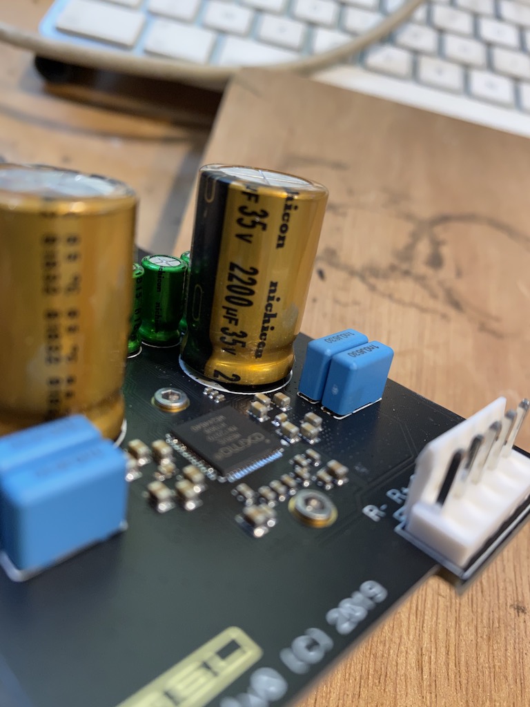

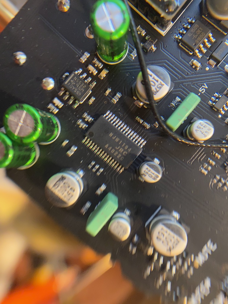

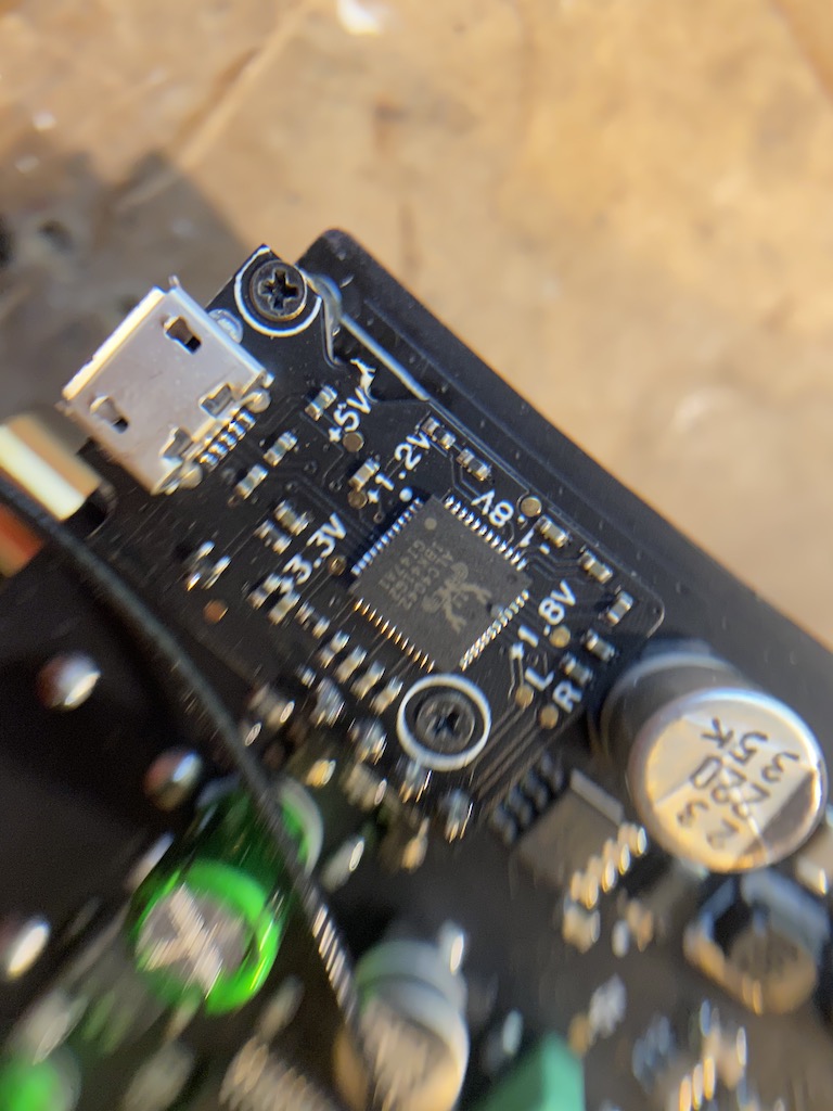

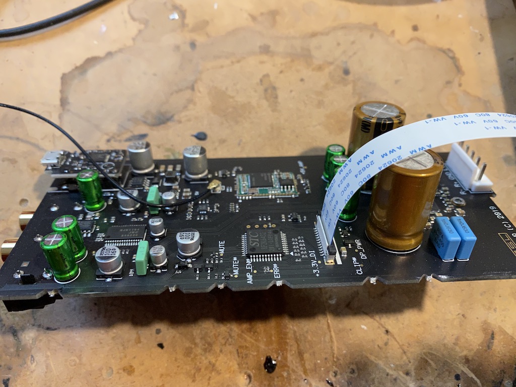

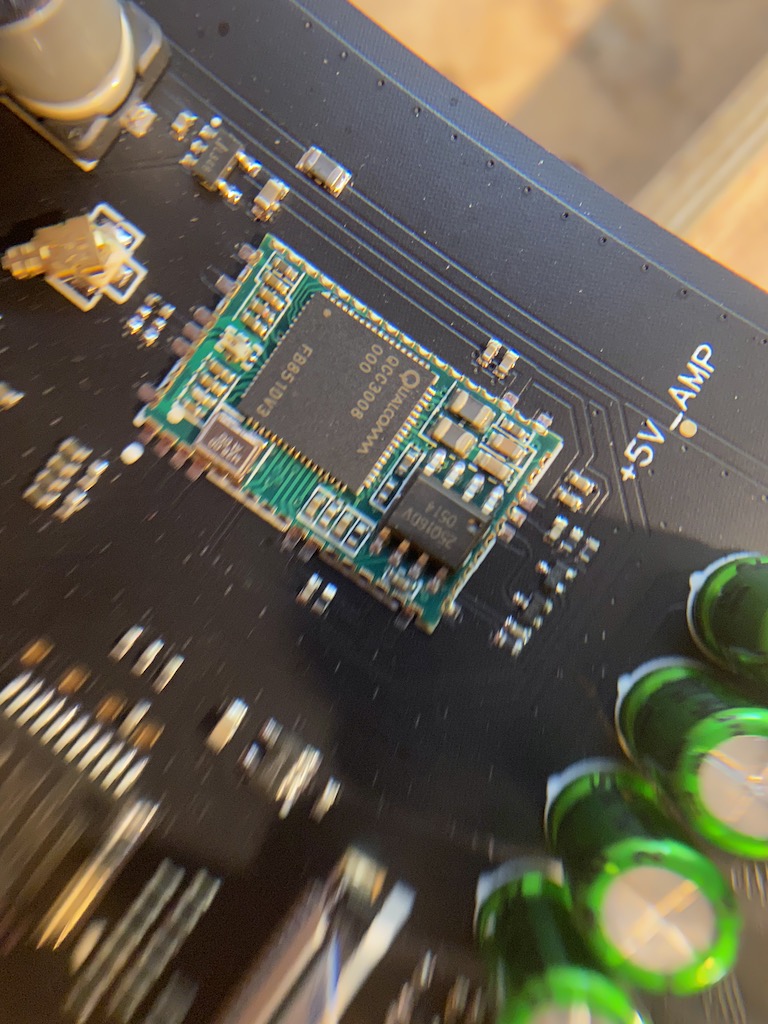

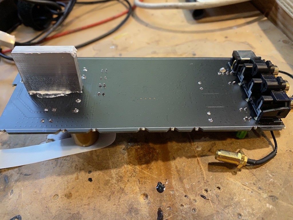

Someone took his SMSL SA300 apart.

Hi All - SMSL did some very good design choosis when they build the SA300 - use the analog input version of MA12070 to get the best output noise level.

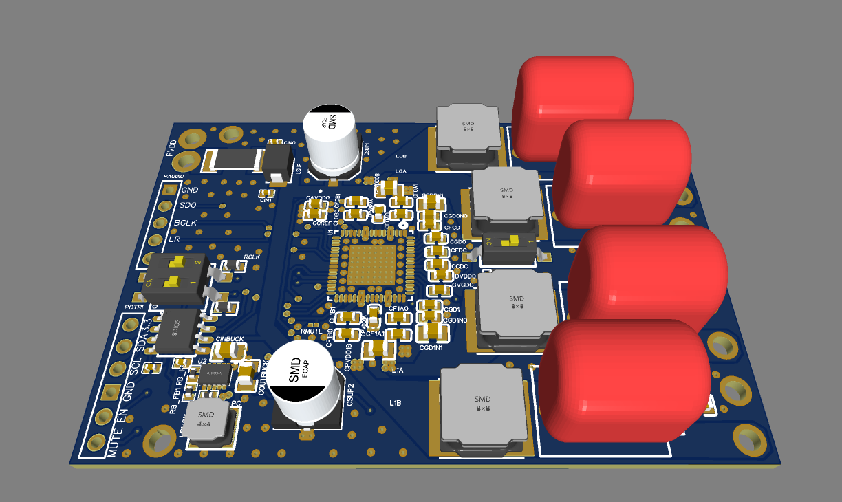

Here is my version of PCB based on Infineon Demo board. It's for MA12070p, amplifier with I2S input. I changed ferrite filters to LC ones because of manufacturer recommendations and placed two switches in order to change I2C address and change mono/stereo mode. Its dimensions is: 68x45mm (2.7x1.8inch). Any feedback aappreciated. This is my first experience with PCB. Thanks!

Looks very nice and with a real output filter. What is the value and current rating (before saturation) of the SMD output filter chokes?
