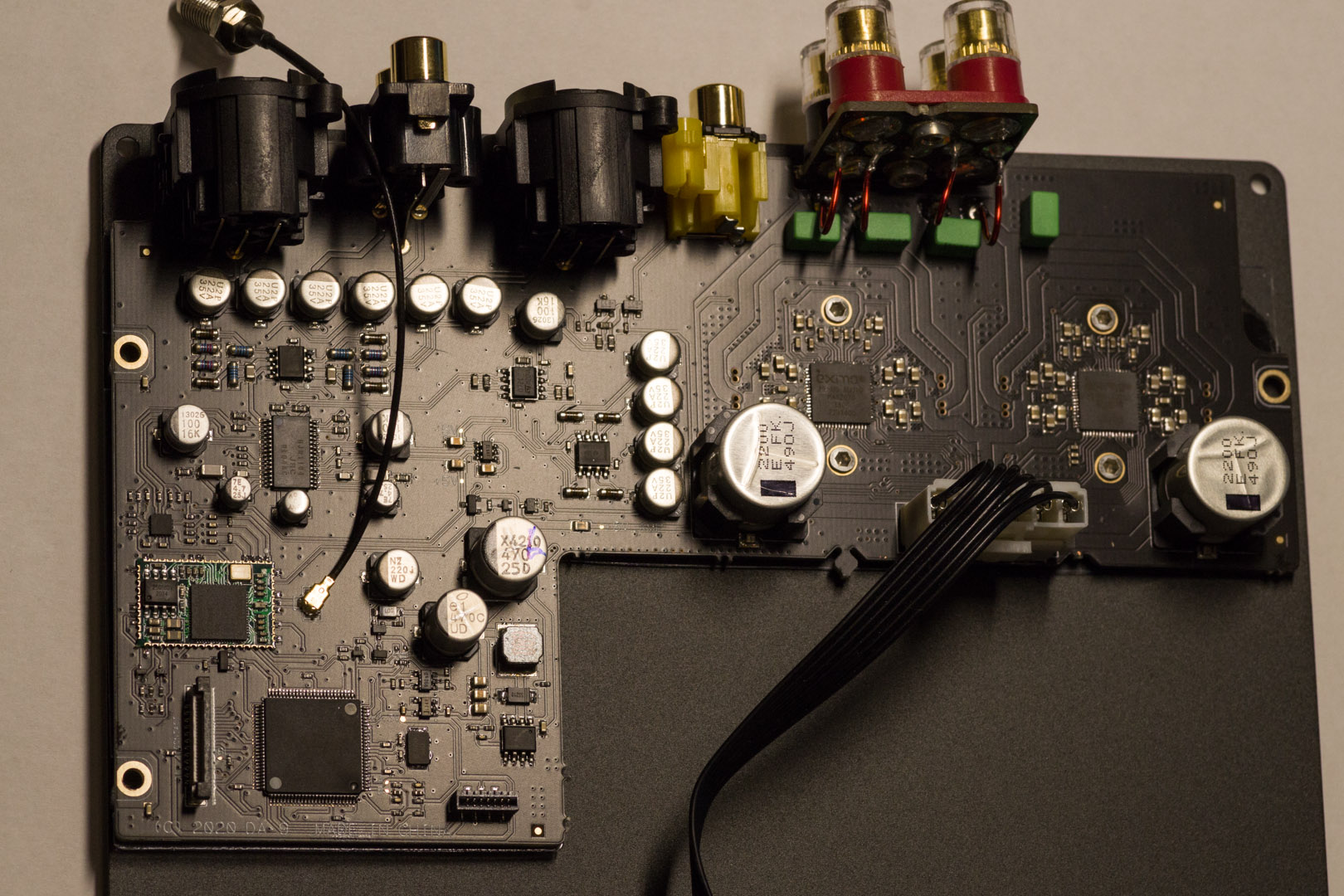

In case you are interested, I found a very interesting document in the internet, showing the internal of the SOUNDBOKS 3 (which is MA12070P based).
Seems they're using standard BTL mode and one of the four channels unused.
https://fccid.io/2AJAASB3/Internal-Photos/Internal-Photos-4455704.pdf
