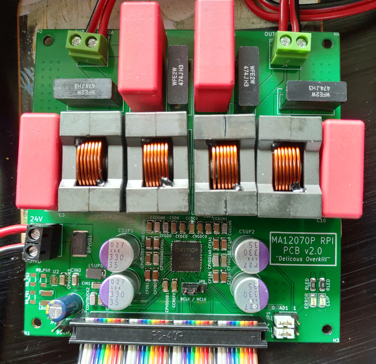

Here is version 2 of my ma12070p PCB. Same circuit, just went for complete overkill components, mostly in the output filter. I made room for the big Coilcraft VER29xx series inductors. I sprung for 2oz copper pour on the PCB too.
I'm starting to doubt my ability to solder these tiny SMD components (i.e. the ma12070p chip) using the stovetop skillet method. The picture is actually my third try at soldering this. The first two had visible solder bridges on the ma12070p chip pins. I tried to clean them up with braided solder wick, but couldn't make them work. I feel like I got lucky on the version 1 board, it just worked without any cleanup. I'm thinking I might just have the fab house do the SMD soldering for me in the future.
Anyway. Another interesting observation: earlier in the thread, I was using Infineon's reference board (the tiny PCB, barely bigger than a postage stamp), and remarked that with some speakers, the board itself made a hissing sound. That happened initially with my v2 board too. But that was because I did the initial test without the output filter (I just soldered a wire where the big inductors go). But once I populated the LRC output filter, the hissing stopped.
Nice work Matt Garman! Try skillet from bottom and hot air pencil from top. Get ENIG finish and don’t use too much paste. Apply paste with 22gauge “Henna” blue plastic taper nozzle for precise paste lay down. Use low temp (150C) no lead paste.
Skillet heat only to ~125C. Let hot air pencil at 350C melt paste locally.
Use expensive ($6/roll) fine mesh copper braid with thin water like liquid flux on braid to clean pins after. They should look clean and uniform. Use fat chisel tip iron on braid.

Thanks, X! I saw your similar suggestions in the tpa3250 thread as well.
I think I will invest in a hot air pencil and try your method. The taper nozzle will be a big win as well, thus far I've just used a toothpick to spread solder paste!
Question: have you (or anyone else) used this method for soldering "thermal pad down" chips like the ma12070(p), tpa3250, tpa3118, etc? I.e., ICs that are designed to use the PCB as a heatsink? Is it safe to assume that if the hot plate bottom + hot air flow on top is enough to melt the chip pin solder, that it also melted the thermal pad solder?
Edit: I know your tpa3255 board uses the big Coilcraft SER-style inductors, basically the flat, SMD version of what I used above. Were you able to easily solder those as well using the your hotplate bottom + hot air top method? I've soldered those before with a regular soldering iron, and it's a challenge, those inductors absorb so much heat. The VER-style that I used are nice for space-savings and being through-hole. But the SER-style are cheaper, and also other manufacturers make inductors with the SER-style footprint, another win for price and availability.
Yes, the hotplate on the bottom and hot air pencil on top lets me solder thermal pads to vias very effectively. I have done LME49724 this way, as well as OPA1622 in VSON10's, many tiny MOSFETs, the CoilCraft SER's, some Murata SMT DC/DC converters, and even a large DSP chip. The most difficult things to solder with just hot air or just hot plate are large SMT electrolytic caps. The hot air alone melts the plastic base before heating the pads on the bottom. So both bottom hot plate and top hot air is useful. They make hot air rework stations where hot temp stabilized air is blown from bottom so that it allows double sided boards to be reworked. I have not found a need for that yet.
Does anyone know what it means when both the ERROR and CLIP lines go low on the ma12070p? I attempted to finalize my v2 build: swap out power supply and actually bolt everything to the chassis. No changes to the actual ma12070p board (other than the physical mounting). Now, at power on, both ERROR and CLIP lights turn on. I cannot talk to the board via I2C.
I put my v1 board in its place, it works fine. So it appears I must have some how damaged the v2 board while doing the mechanical work. But since I can't even talk to it via I2C, I have no idea what is wrong. The datasheet doesn't seem to give any hint as to what the problem might be.
I checked 5v and 24v supplies, they look OK (about 5.16v and 23.3v, respectively).
Any thoughts?
