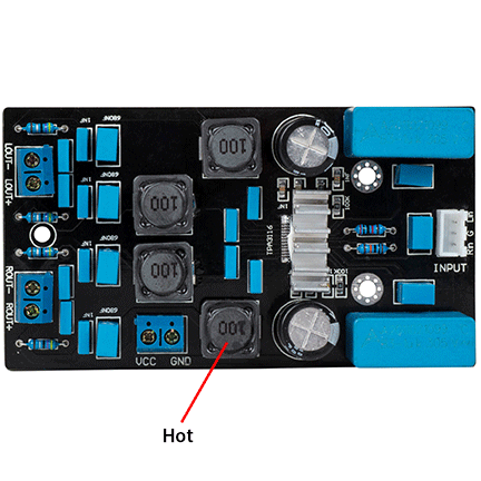

Inductors too hot to touch on YJ 3116
I have the 3116 YJ Danz board V2 - cheapie from China. I used the same one before for a streaming device with Raspberry Pi without issue.
This one has a slighter higher voltage SMPS - the Meanwell PPS 125 -24.
I'm sure the board should handle 24V. I connected it last night to a 4R Sub woofer and played with it for half hour. I noticed it was very hot afterwards.
So tonight I thought I would just idle it with nothing connected (Input or Output) - Just the 24V power supply.
The inductor on the right channel closest to the chip got too hot to touch within minutes. The heatsink of the chip followed even though I could hold my finger on it for an amount of time - it was incredibly hot.
I also did the mods as per the wiki here, including the bootstraps - could this have caused the problem?
Stu
OK, have attached a pic showing the inductor that is hot. I was planning on possibly putting this board into PBTL anyway so I figure now is worth a try seeing as something is up with the board.
Could someone explain to me which channels the inductors serve? Or better still a simple explanation of which side I should be putting this board into PBTL if I don't want this inductor that gets hot to be used.
I just don't quite understand how PBTL mode gets routed through the chip and out through the various filters
stu

Can anyone confirm the statement from theaspin. I would have thought only two inductors would be used as HF filters in PBTL mode?
Another member says "PBTL is parallel bridge tied load and uses both left and right circuits as one (only 2 inductors) in mono"

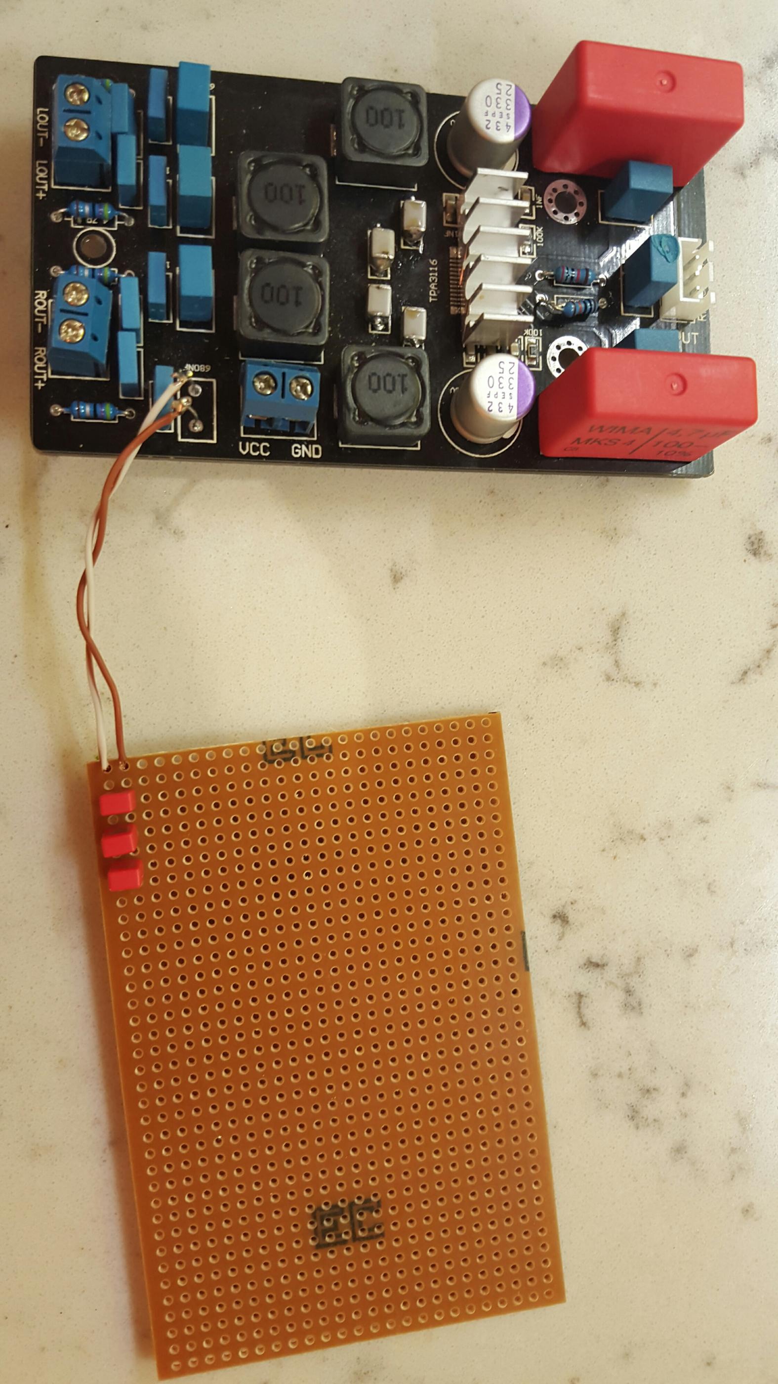

Feeling quite pleased with myself, sure I won’t make any impressions round this forum but thought I’d share my findings and solution.
I have two boards so I decided to do the old logical comparison tests to find why my inductor was too hot to touch. Firstly I did continuity tests all over each board and everything seemed fine. Then I set the DVM to capacitance mode and discovered I could read 680nF on all caps in all output filters except the one with the suspect inductor. This cap couldn’t even get a read on my meter.
So I removed it, and found the marking 22nk400 on it. Wow, my board had totally the wrong component here. 22nF, the rest are 680nF which is what TI recommend.
I had some 220nF caps lying around so I paralleled 3 of these up to make 660nF and ….
No more over heating inductor!
I have read about people receiving the wrong gain resistors, hope this may help anyone troubleshooting these cheap Chinese boards.
Thanks again to everyone here, and thanks theaspin for clearing PBTL query up. Next step is to do the simple version of the PBTL mod and research a better filter for my sub bass amp.
Will be using my 4oHm 10 inch sub driver for a while, but soon I will be seeking out a 2oHm 10 inch driver….
Stu
