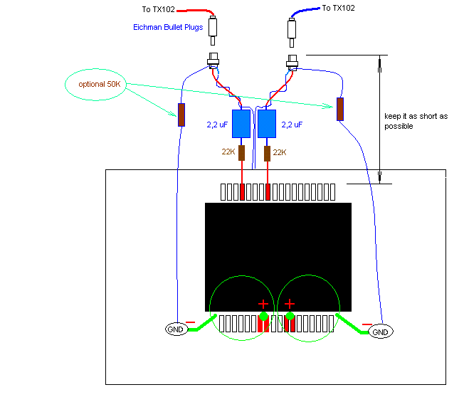

I've gone through the technical notes for the TA2024, especially the schematic for the TA2024 mini, if we are to connect the 12v+ directly to the positive pins of the the 2 electrolytics, I'm just wondering if by doing so, will both VDDA (pin 33) and CPUMP (pin 36) be still supplied with the required 12v+? If not, what remedy is needed to feed the 12v+ to these pins? As per the TA2024 mini schematic, VDDA is attached directly to 12v+, while CPUMP is connected to a 1uf cap then to the 12v+ line. Thanks for taking time on this inquiry. 🙂
D0Hbert said:I've gone through the technical notes for the TA2024, especially the schematic for the TA2024 mini, if we are to connect the 12v+ directly to the positive pins of the the 2 electrolytics, I'm just wondering if by doing so, will both VDDA (pin 33) and CPUMP (pin 36) be still supplied with the required 12v+? If not, what remedy is needed to feed the 12v+ to these pins? As per the TA2024 mini schematic, VDDA is attached directly to 12v+, while CPUMP is connected to a 1uf cap then to the 12v+ line. Thanks for taking time on this inquiry. 🙂
Yes, connect the 12V there. There is no need to considering the schematics / datasheets because unless you start cutting traces, you are not altering the fact that all subcircuits that had 12V were still common to each other. You could literally connect your 12V supply _anywhere_ you measured 12V previously and it'd work fine- but it'll work even better (at least theoretically moreso than in practice) if you use a short lead from power supply and connect it inbween those two electrolytics as posted in the prior picture.

Thanks Dohbeert, this makes sense 🙂

optimum ground?
Hi @If and everyone else!
I'm playing around with the optimum ground points for the inputs and wondered which/where is best?
The post shows a connection to the output ground as an option, is this a good idea?
What have other people done?
Cheers
Lee
