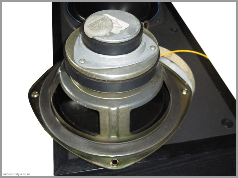

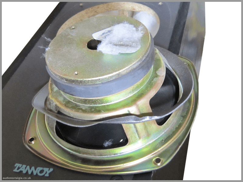

looks like same old stamp driver.
One has a tweet a doo , the other just has cap over the coil.
can see the unused mounting holes and hole in magnet for coaxial.
crossover mounted to jack plate.
pretty smart and straight forward stuff.
