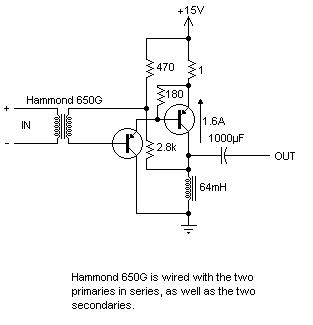

I feel this area of solid state is not very popular so I've built something to try it out.
The concept is for a single ended, single stage, no-feedback, inductively coupled class A power amplifier. Inductive loading gives a welcome rise in efficiency above the theoretical 25% limit to a new theoretical 50% limit. In reality 35 - 40% is a reasonable limit.
The frequency response of such an amplifier is limited in the high end by the transistor and surrounding circuitry, while the low end is limited by the inductance of the inductor and surrounding circuitry to a lesser extent unless coupling capacitors are in use.
My prototype is a monoblock using Germanium transistors, just to put an interesting spin on things. I used the 2N2080 doorknob style transistor from Motorola. At a minimum 5kHz fT, this is a wonderfully slow transistor.
I've chosen a 64mH choke to give a rolloff of 20Hz on the bottom end for 8ohm drivers. The output is capacitively coupled to the speaker.
Shown is a schematic of the actual operating prototype. The 64mH inductor and 1000µF cap should give a LF rolloff near 20Hz at 12dB/oct (LC filter).
Impressions so far are that this sounds pretty good, as bad as it really looks.

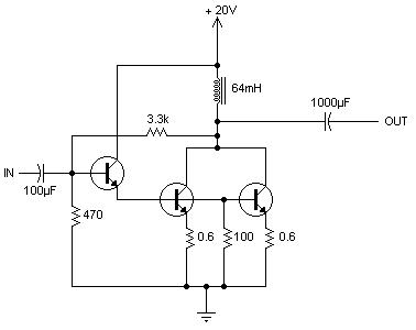

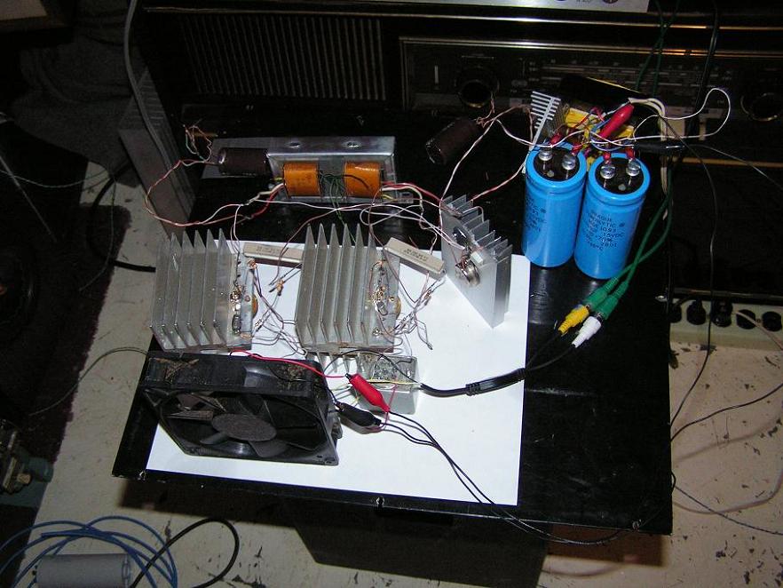

Here I have made another version of the circuit mentioned at the beginning of this thread. Instead of Germanium the transistors are all Silicon.
This uprated version is set up for 20W output power and uses NPN instead of PNP, so far it works well and sounds pretty good.

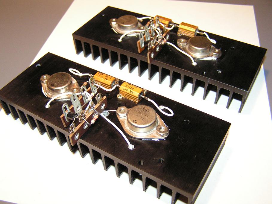

Daniel,
Come on show them the pic of the original stereo pair...
this thing was not without its rough edges but it sounded pretty good and had potential... since Daniel has been raiding the parts bin for more & better bits, i see that they now have the OPTs from my dedicated tweeter amp in them.
