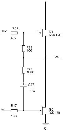

The most common type of indirect feedback circuit used in integrated circuits is the current mirror. You can regard a current mirror as a current amplifier with indirect feedback, as a circuit using compensation, as a circuit using predistortion or as a rather simple translinear loop. No matter how you look at it, it works.
Indirect voltage feedback is sometimes used for instrumentation amplifiers. Apply the input signal to one differential pair and the (attenuated) output signal to a matching differential pair, and add a loop amplifier that nulls the difference between the output signals of the differential pairs. I've used this once for a discrete audio circuit, see the attachment (symmetrical unity gain buffer that can be used for converting differential signals to single-ended and vice versa).
Alex's circuit is similar to the indirect voltage feedback instrumentation amplifier, except that he has replaced the differential pairs with JFET's and the loop amplifier with a wire. That is, the JFET's themselves are to produce enough loop gain.
That is exactly what I was looking for to illustrate the idea of indirect feedback - and couldn't find in my archive. The circuit in your attachment is very similar to the internals of some fully differential amplifiers from Intersil (IIRC) . I should have a datasheet somewhere but couldn't find it! Thank you!
Alex

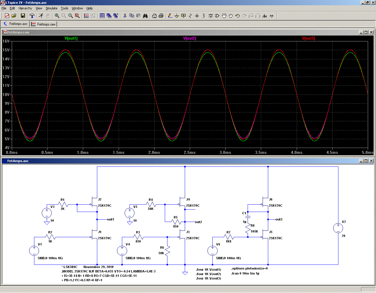

Comparison between three options:
1: Uncorrected
2: So-called "indirect feedback"
3: Plain-vanilla feedback

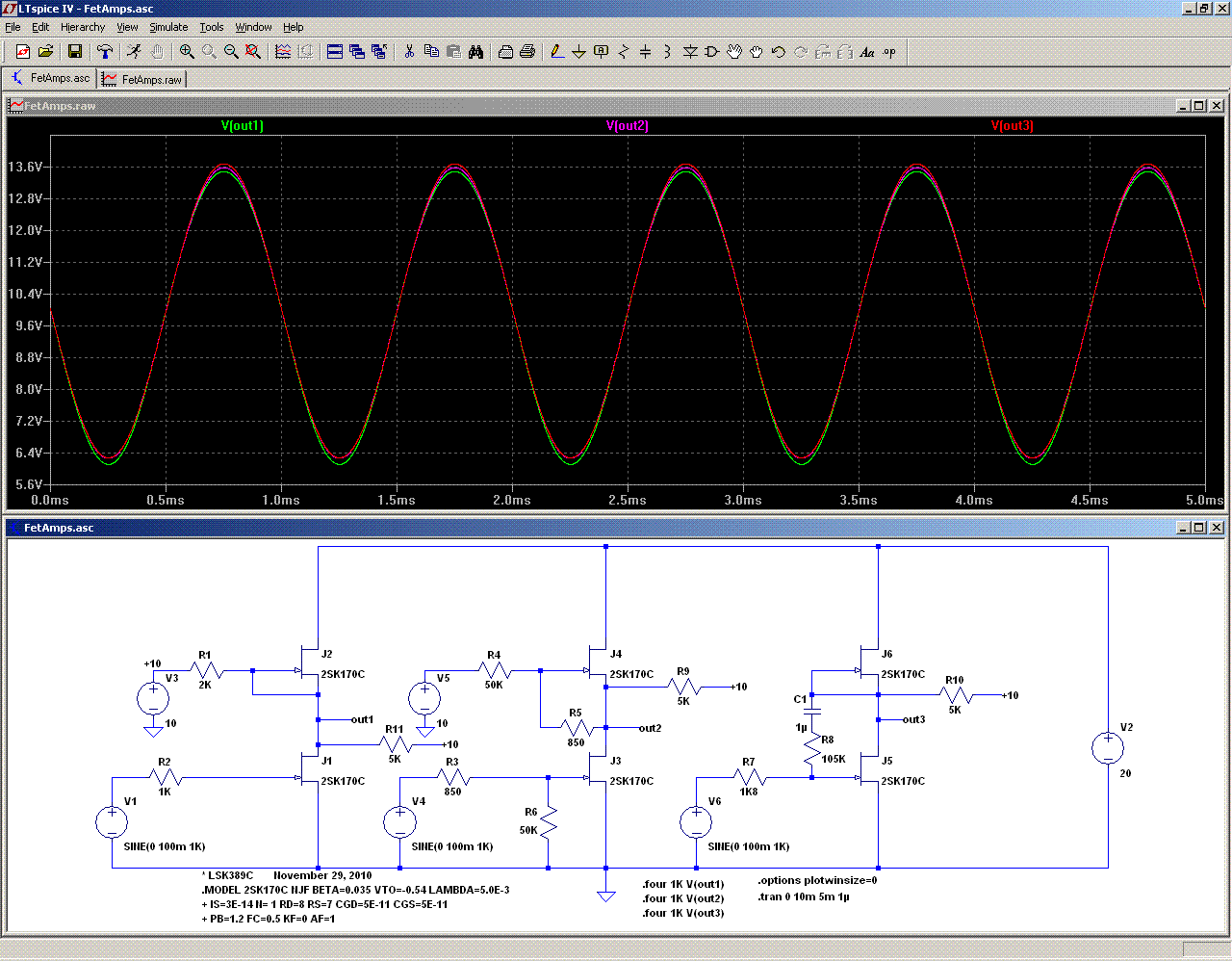

The same with a 5k load:

FET model is from Bob Cordell, so should be OK.
Interestingly, the distortion in #3 is caused by the large junction capacitances of the K170, and reducing the impedance level reduces the distortion further:
As in the example from MarcelvdG, the difference is that with "Indirect feedback" approach you have a high input impedance, but with "Plain-vanilla feedback" you have very low input impedance. I came up with this circuit for a particular reason: to make a single-stage low-gain voltage amplifier with good linearity and high input impedance.

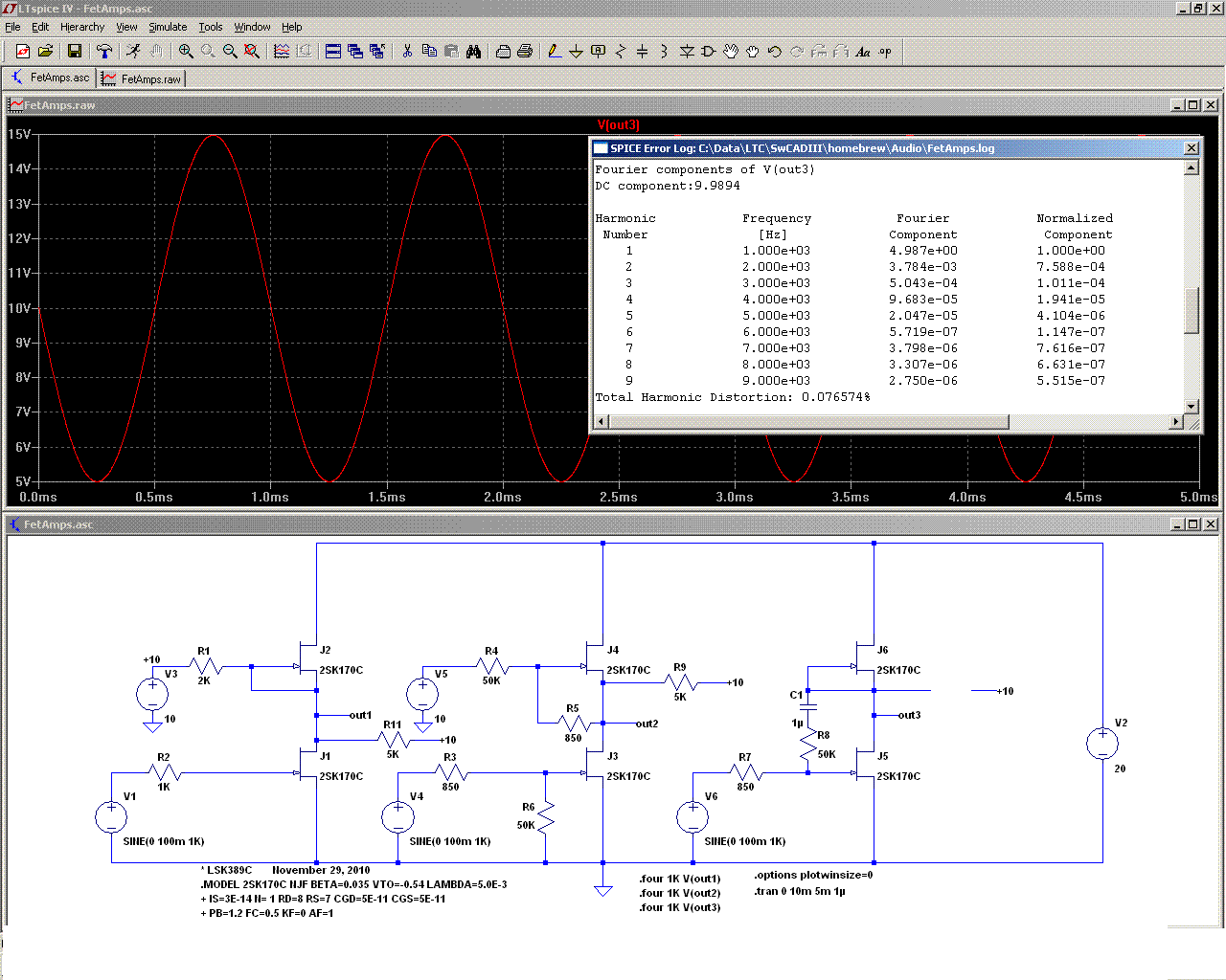

If you compare two circuits: Applying negative feedback to the Nikitin circuit makes it even better, with a distortion less than 0.05%. But then you have a totally different amplifier as pointed out by Alex.
With those values, it isn't the Nikitin circuit anymore, it is regular feedback with a bit of make-up.
The resistance ratio is 4700:1, and if you make it ∞:1, it will make little difference.
Yes it is. But you compared the Nikitin with your no3 circuit which has regular negative feedback. That was my point.
Yes I did.
I did so with "pure" circuits, whereas you attempted to mix the two.
But the schemes are mutually exclusive: both set a defined voltage gain, determined by a resistance ratio.
If you implement them simultaneously, the overall gain will be lower, and the performances will be intermediate: worse than for pure feedback, but better than pure Nikitin.

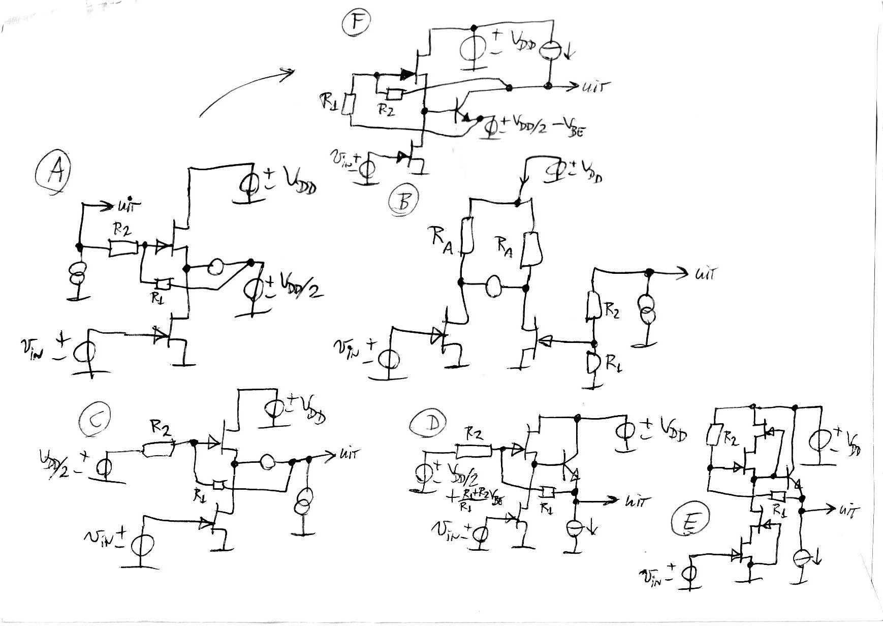

Hi all,
Some of the disadvantages of indirect feedback can be reduced by increasing the loop gain by putting an extra amplifier in the loop. I've been thinking about this and attached are all schemes I could come up with. All ideally have a gain of -(R1+R2)/R1, except version B which has a gain of +(R1+R2)/R1. I haven't drawn the resistors at the input, presumably Alex uses them to match distortion due to (capacitive) gate currents.
Some things you should know to be able to read the schematics:
-The word "uit" is Dutch for "out".
-The single circles with no line inside are nullators, network elements having no voltage across them and no current flowing through them. Basically this is an ideal model for the input stage of a high-gain amplifier in a feedback loop.
-The double circles are norators, network elements that can carry any current and can have any voltage across them. Basically this is an ideal model for the output stage of a high-gain amplifier in a feedback loop.
-Hence, a single circle and a double circle together model a high-gain amplifier.
Schematic A has a high-gain amplifier driving the load and the feedback network. The amplifier is connected such that it makes the drain-source voltages of both FET's equal to VDD/2, thereby eliminating errors due to finite FET voltage gain.
Schematic F is an implementation of A where the high-gain amplifier is a single transistor.
Schematic B is a non-inverting variant.
In schematic C I've swapped the norator and the voltage source compared to schematic A. As a result, you get the errors due to finite FET gain back, but the loop amplifier can be a simple voltage follower. This circuit is close to the original of Alex; use a wire as the voltage follower and you have the circuit of Alex back.
Schematic D is an implementation of schematic C using an emitter follower.
Schematic E is a variant of schematic D having the cascodes that Alex recommended in one of his posts. It also shows that the second voltage source can be disgarded when (R1+R2)/R1 times the VBE of the bipolar transistor is somewhere near half the supply voltage.
One disadvantage that cannot be eliminated is the fact that mismatch between the FET's results in distortion. A difference in pinch-off voltage only creates an offset, but differences in the shapes of the curves result in distortion no matter what.
