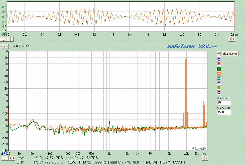

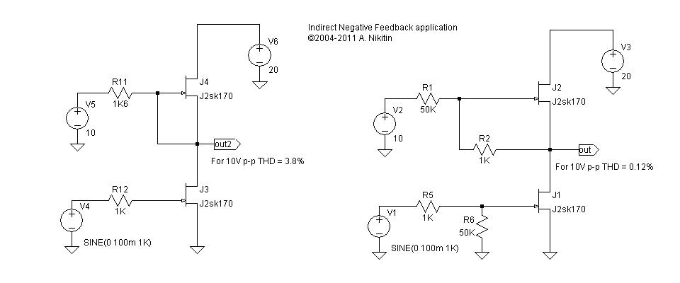

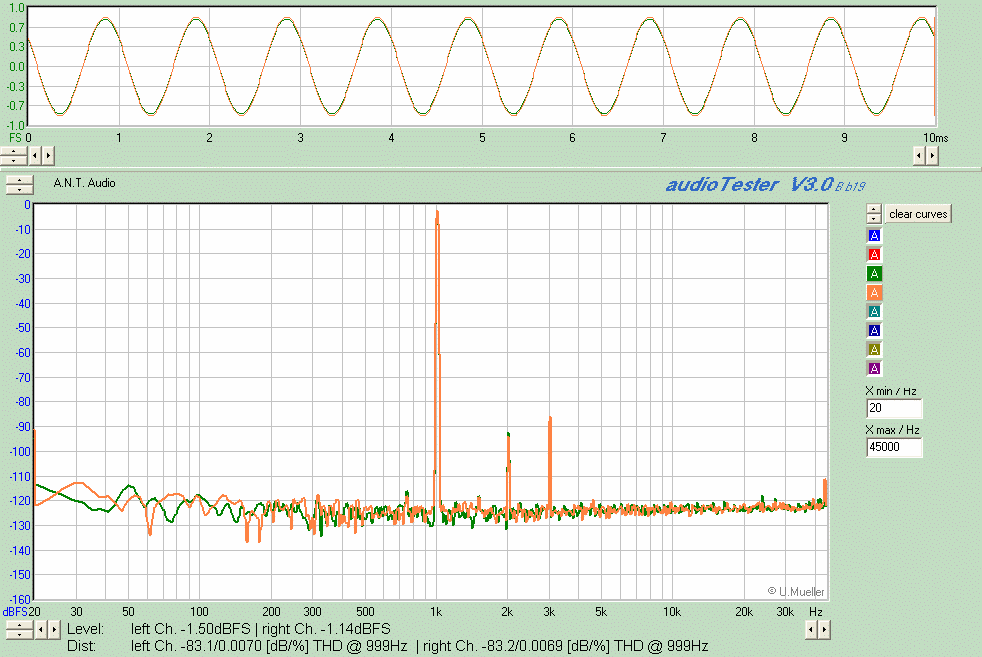

I've uploaded a small article about an old but somewhat forgotten technique of distortion reduction applied to a single-ended FET amplifiers (could be used with valves too).
http://www.ant-audio.co.uk/Theory/Application_of_Indirect_Negative_Feedback.pdf

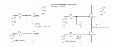

Perhaps Nelson will make another ZEN 😉 ? That approach can be used in many applications. I attach a picture from the article with a (somewhat) simplified circuit.
Cheers
Alex
Cheers
Alex

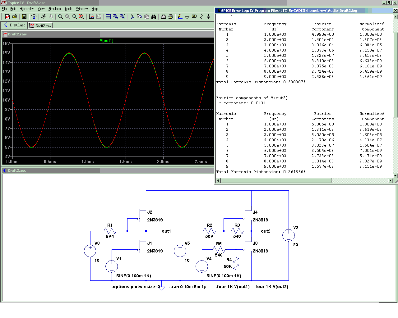

It would be good to see some examples. However with the indirect NFB all distortion components may be reduced, not just the second harmonic.
Cheers
Alex
The effect is so marginal it looks practically worthless.
Are there actual circuits where it would be of some value?
Try it at least with 2SK170 . The FETs you've used have very low gain without the feedback, so the effect is nil.
Cheers
Alex
Cheers
Alex
I guess the criteria are:
voltage gain factor of the FET >> gain with indirect feedback
transconductance of the FET times resistance of the two feedback resistors in series >> gain with indirect feedback
Is that correct?
Is that correct?
Yes, you are absolutely correct.
By the way, I like the circuit. It is a variant of indirect feedback I hadn't seen before.
Thank you! I've designed this circuit about 7 years ago and used it with very good results. I won't give away exact circuits used in my commercial projects, however I can give you some ideas how a well polished circuit of this kind can work - by uploading a couple of graphs with spectrum of the output signal from a preamp built using that idea for the VAS. The gain is 20 dB (x10), the first graph is for the output voltage 1V RMS at 1 kHz, the second - for the output 0.5V RMS at 19+20kHz , both on 5 kOhm load.

Maybe I have missed something, but to me the first circuit looks like it has a drain load consisting of an FET wired as a CCS, in parallel with a 1k6 resistor. The second circuit has a slightly modified CCS in parallel with a 50K resistor. I would expect the first circuit to give high distortion. Nothing to do with indirect negative feedback, just a matter of changing the drain load for a triode-like device. Elvee gets much better results for the first circuit because he uses a much higher resistor value.
The 'explanation' also mentions identical FETs (OK in simulation, but where do you buy them?) and FETs whose drain current is independent of drain-source voltage (same question!). The second circuit might work OK, but not for the claimed reasons.
You did miss something. The modulation of the input JFET drain current is exactly the same for both circuits, so is the gain. If your explanation was right, the gain in the second circuit should be 30 times higher, but it is not 😉 . The trick is that in the second circuit the top FET is not just a current source any more, but rather a non-linear load which compensates for the non-linearity of the input FET. The indirect feedback loop takes care of that, making the resulting voltage transfer characteristic much more linear.
Regarding the second point - for JFETs of the same type the transfer function for the same drain current would be identical enough for a good distortion compensation even when the devices are not matched perfectly (or at all) . The only problem would be a DC offset which would have to be corrected in either circuit by changing the bias voltage on V5 and V2 respectively.
And the third point -- even 2SK170 have enough voltage gain for this circuit to be useful and if required you can cascode two different JFETs in a usual manner - for example, as on the picture attached.
Cheers
Alex
OK, I get it now. The first circuit has a CCS in parallel with 1k6. The second circuit has a modified source follower as load. Sorry.
In fact, the appellation "indirect negative feedback" is misleading, even plain wrong in fact.
The circuit doesn't rely on NFB at all, it works by compensation.
The gain of an uncorrected stage is the ratio of the drain load resistance to the resistance created by 1/gfs, Rd*gfs.
But since gfs is non-linear, the gain and the transfer functions are non-linear.
If we replace the drain load by a similarly non-linear resistance, we can linearize the stage.
What we need is a load whose value is homothetic to 1/gfs, G*1/gfs: this creates a compensated gain=G.
The two resistors associated to the upper FET multiply the gfs by their ratio, and create the compensating impedance.
I see some practical problems though.
For the compensation to operate properly, it must not be disturbed by parasitic impedances => it can only work unloaded.
The 1/gfs multiplication will function with an idealized FET; with a real FET, the compensation will only be effective for G=1. With increasing values of G, the multiplied value will diverge from the optimum.
In fact, the compensation can only be perfect for G>1 if the devices are perfect. But of course, in this case, we can get rid of the compensation altogether, as it is not needed.
That the circuit doesn't rely on feedbak can be demonstrated easily.
Feedback will attenuate distortions, but also perturbating signals.
If a perturbating current is injected at the drain of both circuits, the resulting voltage will be similar. In raw amplitude, at least: in the second circuit, it will be distorted because of the non-linear load, but other than that they will be equal, for an equal gain.
In a stage utilizing feedback, the voltage would be further attenuated by the loop gain.
For given components, NFB would be more effective: the correction is agnostic, not selective and attenuates all non-linear effects, it utilizes the full raw gain available, and it is less sensitive to loading.
But the scheme should appeal to the the no-NFB brigade....
What do it happen when you apply a load ?
The load would reduce the open-loop gain and unbalance the currents, thus increasing the distortion. I usually use a FET follower after that VAS.

In short - the non-linear load is created by a feedback loop, that is why it is an indirect feedback case. That is what this technique is called. Second - the circuit works and works well in real life 😉 . Imagine, for example, this technique applied to the Pearl or the L'Pacific phono stages... . Cheers AlexIn fact, the appellation "indirect negative feedback" is misleading, even plain wrong in fact. The circuit doesn't rely on NFB at all, it works by compensation. The gain of an uncorrected stage is the ratio of the drain load resistance to the resistance created by 1/gfs, Rd*gfs. But since gfs is non-linear, the gain and the transfer functions are non-linear. If we replace the drain load by a similarly non-linear resistance, we can linearize the stage. What we need is a load whose value is homothetic to 1/gfs, G*1/gfs: this creates a compensated gain=G. The two resistors associated to the upper FET multiply the gfs by their ratio, and create the compensating impedance. I see some practical problems though. For the compensation to operate properly, it must not be disturbed by parasitic impedances => it can only work unloaded. The 1/gfs multiplication will function with an idealized FET; with a real FET, the compensation will only be effective for G=1. With increasing values of G, the multiplied value will diverge from the optimum. In fact, the compensation can only be perfect for G>1 if the devices are perfect. But of course, in this case, we can get rid of the compensation altogether, as it is not needed. That the circuit doesn't rely on feedbak can be demonstrated easily. Feedback will attenuate distortions, but also perturbating signals. If a perturbating current is injected at the drain of both circuits, the resulting voltage will be similar. In raw amplitude, at least: in the second circuit, it will be distorted because of the non-linear load, but other than that they will be equal, for an equal gain. In a stage utilizing feedback, the voltage would be further attenuated by the loop gain. For given components, NFB would be more effective: the correction is agnostic, not selective and attenuates all non-linear effects, it utilizes the full raw gain available, and it is less sensitive to loading. But the scheme should appeal to the the no-NFB brigade....
I agree with Elvee that the realisation is difficult when considering the difference between the two FETs. But you can use source degeneration to overcome this problem.
I kind of like the term indirect negative feedback. With R1 and R2 we create a difference in the drain currents between the two FETs. So the current thru R2 is determining how much of the total current is delivered by J2 - the varying current from J1 modulates the current from J2. Clever, I think.
Thank you! Source degeneration is very helpful in this case and I use it in real-life circuits - I've removed the source resistors from the circuit in the article just to make things easier to explain and understand.
